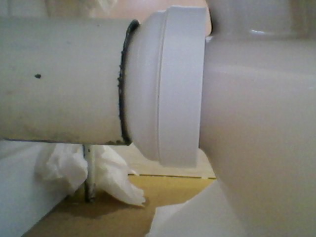

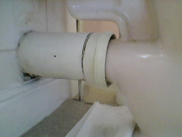

Its started leaking.
From the photo, can anyone tell me if I can get a new connector to fit between the bowl's neck and the soil pipe that passes through the wall?
thanks
full
Looks like it could be straight to me, but either way replaceable.
Yup, trouble you have is that waste pipe is looks virtually horizontal, there is little or no fall, which means some water will always pool in the spigot connector end of the pan connector.
A new pan connector will fix it for a while as it has a new seal. It looks to me like you have a straight connector, hard to tell from the pic though.
Thanks all for posting.
Yes, the neck of the bowl is set lower than the soil pipe so the water has to run uphill.
The existing connector has lasted since '93 so not bad.
So the new one has to be one with a slight offset or one with a flexible seal such as the mac-1 ?
The only way to tell is to pull off the old one and see which one you need , it looks offset but pictures can be deceiving
