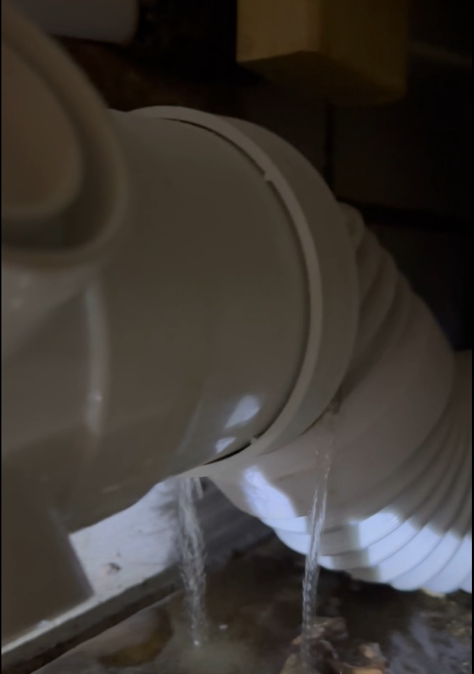

I moved into a new build property just over 2 years ago (so it's out of the builder's warranty). Yesterday, I noticed some brown water stains on the kitchen ceiling directly under the bathroom.
A trace company came round to have a look, and they found the leak coming from the flex pipe connecting the toilet to the soil pipe. It's pouring out all over the ceiling. The inspector said the flex pipe is totally wrong; the sagging in the pipe has caused it to pull away.
Before I go and speak to the developer, does anyone have any thoughts?

Whats to say, a bodged installation, flexi pipe is no good for spanning large distances bad enough over small distances as should be sloped for "free" flowing waste, done for ease and speed of installation by carp developer/builder

Call a plumber, get it fixed, let the wall dry out, have it decorated, don't go throught thre insurance.
