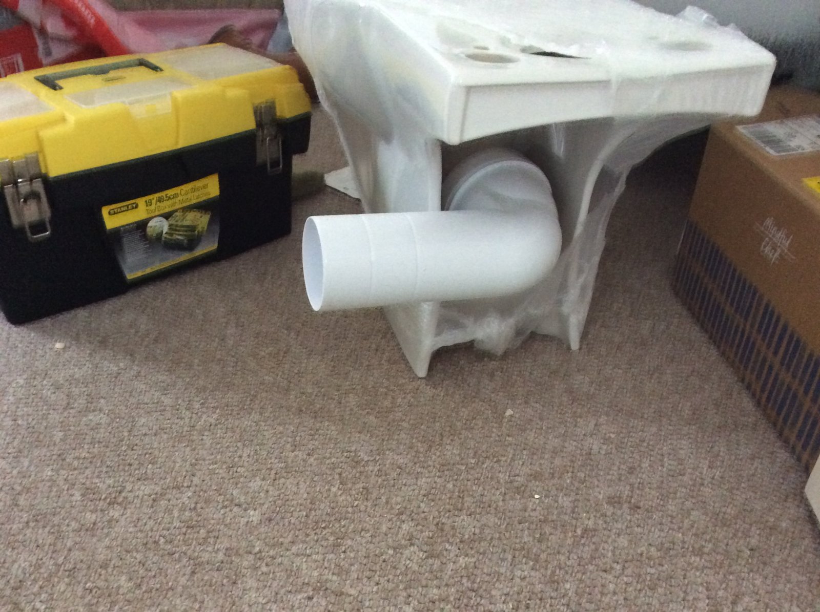

We are having our integrated garage converted into rooms, with one of the rooms being a toilet. The toilet room has one external wall, however the wall that we want the toilet itself backing onto is an internal wall.
The plumber has just told us that we will need to have a toilet that has a side exit. I'm having difficulty finding such a toilet.
Do you get "close coupled" toilets with side exits, or by definition do all those toilets have rear exits?
Any help would be much appreciated.
Ackoman
86D01BB6-A721-4795-991A-A14C779A26B2.jpeg 16DB166D-15E8-43D9-8CE8-B424597D674F.jpeg

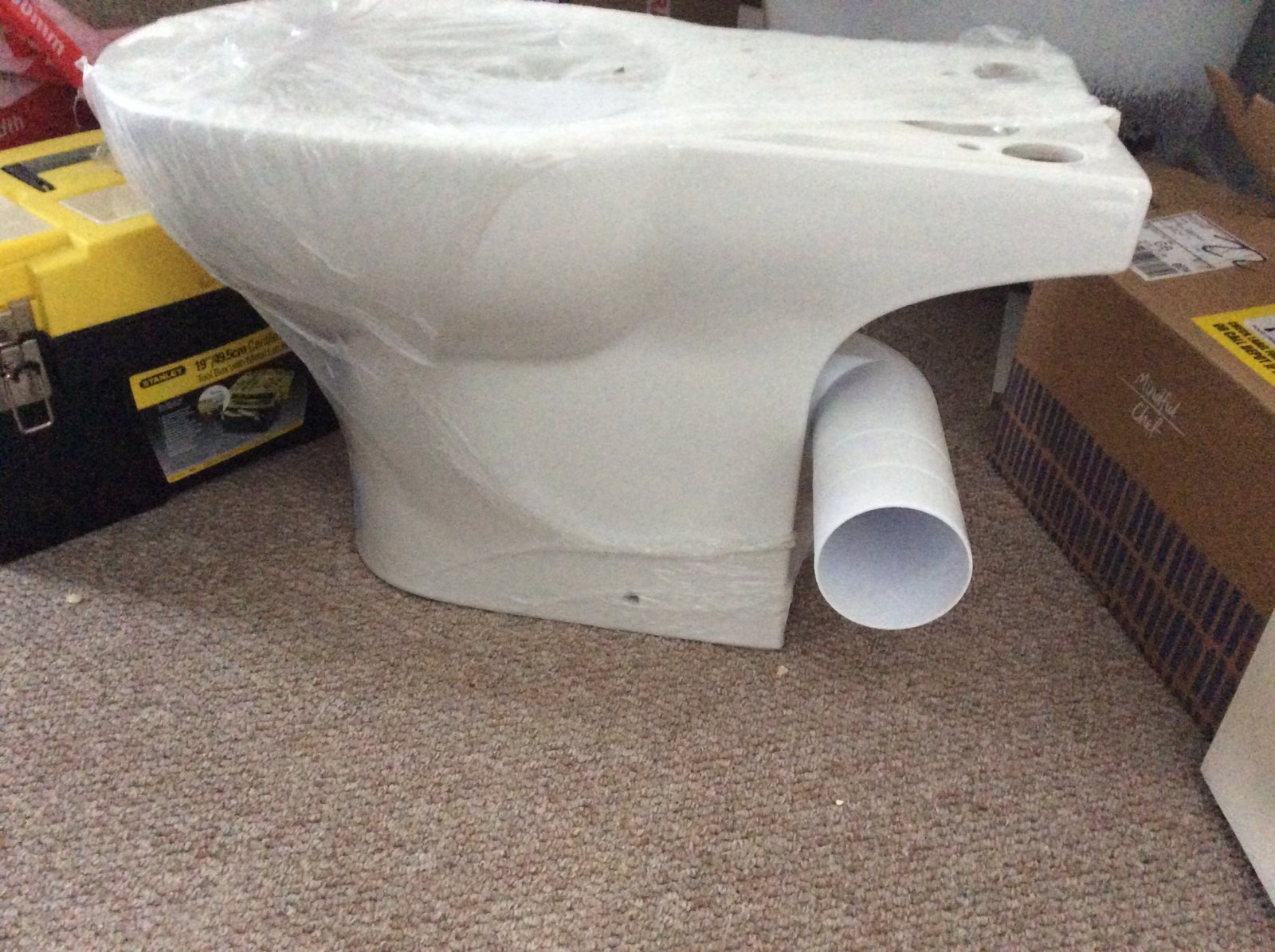

Ive seen them online and was going to get one but used pan connector on outlet out the side?
https://www.ukbathroomstore.co.uk/t...MIic664L714AIVyb_tCh1O-AumEAQYCyABEgIY7PD_BwE
