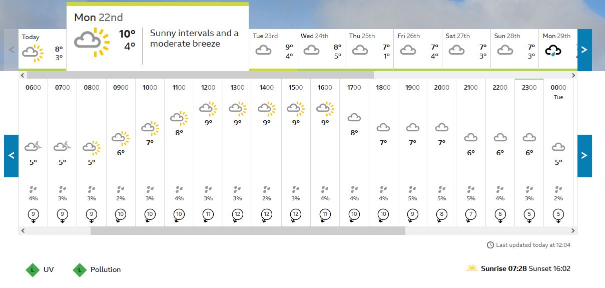

I've finally managed to get some time to do some painting in my garden.
I want to paint the:
  • wooden fence panels with this Ronseal fence paint.
  • drain pipes and metal garage door with Hammerite products.
  • garage brick wall with something like this Sandex paint.
Also, the garage side door but I can paint that indoors.
The question is, is the temperature now too low to paint any of these surfaces? Obviously they will take a lot longer to dry but I'm wondering if there will be problems when drying overnight even though there's no forecast for rain for the next few days?

the fence treatment is not a paint but a water-based stain. It has to dry before rain or it will wash off. If you wait for a sunny day and do one panel at a time, you have a fair chance it will dry in the sun. If not, do it again. it's quite cheap.
if the sandtex is rained on, it will leave unsightly stains on your paving and any brickwork beneath it.
paints are not likely to work well in cold, damp weather. You should not apply them to damp surfaces. Isn't there a manufacturer's instruction on the tin?

Stain was the word I was looking for when typing my post! I basically meant anything you brushed on.
What I'm trying to say is even though it doesn't rain for the next few days, could it still be a problem because of moisture in the air such as the way the grass is either wet or damp in the morning (dew) despite not raining?
I think the Ronseal 'stain' states the temperature needs to be above 10 degrees but does that mean constantly, a couple of hours etc?
Anyways, it looks like it's a risk especially when painting something like a metal garage door. It's just frustrating now that I have the time.
I just wonder how the professionals do it in the winter or maybe they just don't?
Thanks again.
I think that if the humidity is high, and especially if there is dew, it will not dry, in the same way that if you left a coat outside, it would be damp or wet in the morning.
