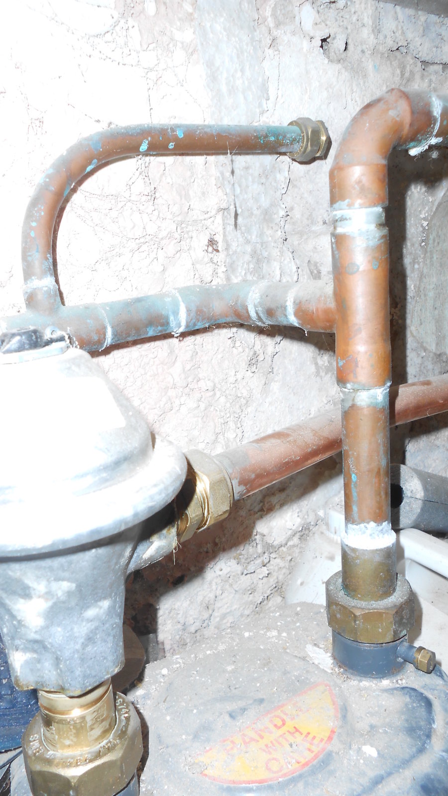

-It comes out of the top in a 22mm pipe pic 2

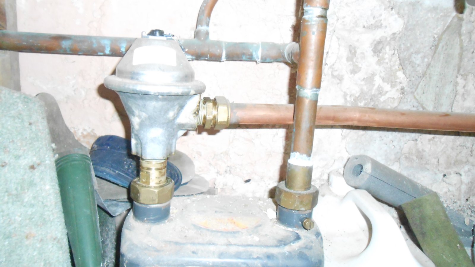

-After 100 mm it splits to 2 22mm pipes - pic 3
-Pipe 1 feeds a Main Medway Super gas fired water heater G.C. No: 52 476 39 (This is currently fed by 22mm pipe which goes down to approx 14mm)

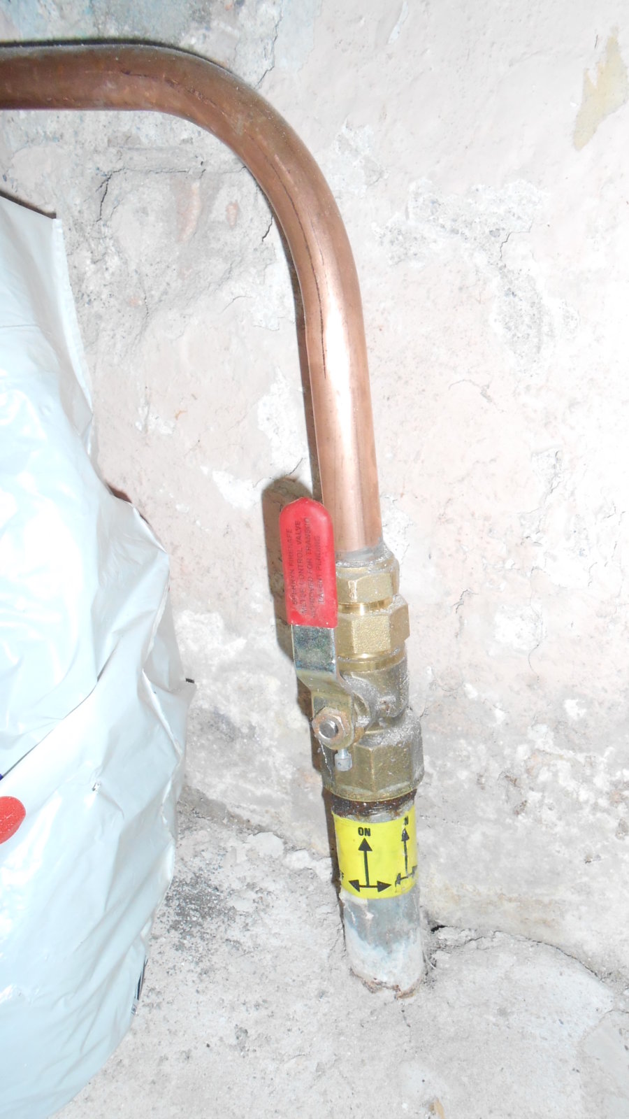

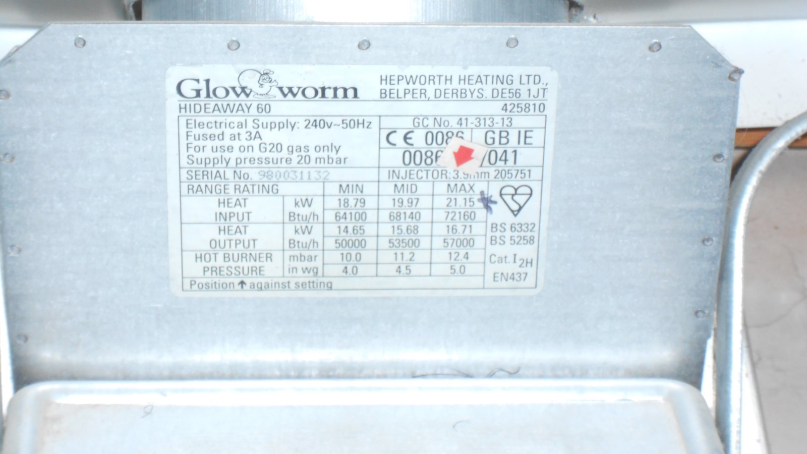

-A Glowworm hideaway 50 boiler: info on the boiler: supply pressure 20mbar, heat input 18.79 kW (this is fed by 22mm pipe which goes down to approx 14mm for the last couple of feet) pic 4

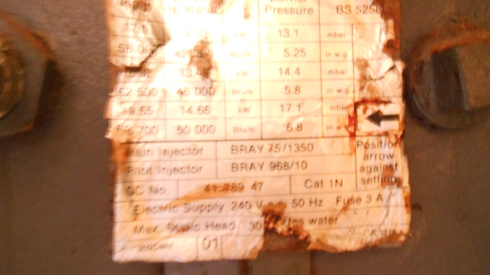

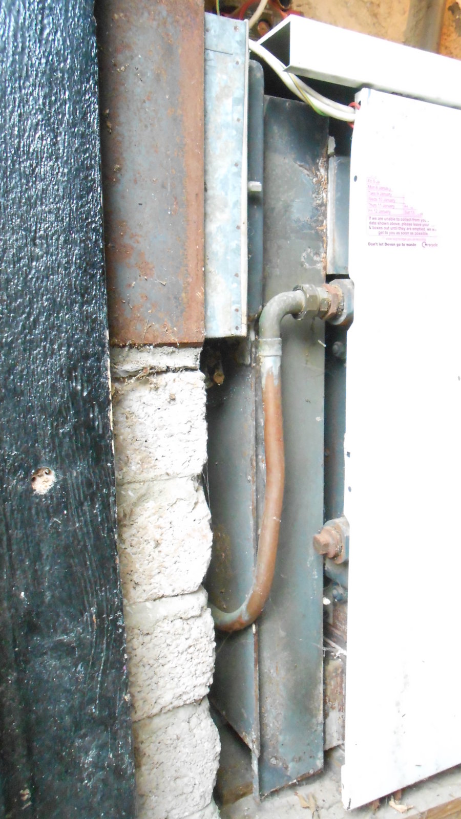

-A Thorn 44/54 Boiler: info on the boiler: heat input 19.55 kW, burner pressure 17.1 Mbar (This is currently fed by approx 14mm size pipe though an auxiliary gas meter (not read by anyone)) pics 5-9 This boiler is in a small outdoor shed/cupboard.

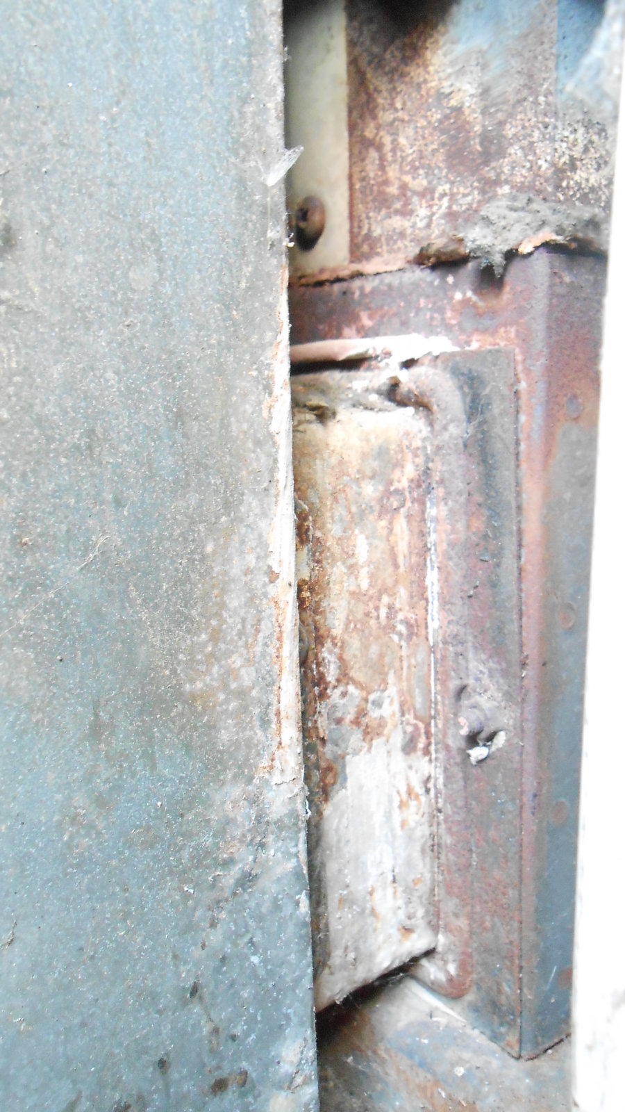

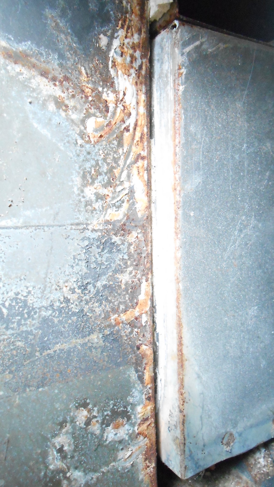

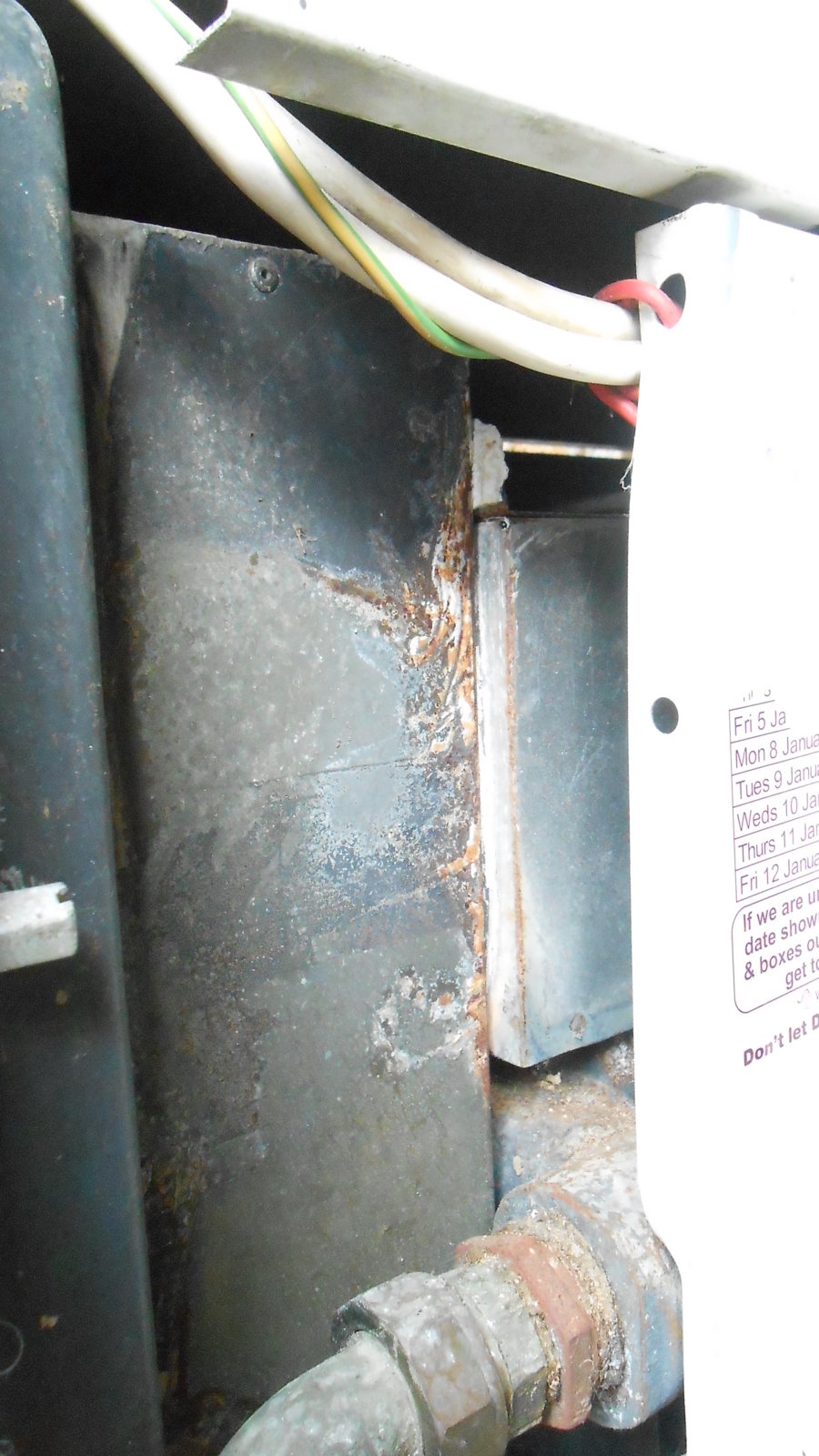

This seemed more straightforward to me - the engineer pointed out that the seals had perished on the Thorn Boiler (photos 6 - 9) and that they could be replaced, but he would need to get hold of something to adapt as the original seals are not made any more.
He seemed to be suggesting that this would be a temporary fix because:
-The boiler is old and probably not worth fixing
-The original parts are not available so it would only be a temporary fix
-We'd still have the problem of theoretically too low gas pressure
He has marked it as dangerous and not to be used in the meantime

-Whether the Thorn 44/54 is a boiler that is generally seen as being worth keeping going? I don't want to replace it if it's not necessary.
-I'm slightly confused about this 'temporary' seal fix - if the boiler is worth keeping going, should I be insisting on a 'non-temporary' fix, and what might this be?

I wonder who illegaly resited the meter?? Copper on the live side!
Or is that the secondary meter??
