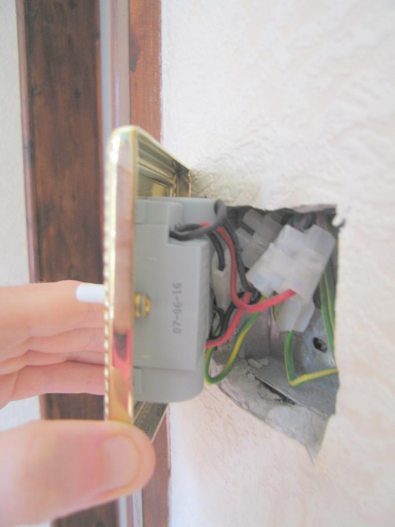

Hi , I hope you can help. I am trying to replace my double dimmer switch. Wires are 2 red and 1 black for each switch , plus an earth wire.
Do i connect each red to the L1 and L2 (on each side) and the 2 blacks into the 2 'wavey' connectors (one on each side again). I tried this and it worked OK until I scewed it back on the wall , at which point .. I switched it on again and the main fuse blew ??

Either you have pinched a wire against the screw when fixing it back, or the back box is too shallow to accomodate the dimmer.
Thanks a lot ! I have now redone it , and guess what , there was a'pop' behind the switch , and the upstairs one (the one that I've been having trouble with , doesn't work again ! Ah well , at least I'm only back at square one !! Will try again tomorrow. Whilst I'm here , maybe you will be good enough to help me out a bit further. The reason all this started is that the side of the dimmer that works the landing light has to be switched on for the upstairs switch (again for the landing light) to work !! I'm guessing that the downstairs dimmer is/was wired incorrectly anyway. Its a new(ish) dimmer that was on there , where all the other licht switches are old and pretty standard. Maybe it was wired wrongly when it was originally changed to a dimmer. Am I right in suspecting that the arrangement of wires in the upstairs switch should be mirrored in the 'landing' side of the downstairs switch? . Many Thanks

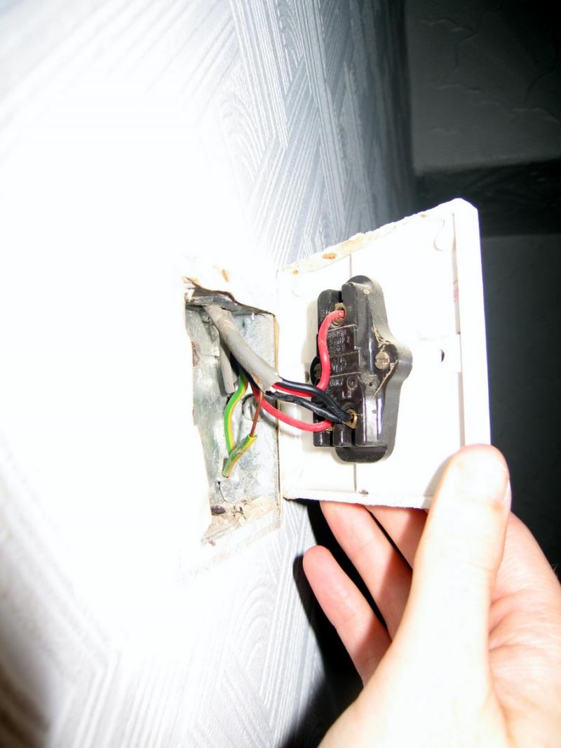

Hi again , This is a picture of the standard switch on the landing.
Red in Com , Red in L1 and 2 Black in L2

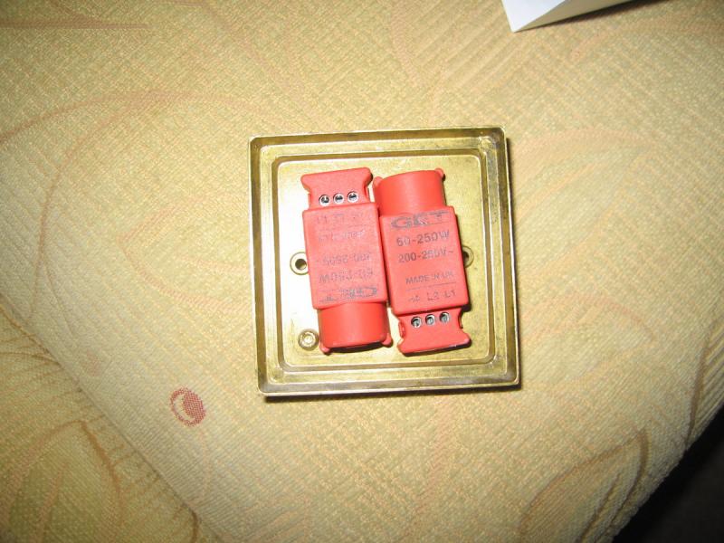

Below is a picture of the back of the dimmer downtairs. As you look at it , its the right hand side that operates the Landing light (The left side does the Lounge light and is working fine)
The right side is wired from left to right Comm Red , L2 Black L1 Black.

It would be helpful to see a photograph of the wiring at the 2-gang switch as well, and to explain exactly what you have and haven't altered.

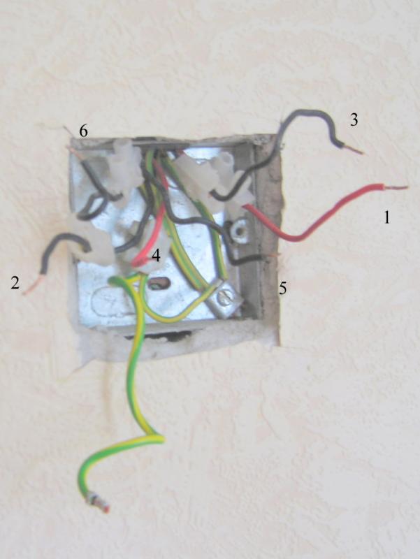

Hi again ,
This is a photo of the downstairs wires, as you can see it's virtually impossible to work out which wires come from which cable as the cables are hidden above mounting box and all but one of the wires (5) have 'extensions' on them!!
For info it is wired (ref downstairs light .. the one that is working .. Comm = wire 1 / L1 = Wire 2 / L2 = wire 3 (seems to be working fine).
Left side of dimmer (ie landing light side , which we know is and was wrong .. Comm = wire 4 / L1 = wire 5 / L2 = wire 6 NB wires 2 and 5 kinda got overlapped when I was trying to seperate them for the picture , so although '2' appears to be on the left , it is actually on the right when wired up and vica versa.

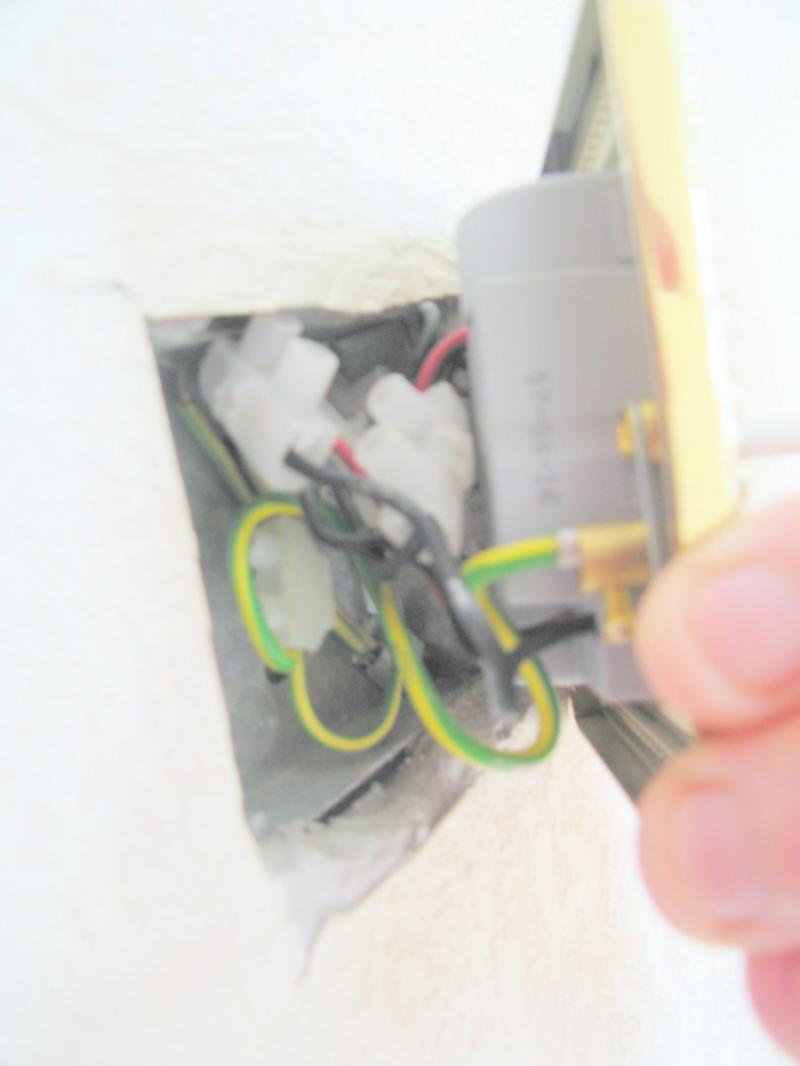

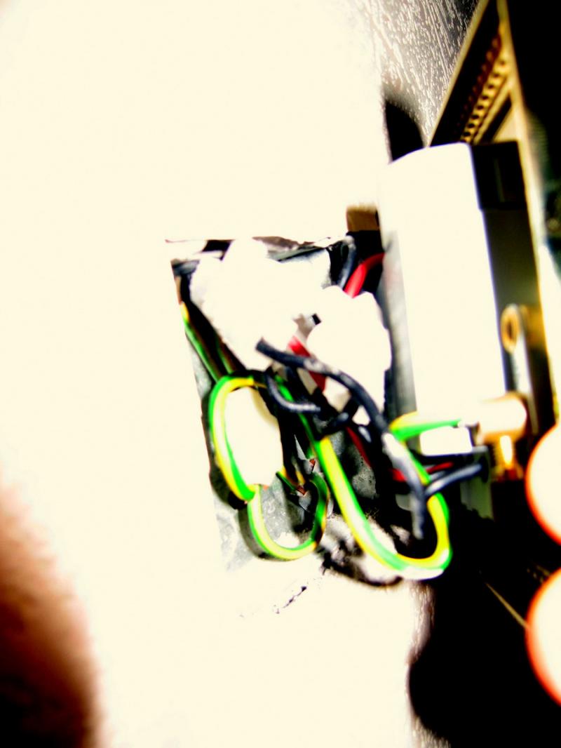

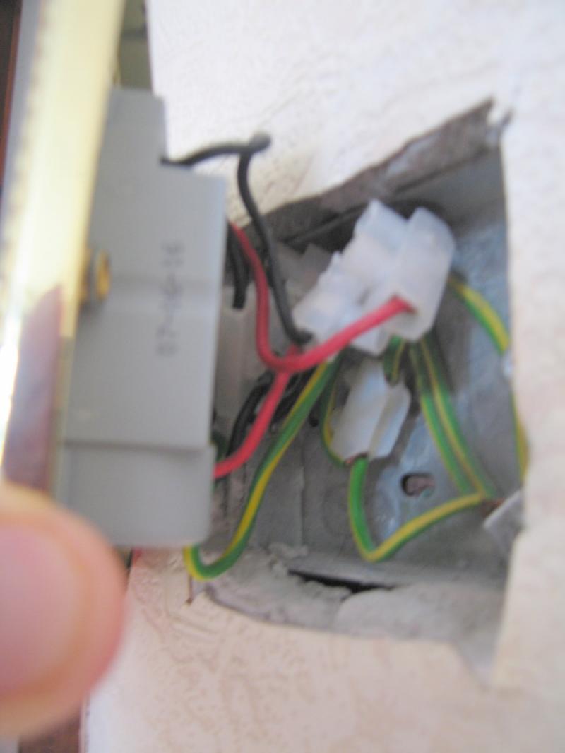

ie: left hand side of dimmer (which operates the landing light ( 2 pics)
Right hand side of Dimmer (operates Lounge light and working (2 pics)

Thought you said there was just two reds and two blacks in the downstairs switch?
And are there two blacks in one of the upstairs switch terminals?
You could do with finding out:
Which cores are live with the electricity energised.
Which cores link the two switch positions.
Which core goes to the landing light fitting from the landing switch position.
Perhaps to save ruining more dimmers you could get it working with cheap standard plastic rocker switches then swap to the dimmers once you get it working!
