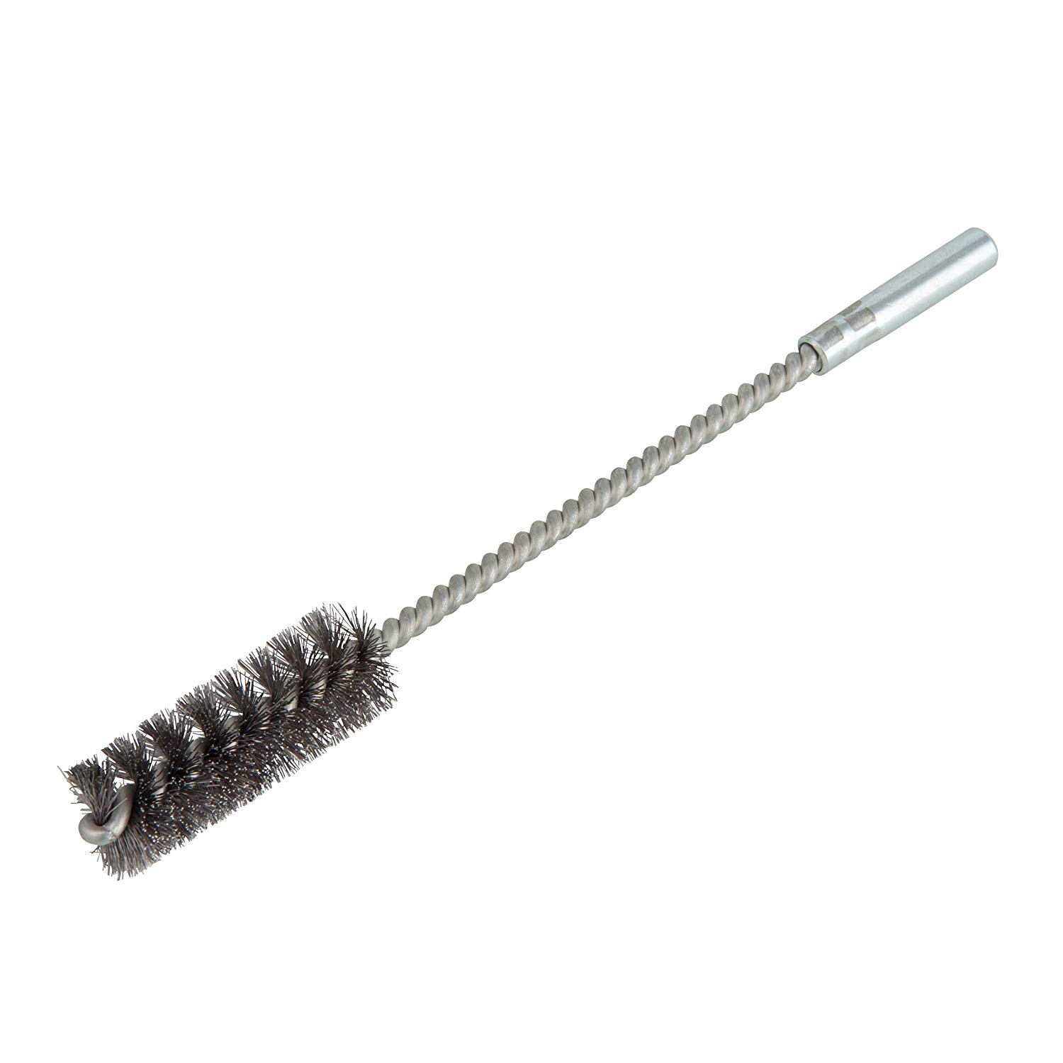

I found on the web metal brushes for drill in diferent dimensions, like the one in the picture.
Would it sand the radiator faster than a manual brush?

It will help to some degree as you can get into the various cavities et al......it will shift general loose debris but will struggle with paint. Radiators (the old type that I assume you have) are sand cast - perfect for holding paint!

Sorry, my response is possibly/probably not what you want to read.
Those brushes will do little other than polish the surface of the paint. The net result could well be paint that doesn't adhere to the surface and chips of as soon as someone bumps into it.
I understand you wanting to save money but your expectations are unrealistic.
