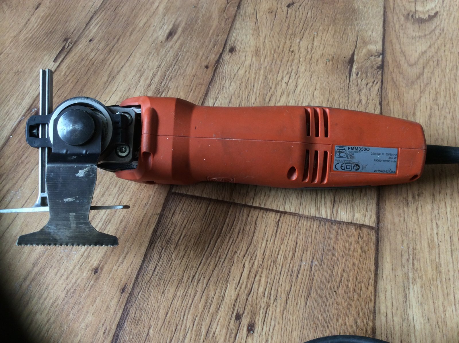

Or,
litl

I agree a Multitool is not the fastest but unlike JAK for whom I suspect "time is money" it is a jolly handy tool and one that has made the virtually impossible possible for me.
You could do the longest cut with something faster but for the return into the wall it would be ideal.
As for cutting a straight line I have not found it a problem but if you were less confident, if you lay the slate/hearthstone in position with a thin strip of something to use to protect the slate and blade it would act as a guide and clearance spacer to drop th slate in?

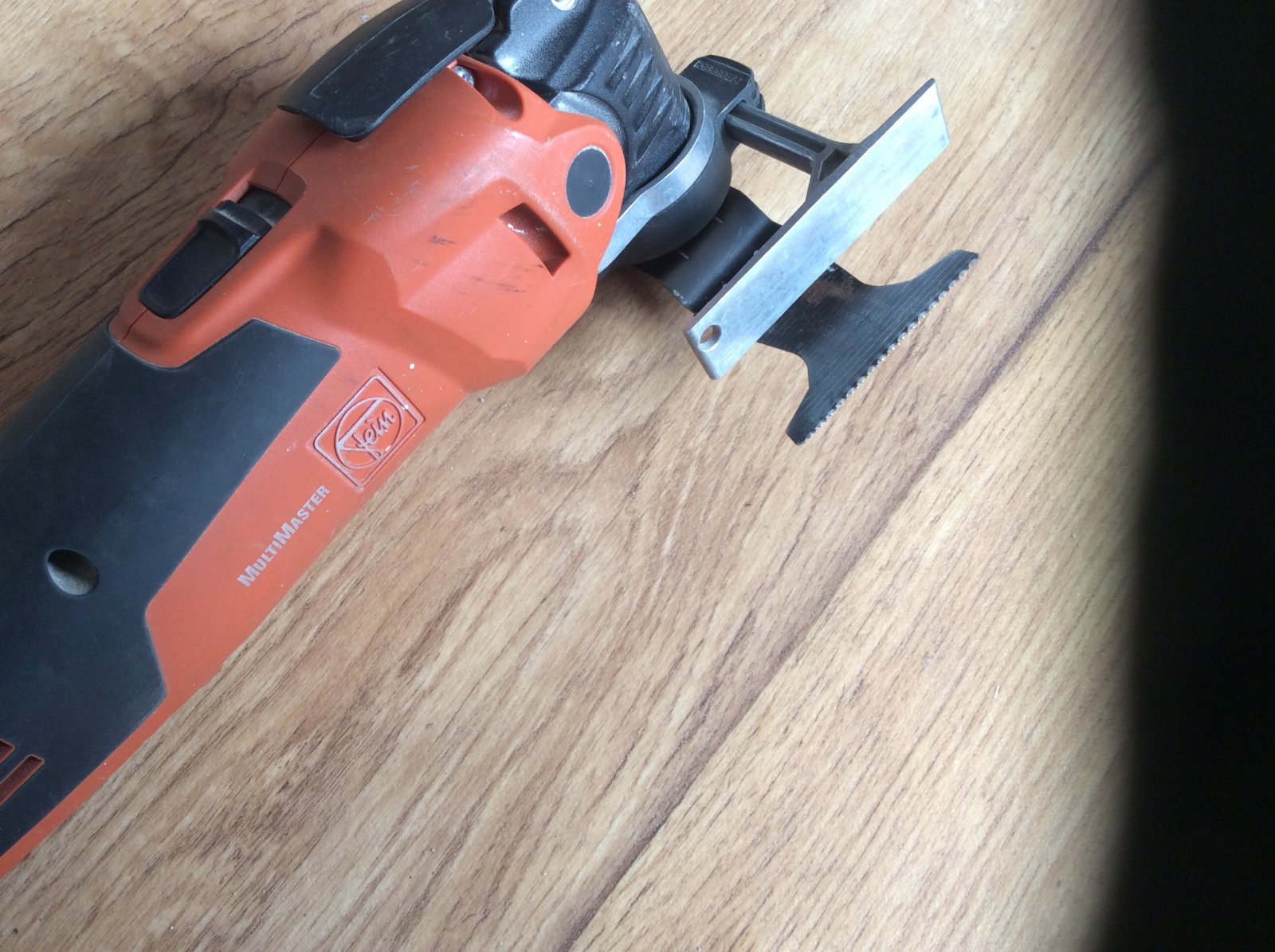

A multitool is an absolute must for any DIYer, currently doing a full renovation myself and its been an absolute godsend for cutting out floorboards.
Plus another vote for the multitool. The Fein gear is brilliant for getting those akward jobs done.
Nozzle
Thanks for the advice. Multitool from local hire shop was what I did in the end. Hard work - not maintaining a straight line but just cutting right through the board all the way round - probably had too fine a blade. Just as well it came with 2 batteries ;)
