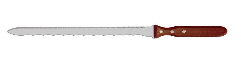

If you want to cut smaller volumes of insulation and don't want to resort to an old saw (and really rough cuts), it is probably better to consider something like an insulation kniofe, such as the ones by Stubai or Hultafors, or possibly the Bahco insulation saw. I've had both the Stubai knife and the Sandvik saw for quite a few years and the Stubai is the most generally usable of the two, being capable of cutting both Cellotex and fibreous materials relatively cleanly and with fairly minimal dust/fibre release (you still need to wear a mask, though). It is faster and cuts fibrous insulations (e.g. mineral wool) far cleaner than the oft used cheap bread knife which makes it well worth the money IMHO
Incidentally I've cut the insulation for entire restaurant ceilings, library ceilings, etc with the Stubai knife - sufficiently quick, fairly neat and accurate cut, minimal dust (and noise), low (relative) cost and no power required (often an issue where you install) - in any case far superior to either a rusty old hand saw or a bread knife
