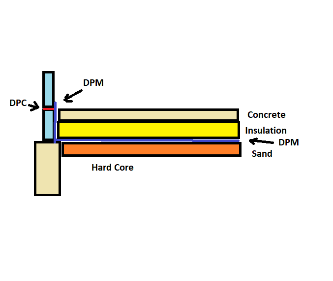

I set the top of my foundation concrete to be level with the sand blinding when I got to that point
There's nothing wrong with the levels, they're spot on.
But the top of the foundation concrete is too rough to lay the DPM straight on, without worrying about punctures.
A lesson learned for the future!
What would anyone advise? A thin coat of mortar to smooth it out? A thin layer of insulation to go under the DPM? That'll give two "folds" of the DPM, from the sand blinding to the insulation, then the turn up the wall. I can 'notch' the floor insulation to accommodate the thin layer of insulation under the DPM.

OK, in that case my levels are a bit adrift.
The top of my concrete floor will be level with the DPC in the walls..
So currently the top of the wall foundation concrete is level (or will be) with the sand blinding, which is 200mm below the DPC in the walls.
So there will be 100mm insulation, then 100 mm concrete which will bring it level with the wall DPC. Obviously the DPM will be lapped up the wall past the DPC in the wall.
This isn't a new build, it's a new insulated concrete floor going in to an existing building. And floor levels are predetermined.
The DPC is in newly constructed partition walls. The original walls have no DPC.

Top of hard core layer is about 250mm below DPC in the walls.
Then there'll be 50mm sand blinding, 100mm insulation, 100mm concrete to bring it up to DPC level.
The bottom of the foundation is 500 mm below DPC, and the foundation 300 mm thick concrete . There was no need to go further down for the foundation, it was already down to stone and rock.
The ffl will be about level with the outside ground,
This a diagrammatic view of the situation.
You just blind off the fill with sand then dpm or shove insulation in and put the dpm over that ( note not all insulation are moisture resistance but most are.
Yes, but as in the OP, I'm concerned that the top of the foundation concrete is too rough for the DPM without some cushioning or smoothing.
I specifically want the DPM under the insulation because I'm fitting the pipes for WUFH. I will connect them up to a manifold, and pressurise them, but they won't be in use until I replace the floor in the adjacent room with a similar arrangement. Nor will there be an ASHP until the adjacent room is finished. There is plenty of room for a GSHP in the future.

I'll probably put a thin layer of mortar on the foundation concrete to make it smooth.

As per Woody - it's what sand blinding was invented for.
