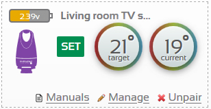

It worked, of sorts, but still not as I would like, so I got an electronic TRV head, this showed target and current temperatures on the PC.
Now the setting was easier, after the heating had been running for a couple of hours, if the target was below current closed the lock shield a tad, and vice versa. Ensuring of course the wall thermostat was set high, so all control was from the TRV heads.
I was surprised how well the electronic TRV's worked, rooms once set were within 0.5 degrees of setting, however did find the built-in anti-hysteresis was a bit OTT, in the morning 7 am set to 20°C and 10 am still not quite at 20°C, so would set to 22°C at 7 am and 20°C at 8 am, and this worked A1. It does seem some makes are better than others.
