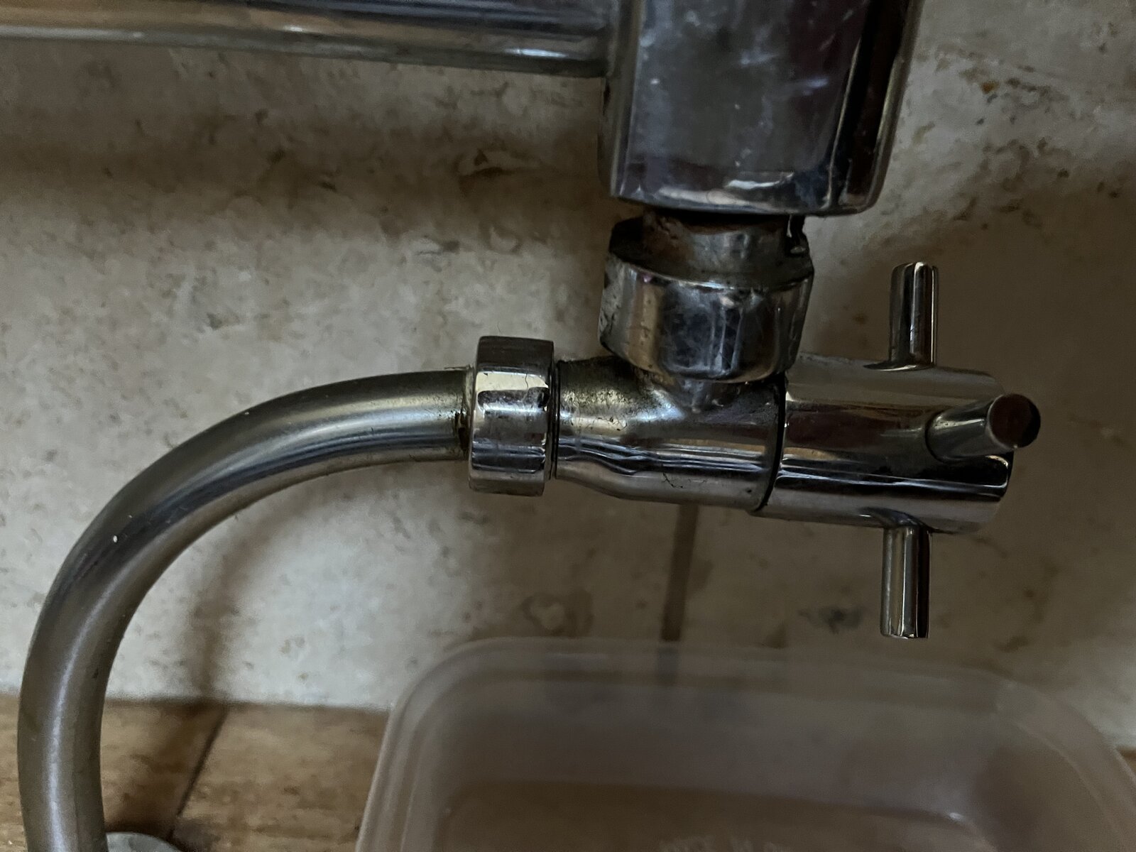

I have a new old house and discovered leaking towel rail valves ( after a day in house ) . I was going to isolate it to resolve leaks but the valves are unfamiliar to me the cross heads turn in both direction but cannot seem to identify a normal lock shield nut to switch off any help would be appreciated ( see picture )
Both sides are leaking and cross head seems to turn both ways
Thanks thought as much . Would I need to drain down entire system to replace ? A plumber is due to do some work in January so without replacing ( if not straightforward for me ) what would be recommendation to minimise leak , thanks for any advice
Turn fully clockwise to close. Where exactly are they leaking from ?
If you decide to replace them ,yours are angled valves ,the ones Andy linked to above are straight
They are leaking from the thread

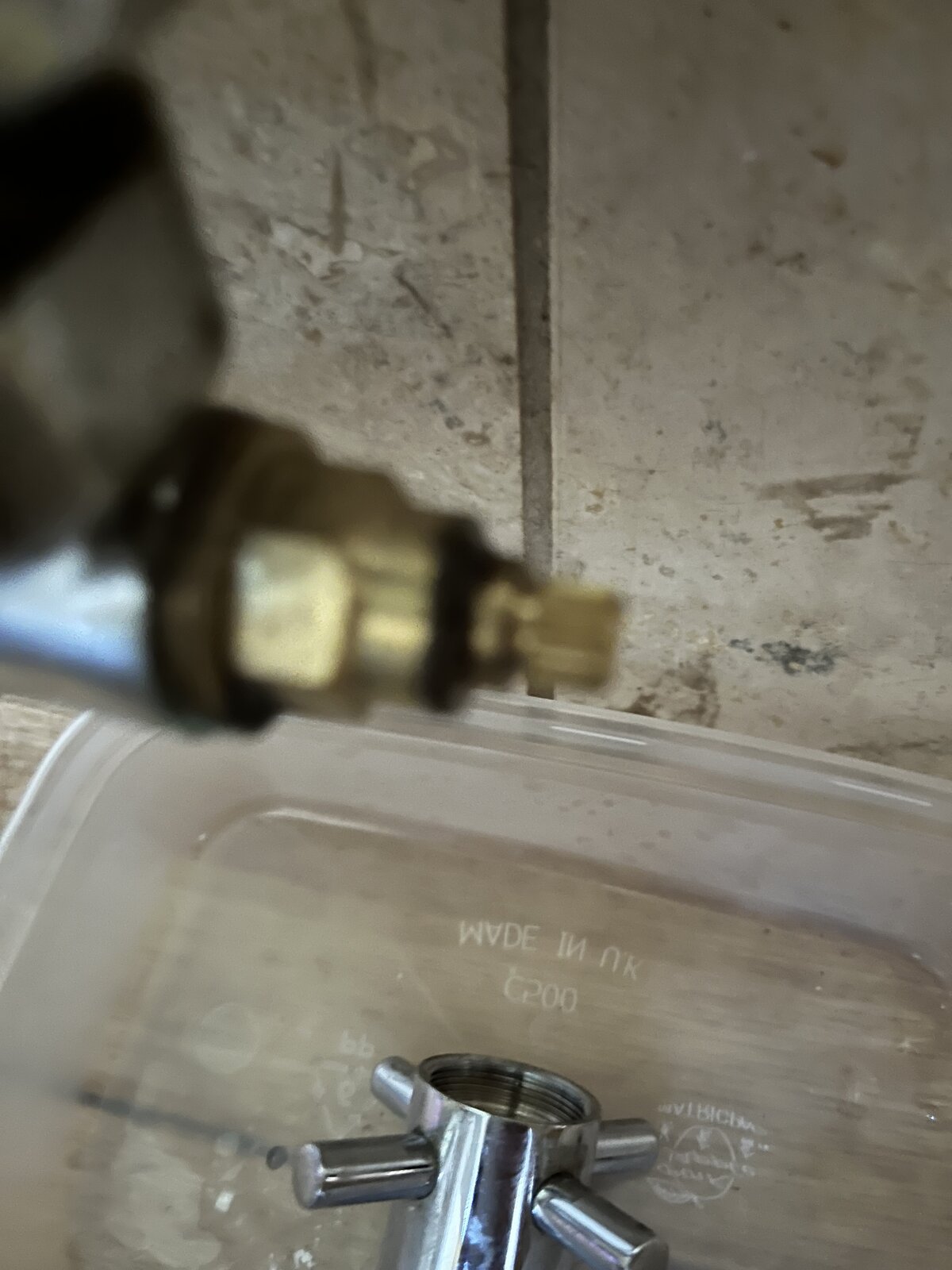

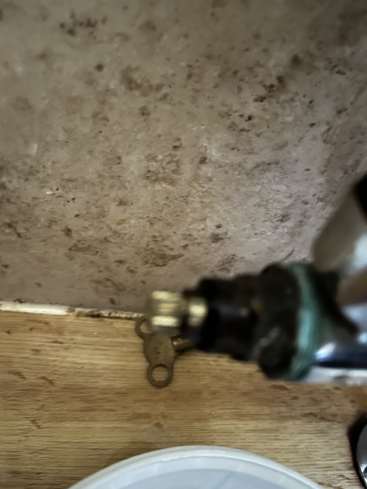

Unscrew the silver disc on the end of the cross handle,pull off the cross handle ( may be a screw beneath the disc),and show us another pic of the valve.
Hi sorry for delay here is pictures after removal of head .
Sorry realise pictures aren’t great. This is the valve ( both ends same ) .
As there is no gland nut to try to tighten ,or re pack,you would need to replace the valves.
