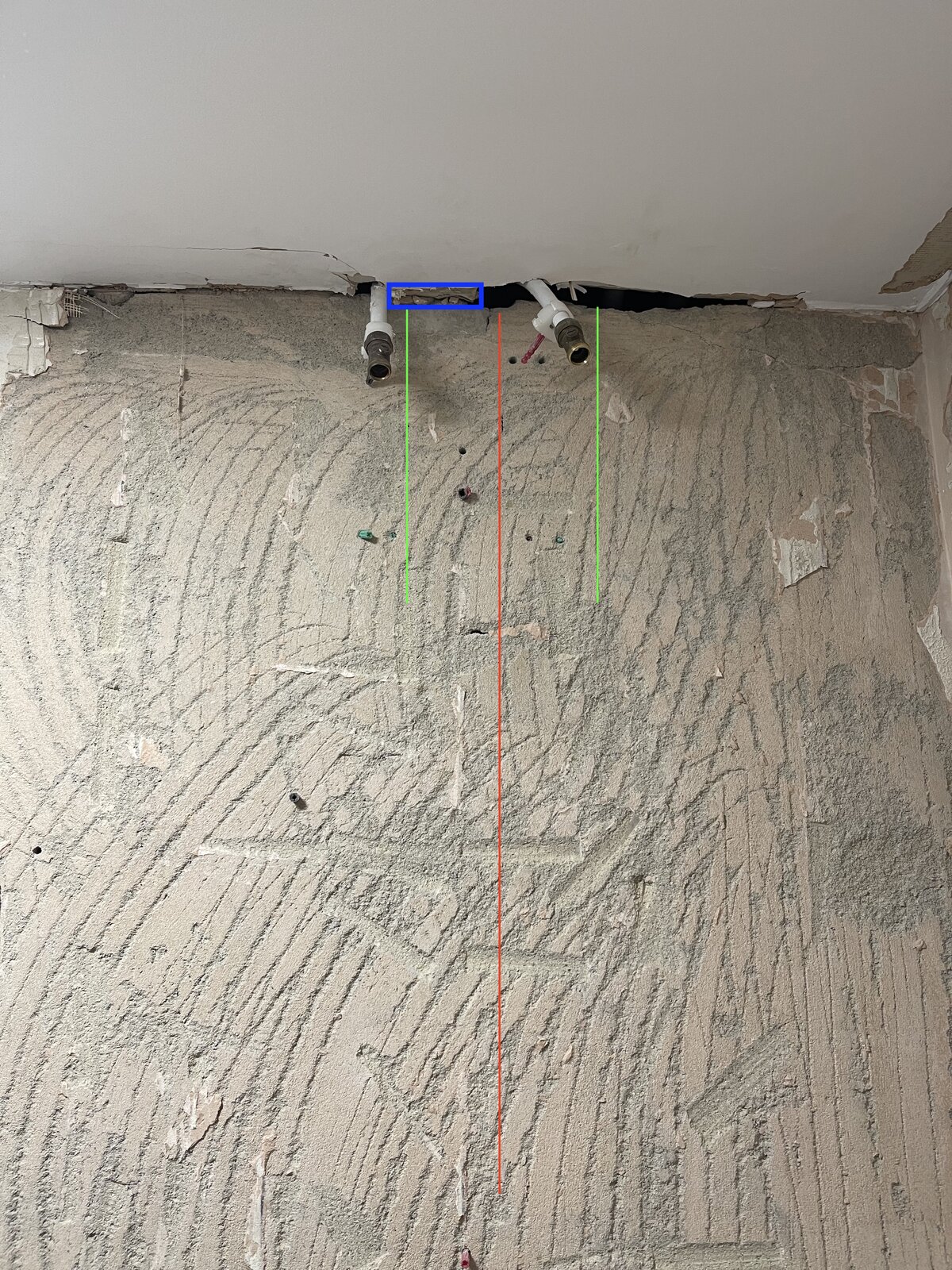

I am seeking to trace this wall to bury the pipes for a shower but have hit a snag.
The picture I uploaded shows the centre line (red) and green lines show roughly where the pipes need to come down. The left pipe however can't come over anymore as there's a joist in the way (blue). I am toying with a few ideas but I'd like to hear what you guys suggest?

Bring them up through the floor :eek: :LOL:
Seriously though, they're plastic, bring it down past the joist then offset it right and down to were it needs to be. Ideally cut the chase deep enough to get clips to hold it
BTW I presume you meant chase and not trace?
You can cut a notch in the joist if it's deep enough, not ideal as you'll have to come away from the end and double back. Or just drop it down and cover it with coving. If the plasterboard is that bad you could overboard and drop the ceiling.

Hey mate, thanks for the reply.
You may not believe me but that was one of the ideas I had but I wasn't sure if slightly bending the plastic pipe in a wall was acceptable or not. I'm trying to be all pro, ya know!

Plastic will flex enough for you to put an offset on it (an S shape) to get it back on track to where it needs to be. Plastic is ok buried in a wall, it's only copper that really needs covered when being filled over

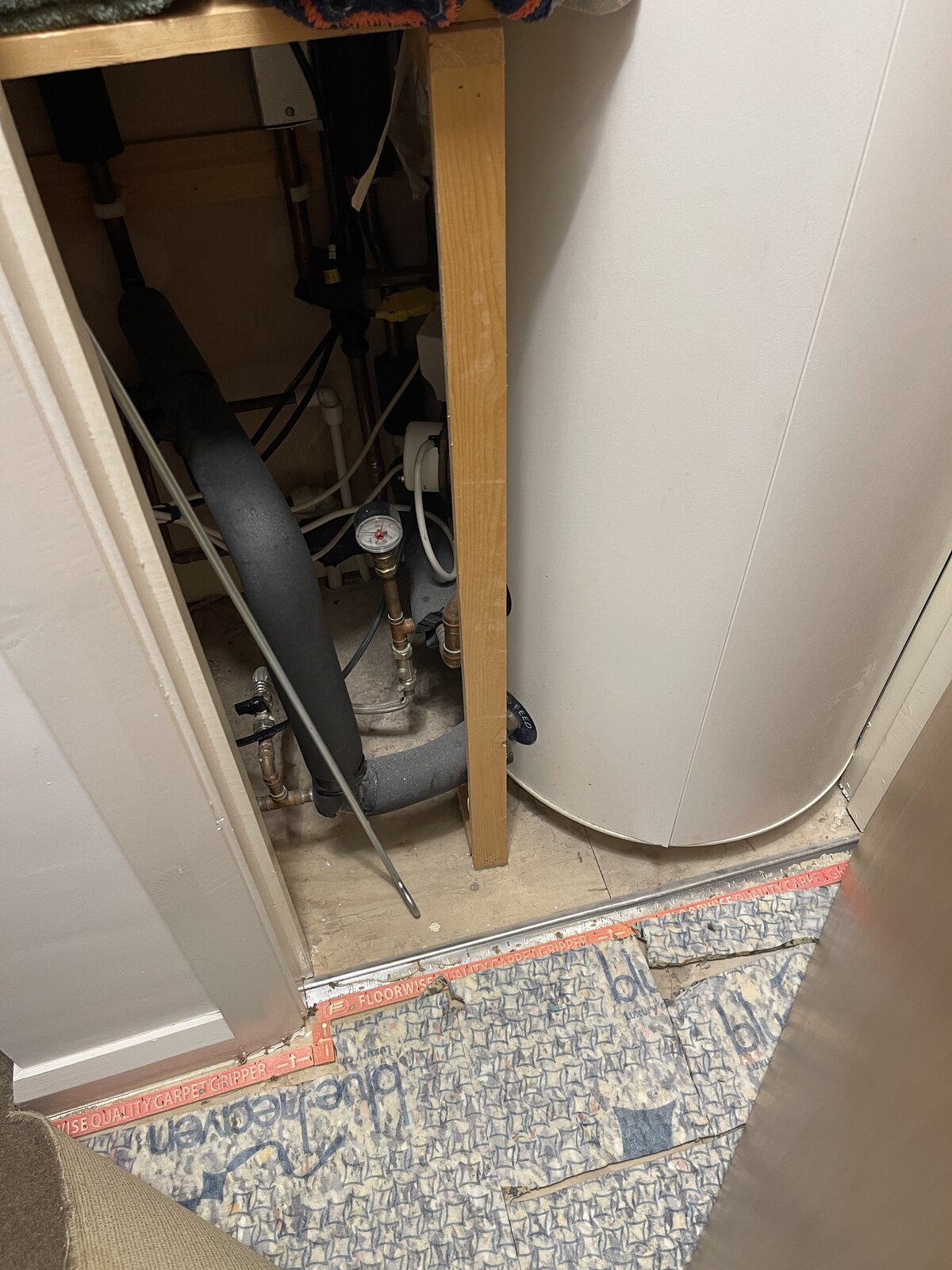

One last thing, I have a plasterer arranged for Wednesday so I need to have the trace done and pipework sorted tomorrow. Where would I locate the shut-off valves?
Shut off valve need to be accessible of course, if the pipework is down from the attic then I would have them up there. Don't forget to lag/insulate if the attic is unheated
This is a downstairs wet room so the pipes come down from between the floor boards and ceiling.
Ah ok, so what's up above? can a little access door be made?

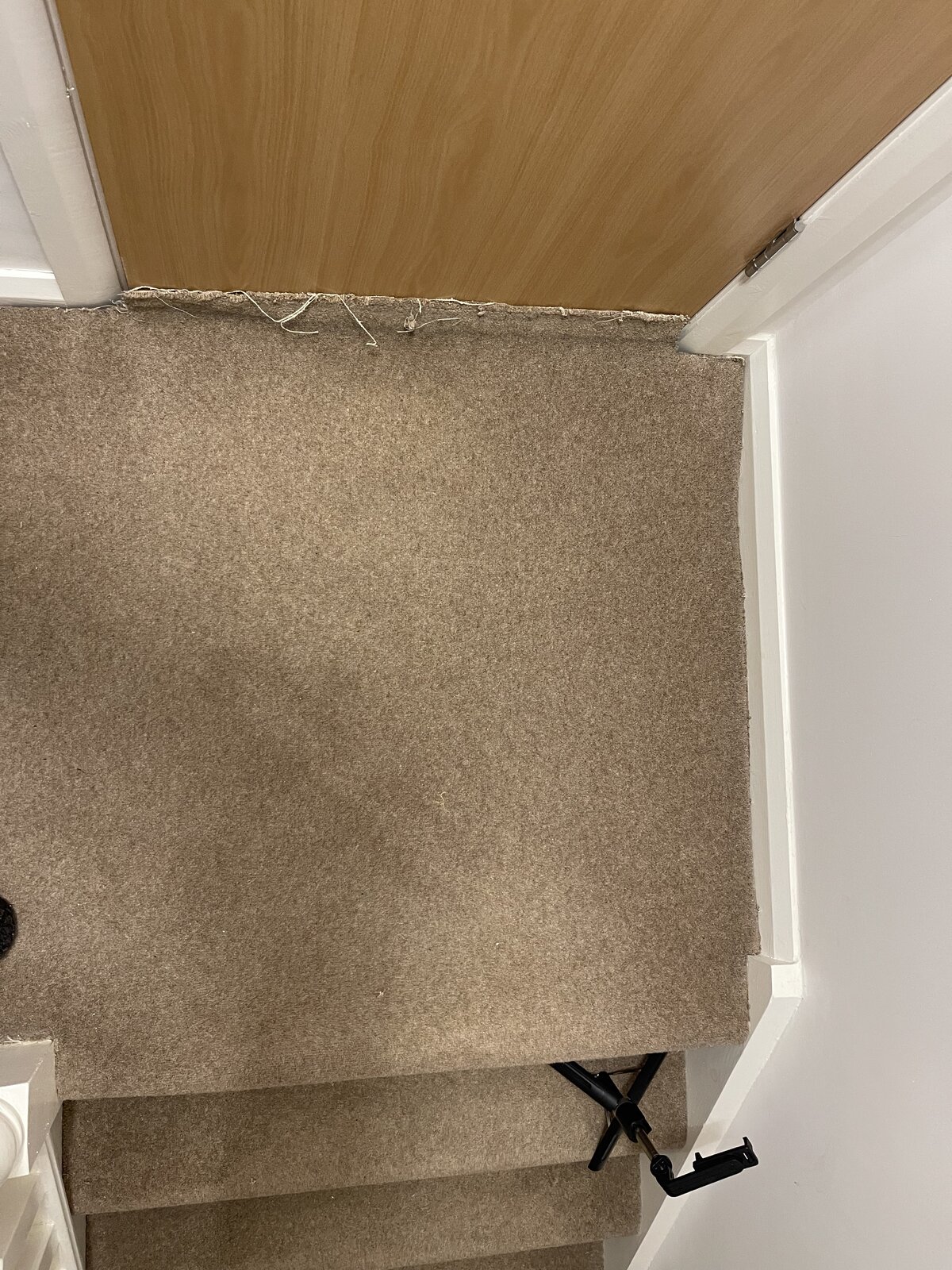

There is a small landing that leads into the hot press. I I believe the pipes for the shower run under this part of the landing. What I was thinking of doing is cut a section of floorboard and get access to the pipes and to add a coupler to both and do away with the isolation valve that exists at the minute as they will be pointless buried. That would also do away with a coupler being buried. Is that overkill? Could a Speedfit coupler be buried safely?

Yes, as long as they are fitted/installed properly.
