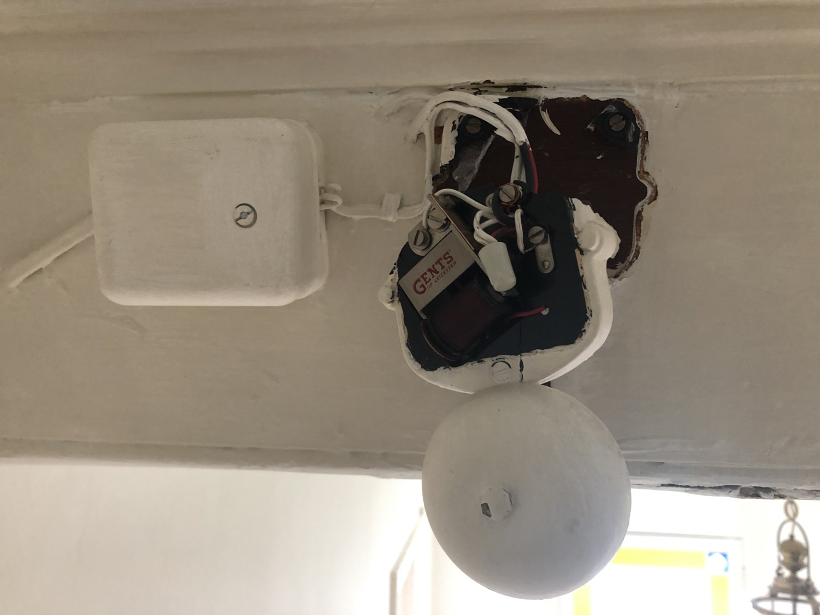

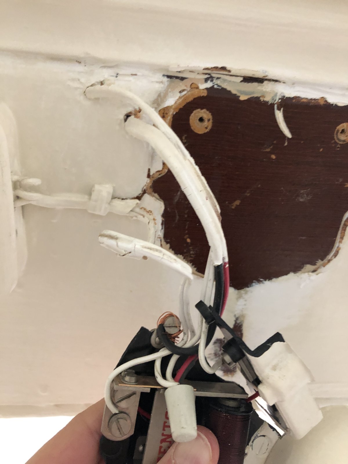

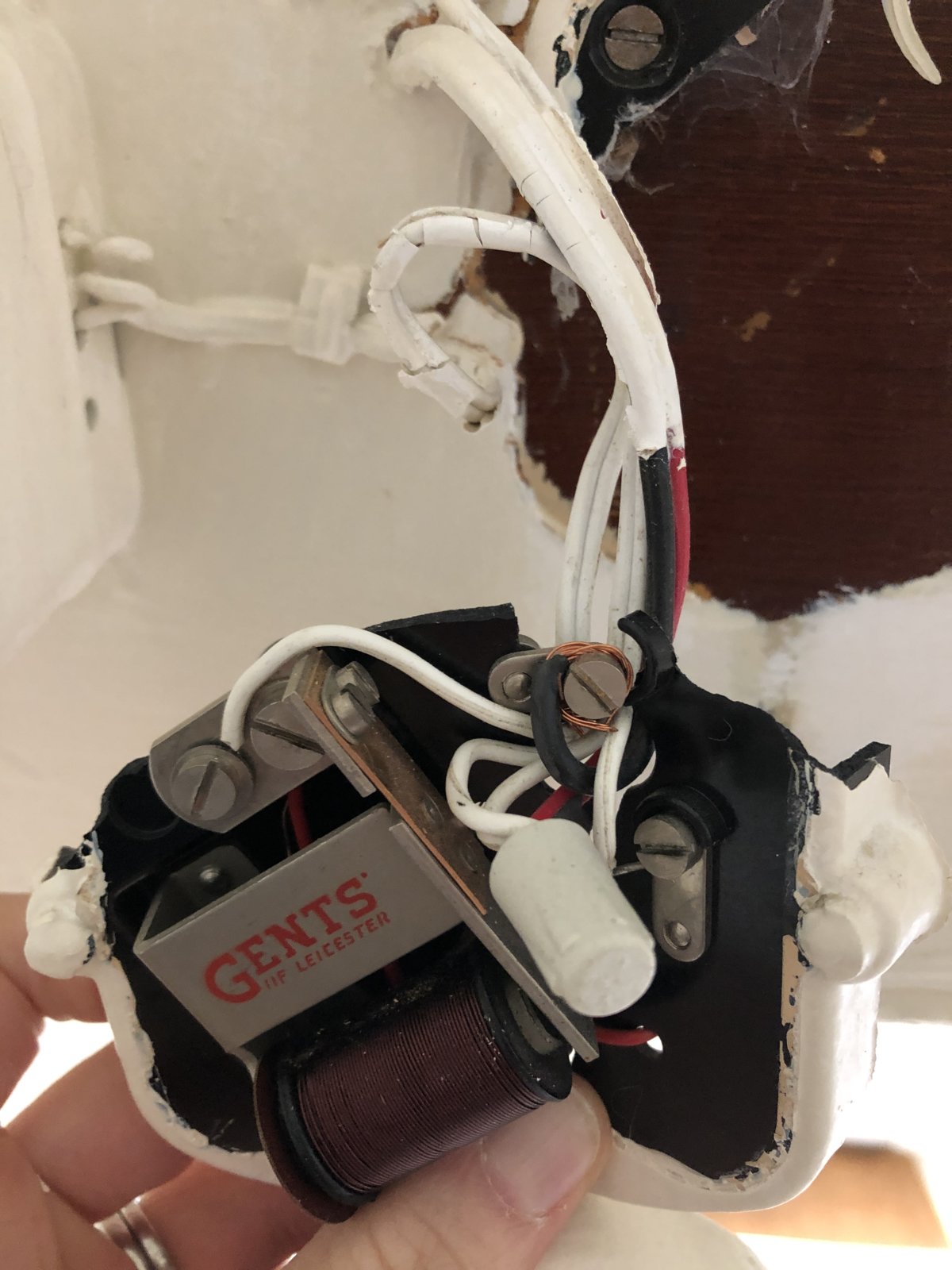

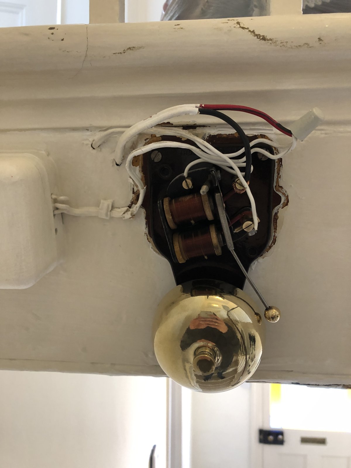

Hello - I have bought a replacement doorbell for the one that the removal men broke when we moved into our house. Unfortunately I have no idea how to wire it and what I have tried is not working (the transformer is still working as when the doorbell was pressed the other doorbell still vibrates but didn’t make a loud noise hence replacing it!). Is anyone able to help me without me having to get an electrician out? I have attached a few photos of old bell and new bell in case that helps!
Thanks for any help.
Nicola
Does the Armature actually move still when the Doorbell is pressed? Might just need a slight adjustment so it strikes the bell?
Just double checked and nothing at all when the doorbell is pressed.
Do you know what voltage the old and new bells are? You may need to change the voltage at the transformer, some old bells need only 4V which is too low for most others, 8 and 12V are common voltages for newer bells.

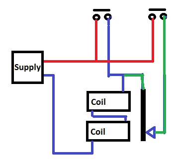

The circuit appears to be this
The black bar is the moving armature.
Some of the circuit is via the metal frame that hold the coils and the spring of the armature
Red and blue will give a single DING when that button is pressed, Red and green will give a continuous ring

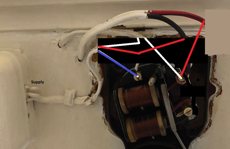

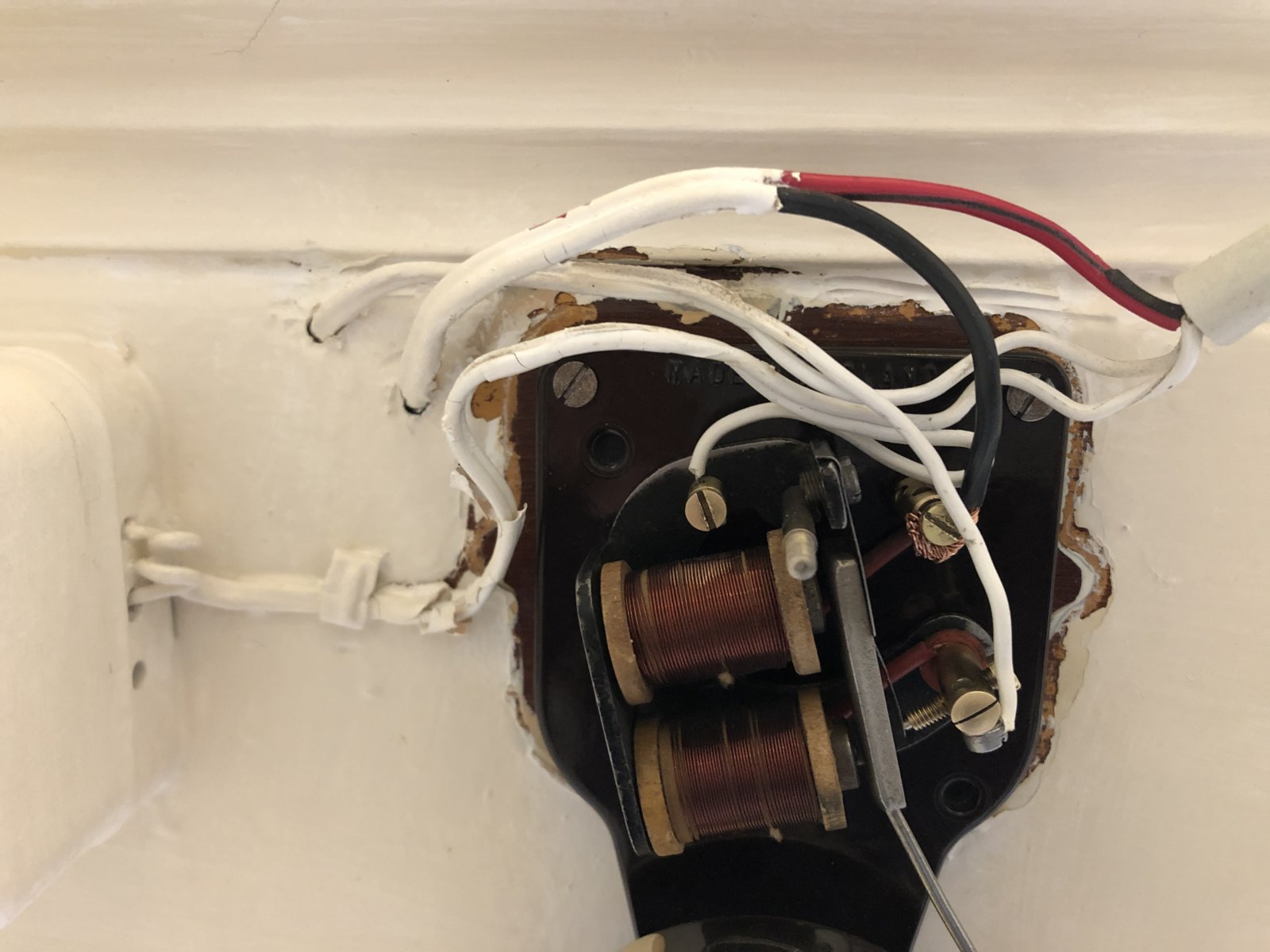

Thank you for the replies! We only have one push button - but the wiring as you say could be for a second one which isn't used any more. Bernardgreen - in your picture is Supply the transformer that we have? Is anyone able to tell me where the wires should go in the new doorbell? Thanks, Nicola
Blue ( supply to frame and armature )
then from the other side of the supply either the Whites or the Reds depending on which cable goes to the door bell that you are using,
