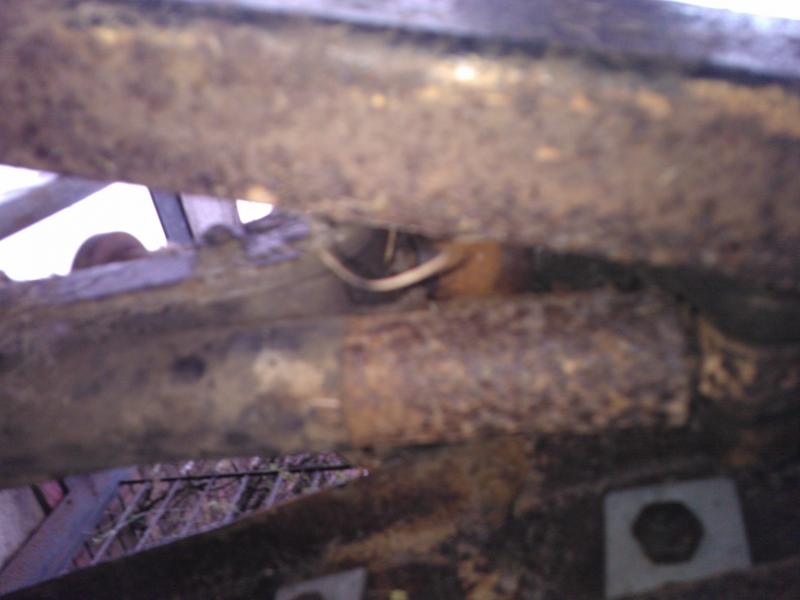

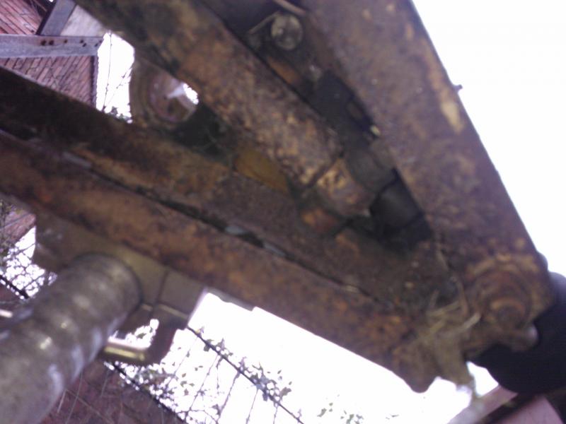

Hi Ive bought a trailer with overun brakes, everytime i reverse the brakes lock up on the trailer. I cant find any where to lock the brakes off when reversing drives fine when moving forward.
Ive attached some photos the only thing I can think of is if you cant lock it off when reversing the the shock absorber underneath is faulty because the large bar moves quite easily with no real resistance
There should be a half moon shaped plate that can be dropped onto the front (ball-hitch side) of the pushrod (diagram 2), to stop it applying the brakes when reversing

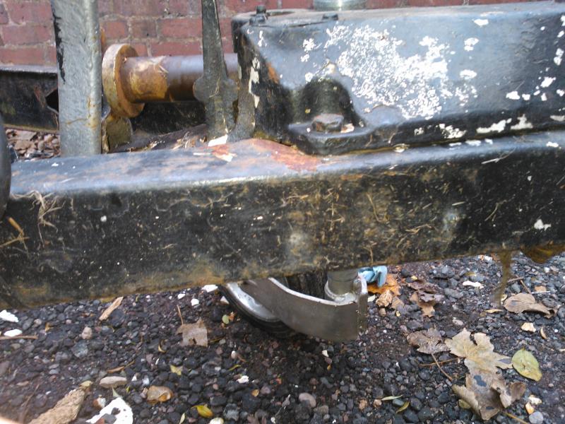

shows the semi circular thing which is dropped in to turn off the brakes.
If you did make the trailer non-braking, I think you'd need to replace the hitch too since its part of the braking system, so you may be able to find and buy secondhand (or new) eg an older style Bradley hitch, which is what the picture is of.
Hi thanks for the pic, im struggling to see the semi circular plate on the pic, could you point it out to me please
Its the bit in the middle of the hitch with the blue tint to it. BTW yours doesn't look like a Bradley hitch (well, that model pictured) so it won't have the same thing, but there should be something similar.

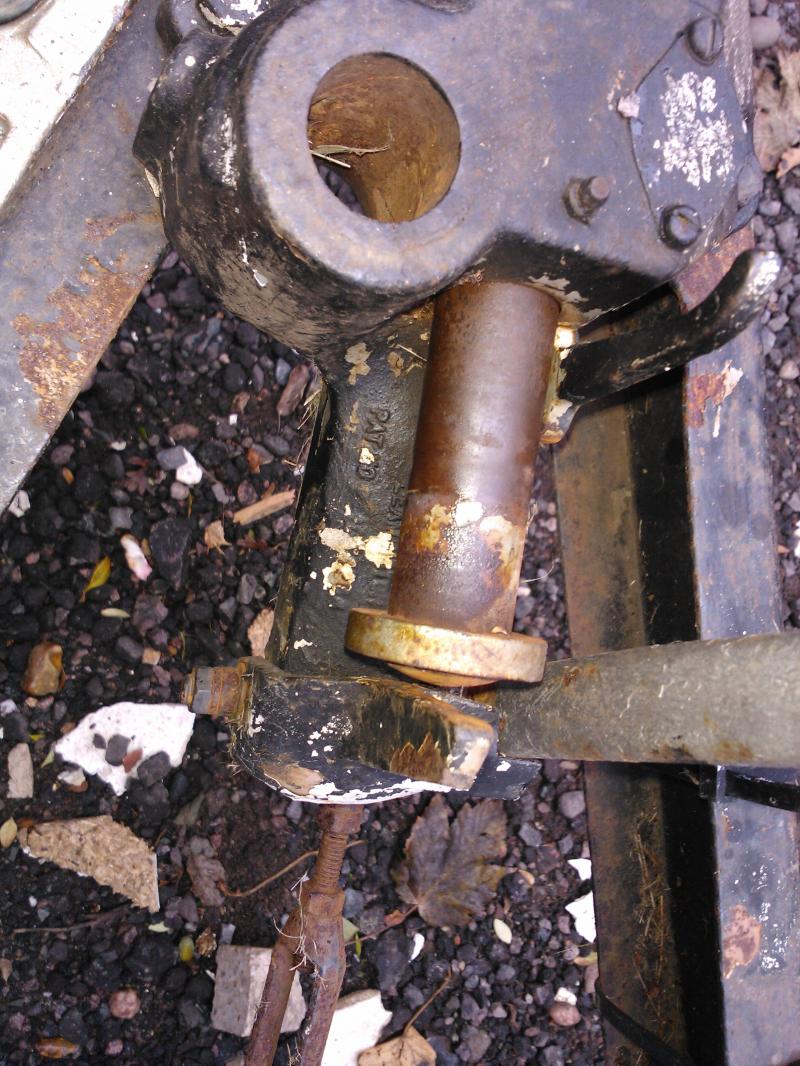

Just above the 410 on the second image. Its pivoted on a 6mm bolt, in the current position the trailer has no brakes (reversing). Flick it on the pivot and the hitch can move back to activate the trailer brakes.
