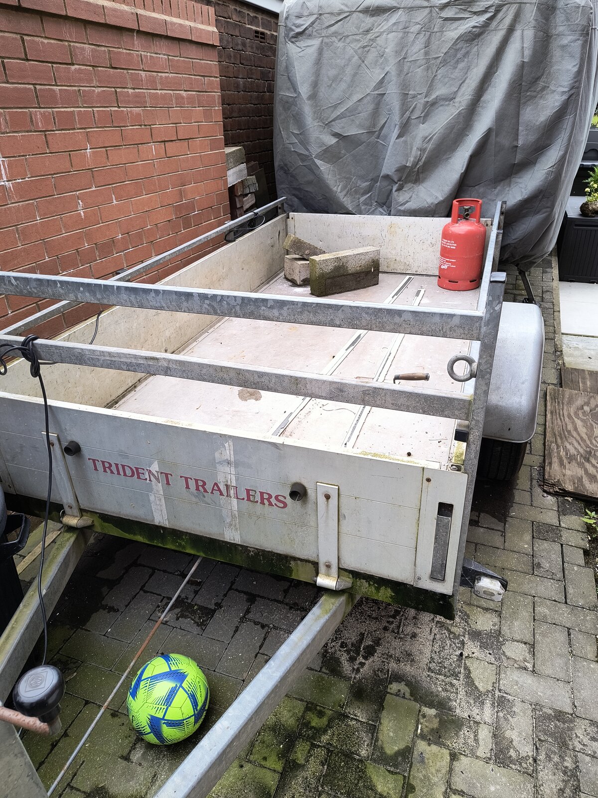

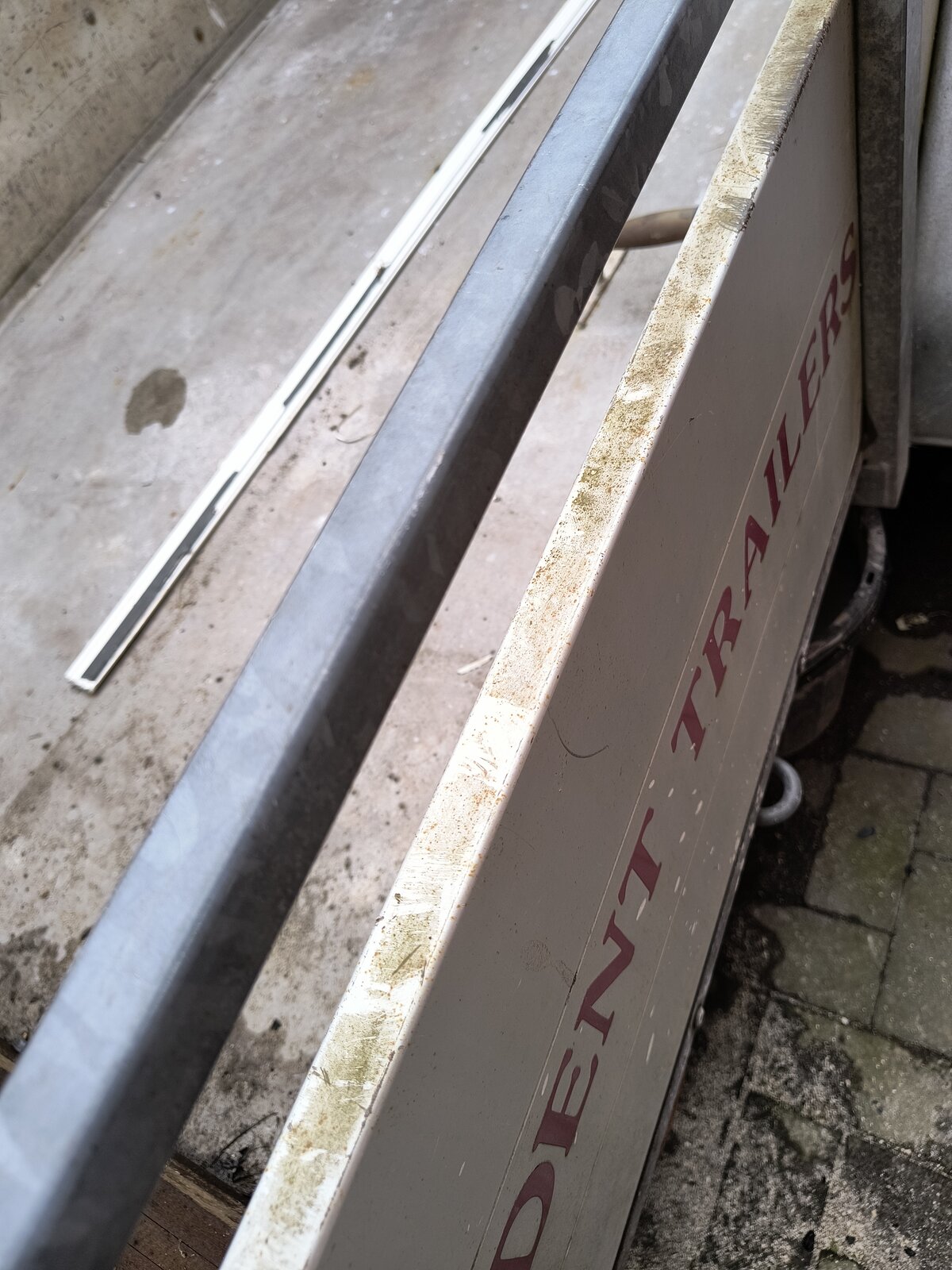

It's a kind of cross between these two types of trailer:

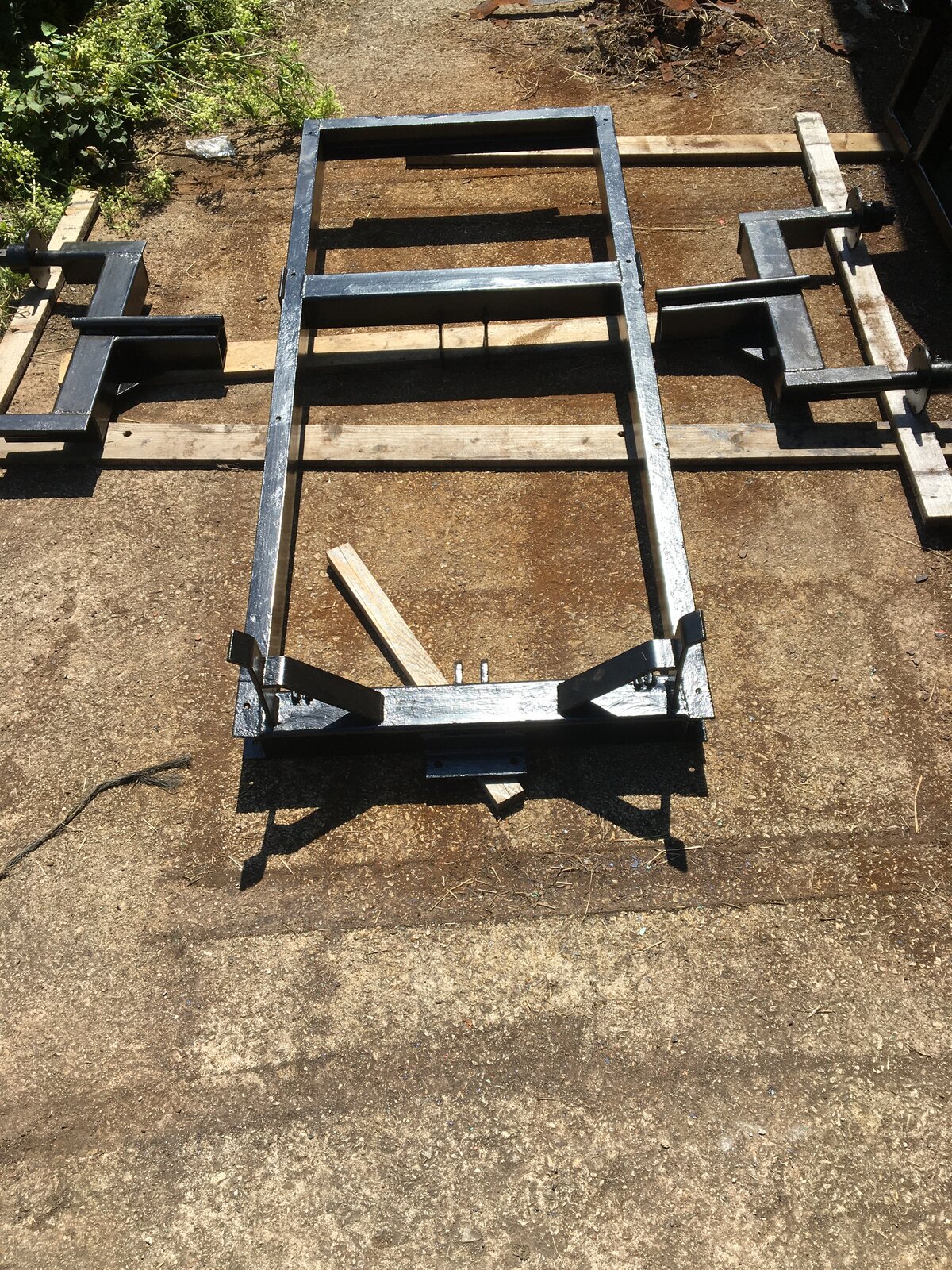

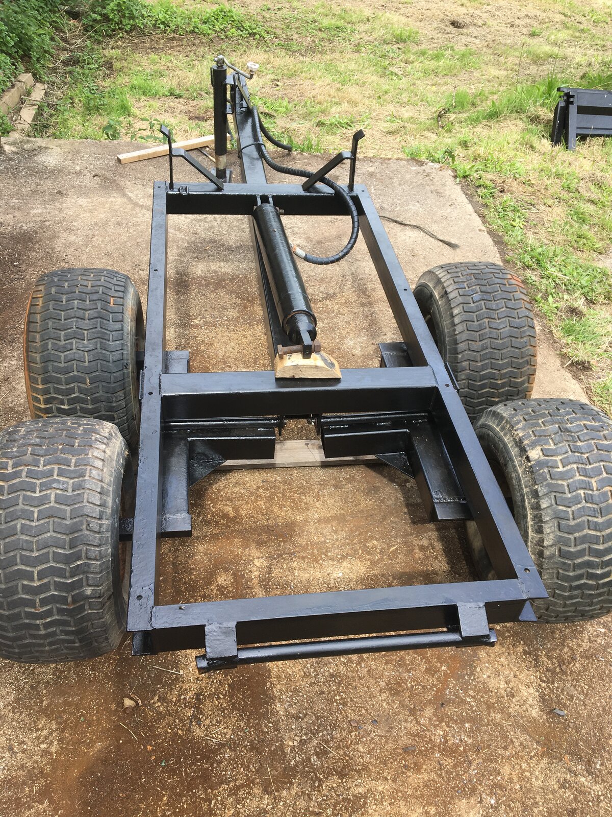

The Tipping bed frame, looking from the front. The brackets midway are for the pneumatic ram, and the pivot point is the brackets further back.

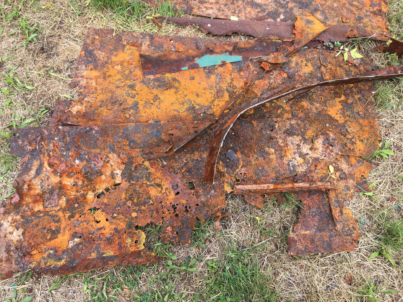

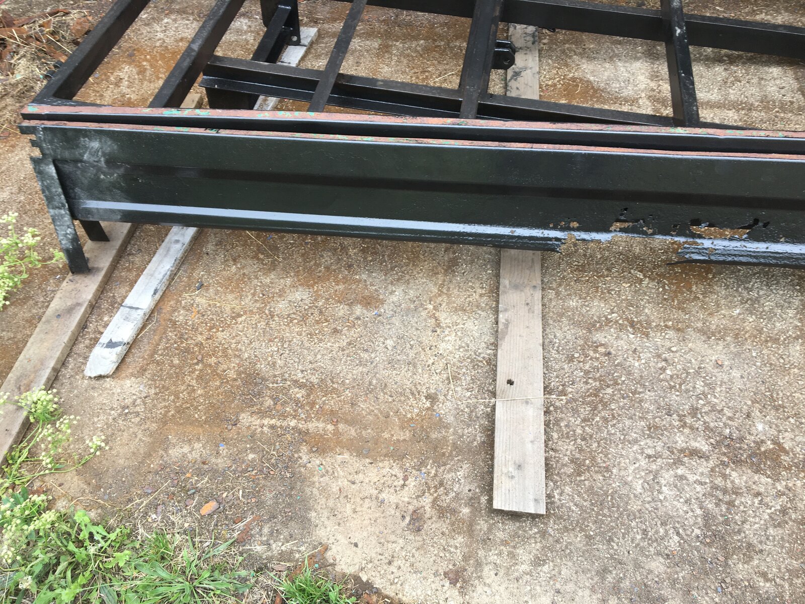

The remains of the bed and the lower half of the sides, after being cut off.

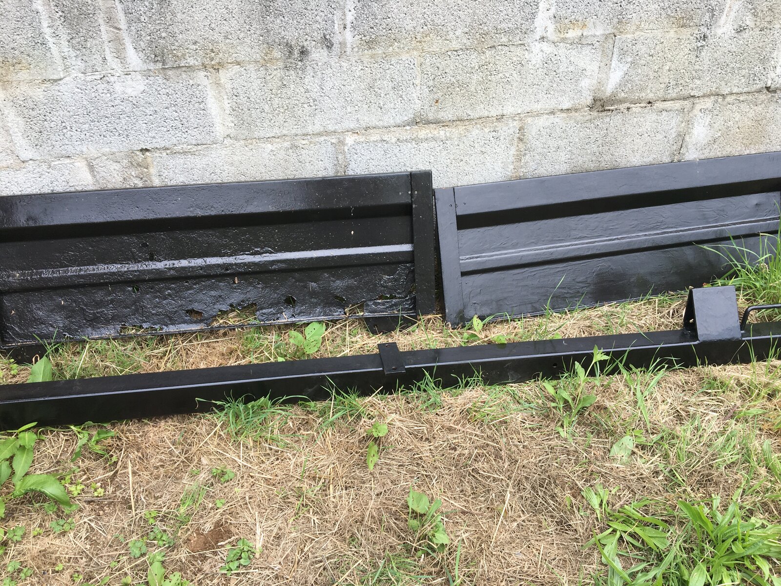

The head and Tail panels, and the draw bar.

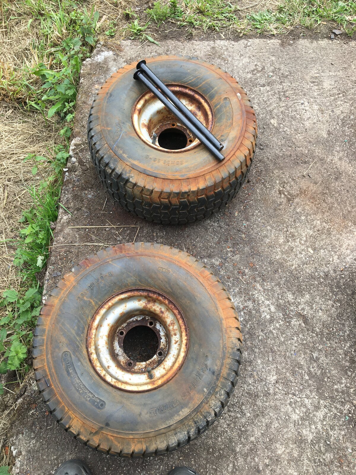

Wheels and pivots of stub axles.
Long sides with lower half removed
The only bits missing are the chassis which mounts the wheels, the wheels and stub axles, the pneumatic ram and the stand, which goes on the end of the drawbar.
The chassis and the wheel carriers are in the car port. I'm trying to strip the rust and paint it while avoiding the rain.
The intention is to line the sides with timber (OSB or Ply). I can fix a slate batten along that middle fold (which is now the bottom of the metal that's left, tucking the end of the slate batten behind the vertical end channels. That'll give me a flush surface on the upper half to mount the timber lining. I'll add a slate batten, on the outside, to the bottom edge for reinforcement and to mount the hinges on the outside. You can see the existing welded on hinges on the bed frame. Although one broke off, and I've recreated it with a bit of steel sheet, left over from a previous project. I can bolt it on to the frame.

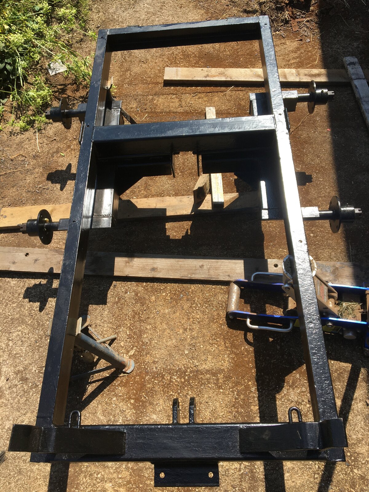

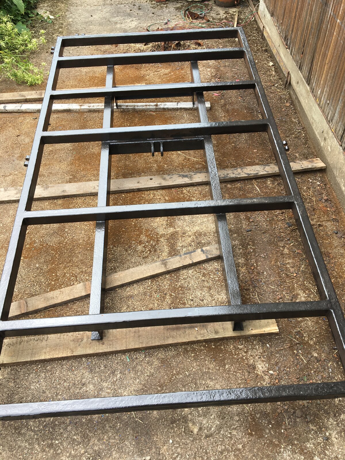

The basic reassembly is done.
This is the chassis, wheels, hydraulic ram, drawbar, etc.
And the trailer bed now fitted. Got to start rebuilding the bed, sides and ends now.
