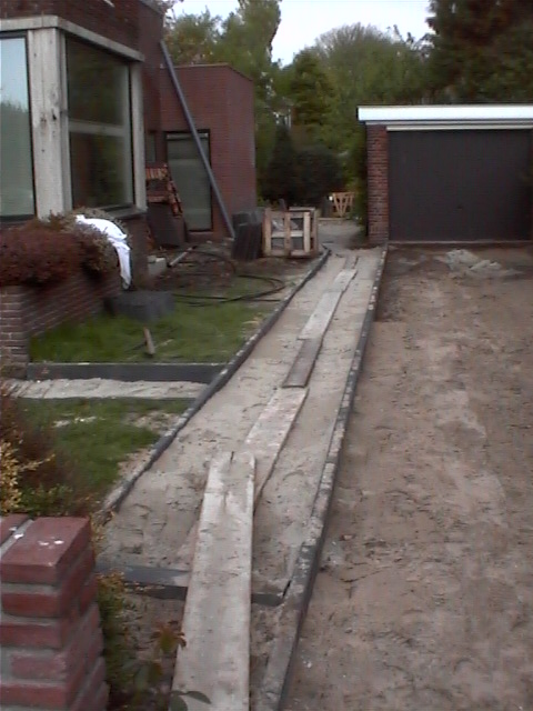

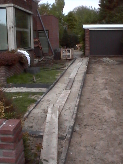

Any reason to not use 1mtr long edging, you can get them 20cm deep over here in Holland, generally they don't move because of the surface area, and the ends are male female, but you could add some mix behind if you want to really annoy the next guy to work on the paving ;)
