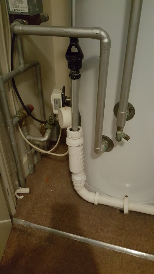

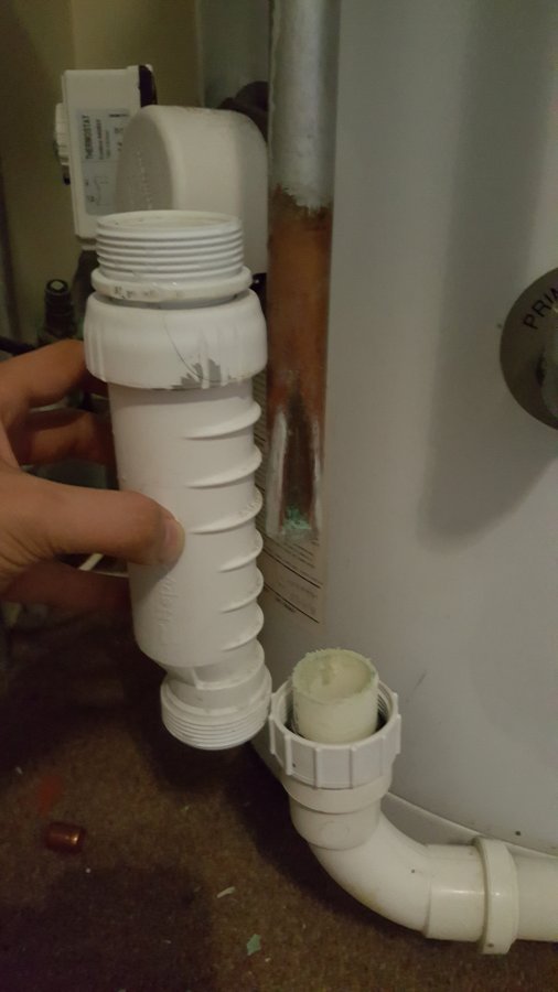

After having a blocked drain a few days ago (cleared now), I've noticed a slight sewer smell in the house. Our unvented cylinder discharge connects to a HepVo trap however, this seems to be the cause of the smell (pics attached)
It appears that the discharge pipe is pushed right into the HeVo trap holding it open.
Is it ok to cut the pipe back so it just enters the trap but still allows the plastic membrane inside to close?
Thank you
The 22mm copper pipe from the tundish into the HepVo valve is far too long, it has probably held the self sealing membrane partly open allowing the foul smell into the property.
The pipe shouldn't intrude into the valve and adaptors are available from Wavin for use with the HepVo.
It may have damaged the membrane and it may not seal properly again. I would put a new one in to be on the safe side or get the original plumbers back as that clearly doesn't meet with the guide lines.
Have a look at this guide in the HepVo guide page 9. http://www.wavin.co.uk/web/download?uuid=a9443f31-058e-4839-bb64-f88b705cba07
Yes, looking in the trap, the membrane now just stays open so I'll need a new one.
I see that I can buy one with a tundish adapter, that seems the best option.

NHBC have a 10 year warranty scheme in operation so may be worth trying them.
It's obviously poor installation and a potential (though slight) health risk allowing foul air from the sewer into your home, plus there may be other homes on the estate that have been plumbed the same.
Is it even permissible to run that relief into a plastic pipe?

The regulations are very strict on dimensions, fall, length of run and materials used.
The waste pipe has to be Polypropylene (Pushfit) clipped at no more than 300mm centres and the valve fitted vertically.
See page 9 in link in post #2
