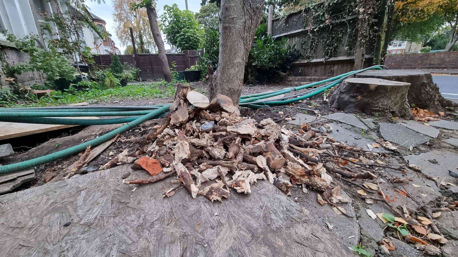

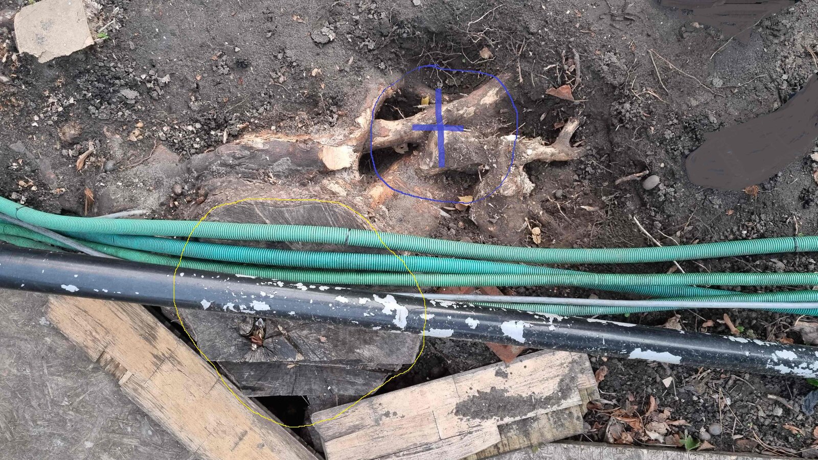

I took down a sycamore tree 6 years ago which left a stump (outlined in yellow in picture). The stump is elliptical, about 21" x 16" (so round equivalent, maybe 18 " diameter?).
I need to dig a hole for a 4" timber fence post next to it, right where its lateral roots are. I've been digging round and under the roots to clear the way for cutting them out with a recip saw which has been OK so far, but still got some big roots to get through. So, I was considering getting hold of a chisel ended digging bar to inflict some brute force and ignorance on it.
Has anyone successfully made a 12” post hole (blue cross in picture) this close to a tree before with big roots like these? Do you reckon a digging bar would get through them or am I just being naive. I was looking at a blade/tamper head circa 8KG bar and giving it some welly. Any thoughts?

Thanks foxhole. I did a recce to find an easier post spacing, but the whole fence line has roots/stumps from downed trees on it. Plan "A" was to nuke the stump with a grinder, but there's actually a BT phone multicore that the tree has grown round embedded in the stump. It's a heads you loose, tails you loose one this is.

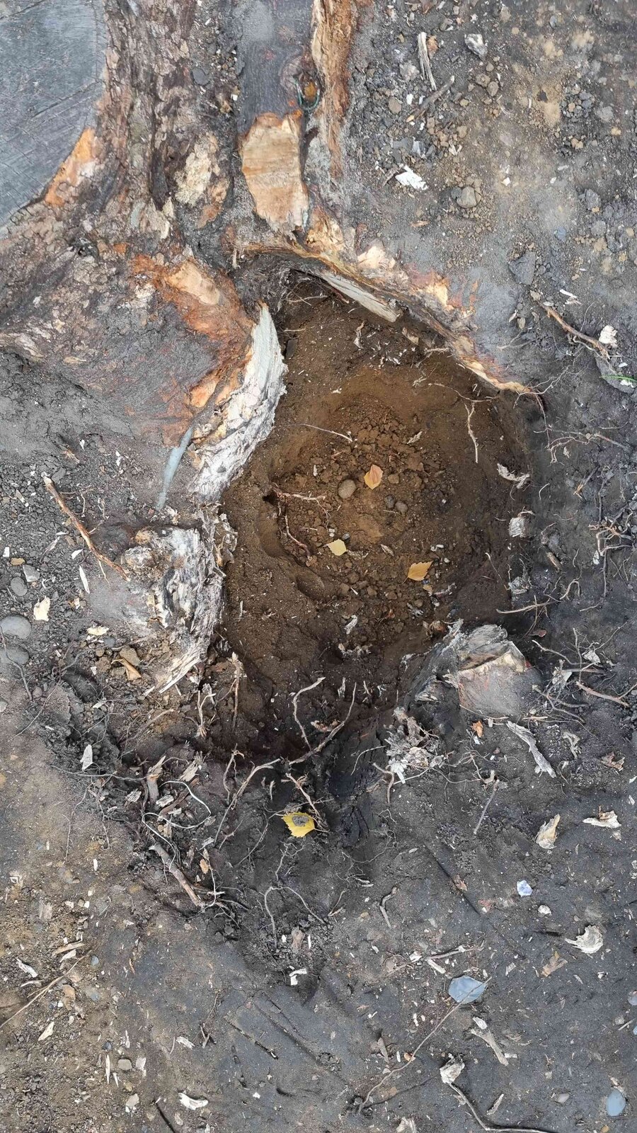

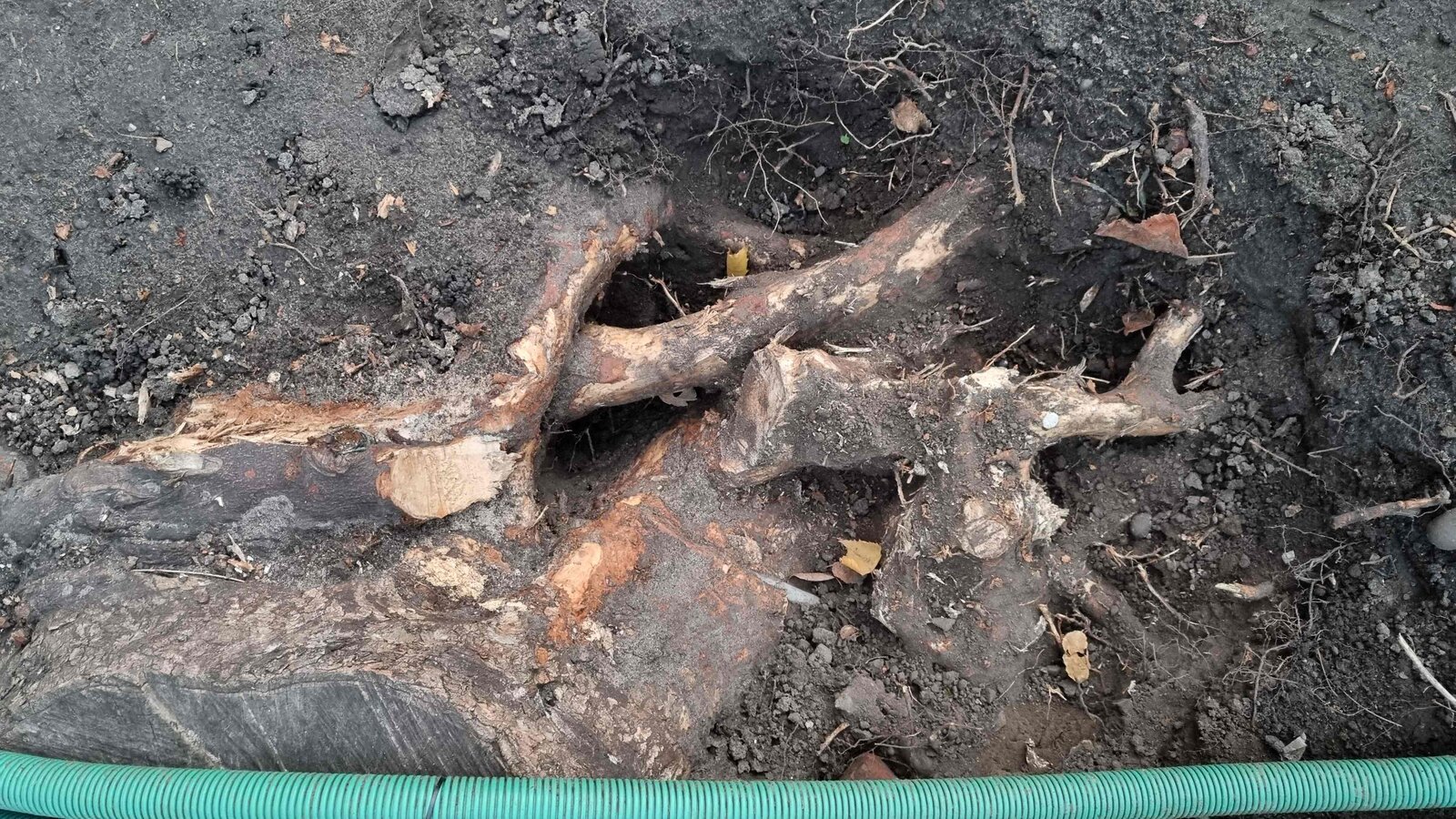

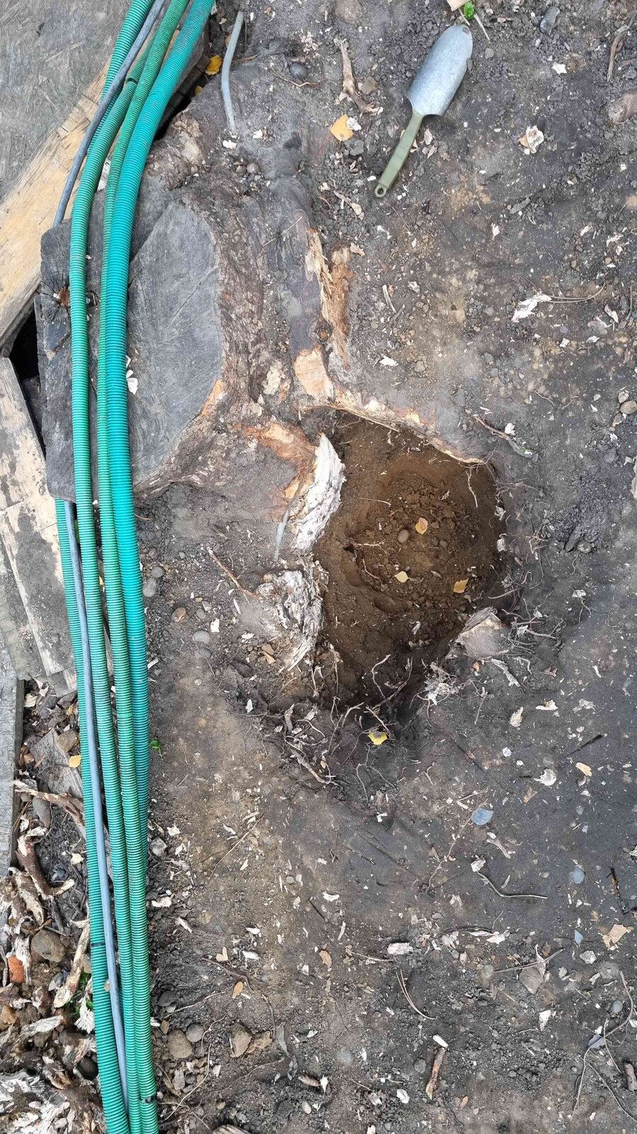

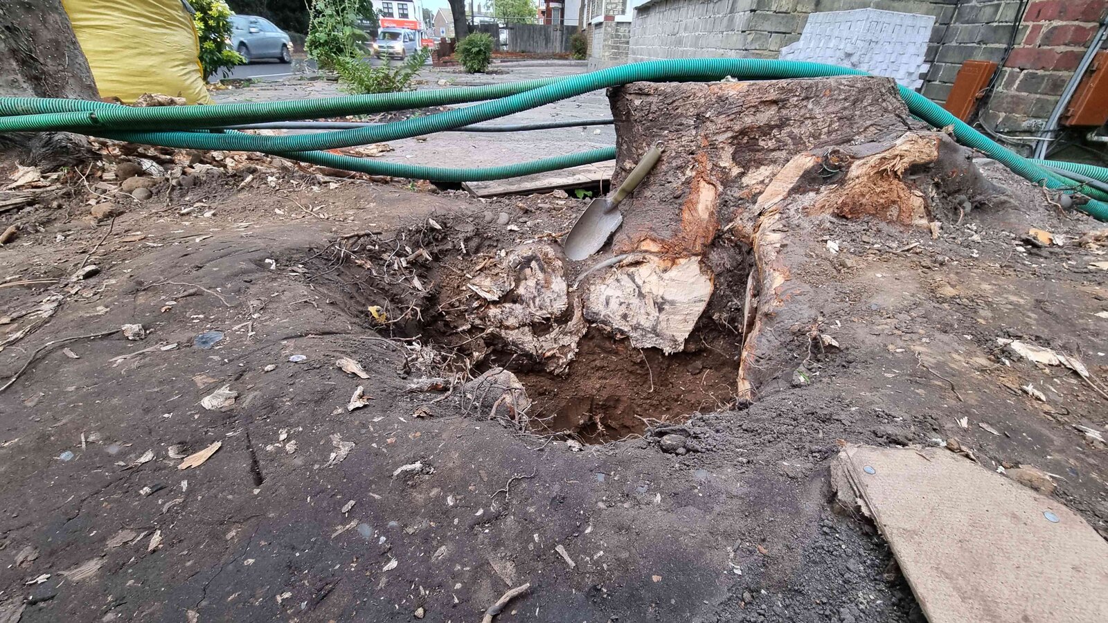

Thanks for your input all, none of you told me I was wasting my time, so I persevered and now it’s done.
I couldn’t see myself getting hold of a cut off saw although it would have been interesting to use, so I got a Roughneck 17lb Post-Hole Digger – pretty much what scbk suggested. Holy cow that bar gives you a work out.
Just some tips for whoever might read this post in the future:
The digger is basically 5ft long heavy bar with a chisel end 2½” across. It has an axe like cutting edge on its end but with around 8kg of weight behind it. The edge has what I understand to be a splitting axe or maul profile (nose cone of a V2 rocket shape but less pointy) rather than a wood chisel shape. This means that when cutting across the root grain, you need to put your back into it. I eventually discovered that if you hit the root in line with the grain, this tool is devastating. Hit roots both orientations in turn for substantial results.
I used a spearfishing technique with the bar after I’d got used to picking a target and being able to hit it (didn’t want to hit the BT cable). This is possible after practice because you are looking along the bar as you drive it in, whereas swinging an axe I think can be a bit wilder.
When faced with a load of big roots, clear all the soil off all the ones you can see, then start cutting them. Dig under roots you can see to get to know their structure and how they’re connected. You might see a root that looks like it’s really deep from top to bottom, but the chances are it’s not and it actually round. What you might see is a root that has a load of clay and pebbles packed underneath it. Remove this and the root will look a lot more capable of being cut. There is a lot of trowel work here but it’s worth it.
A baby 15” mattock is also invaluable to chip away soil and stones from the roots and a 4ft aligning pry bar to get where the mattock can’t go. To sum up, if you hit roots with a post hole digger long enough, they will give in. A stunning tool, but you will ache the next day : - )
