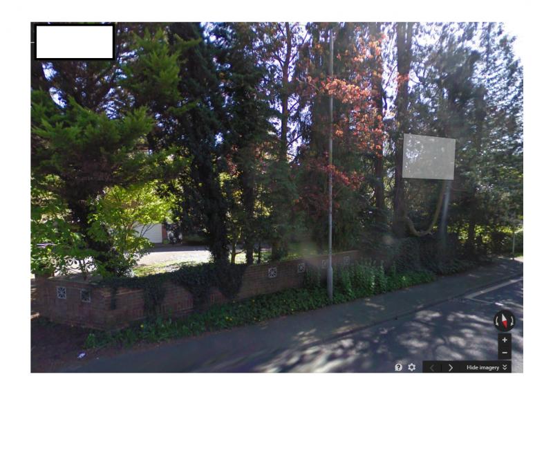

I've been reading with interest a lot of the topics in this area of the forum. Our issue is that the plot adjacent and behind us has full planning to demolish one detached and replace with three terraced and three new gardens along the boundary. In addition the plot adjacent and alongside (which was a hotel)has put in for planning for 56 retirement flats. We estimate the buildng works alone (since they're not done in parallel) will be at least two years.
So, we have decided that if we can't beat them we'll try and join them (much easier said than done!). Our plot is almost identical to the plot behind so we're thinking of broadly following the professional developer and building the same thing on our plot (three "townhouses").
Having done a lot of reading so far and probably still nowhere near enough, I'm thinking to go for outline permision first and once granted to use that to try and get interest from banks/builders/developers to either borrow the building costs or go into some kind of JV. If and when funds look promising, we'd get the plans drawn up professionally and secure full permission. I'm not sure if this is a good order of doing things or not.
So one question I have at the moment is should we fell some or all of the trees prior to submitting outline planning. I have noticed that both pro developers have cut down virtually all the trees prior to submitting their application. I'm afraid that if I didn't then the council would immediately slap TPOs on some of them making it difficult or impossible to build the town houses with enough parking, splays etc etc.
Now, unlike the plot behind who had several Oaks felled (real shame) we don't have any magnificent trees like that although we do have a really nice magnolia which is probably only about 20% visibile from the road and is right in the middle of the front of the house which would probably get in the way of parking requirements. There are also lots of conifers towards the front boundary and a few around the other boundaries.
I've attached a pic of the front showing the screening of the trees (magnolia is behind them). There is another house opposite the busy road but its well set back.
So sorry for the long question (I thought I'd set the scene as it were in case of follow-ups regarding the planning in general), and thanks for any comments or opinion.
The council won't necessarily slap TPOs on the trees because of the planning permission but they will probably add conditions to any grant of permission that the trees must be fenced off, protected during works and any that subsequently die in the 5 years following completion are replaced with new planting on some ratio between 1:1 and 1:4. If as part of your permission you stipulate trees will be removed then the council will likely ask you to replace them on some ratio if it's feasible within the plot boundaries. These are different to TPOs because they are only relevant for the duration of the works

Which side of the fence you fall on is up to you - but do consider that the trees may well have an enduring future value that can be aplus point when asking people to invest in you - you're building new houses, so are the two professionals either side. What are you going to do to your development to make it stand out/more saleable in a sudden rush of new housing in your immediate area?
OPP vs DPP in this case - I'd go for DPP; you're going to need accurate plans to get an idea of what it will cost and what it will realise. If you get DPP, it'd be worth having BR plans drawn too, as it makes pricing internal works easier and developers will prefer it. Essentially youre making a business case and noone will invest in a business that doesnt have a plan
