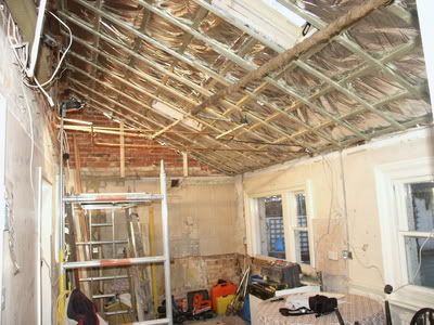

heres one I did earlier

I don't want to alarm you Jason but Your loft conversion looks like i settled - by 2 storeys!!! Isn't that trellising outside the window?
Seriouly I thought Tri-Iso was only good for loft conversions but not new roofs.

It's a single story "lean to" roof on an old Victorian Villa. The old ceiling was only 7ft so I opened it up to the rafters to get a better feeling of space.
before & after here
