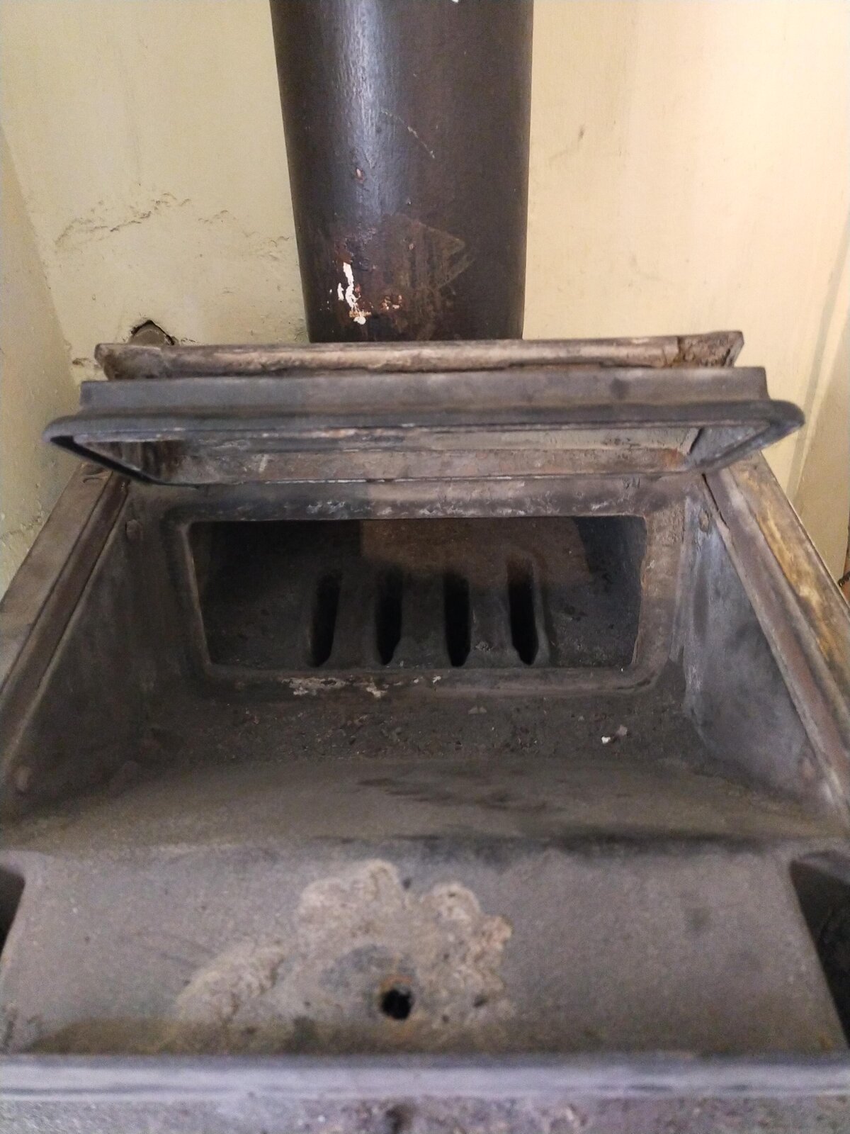

Good Morning all,
I have an old Trianco Boiler and recently the pipe has been getting very hot, almost too hot to touch. When I take the top cover off and lift the Draught/stab assembly I can see flames coming through the four vents. I am in the process of changing the stove ropes which I hope will solve the problem. The assembly moves freely. If that is not the issue and ideas what else I might have to consider.
Cheers
Paul
