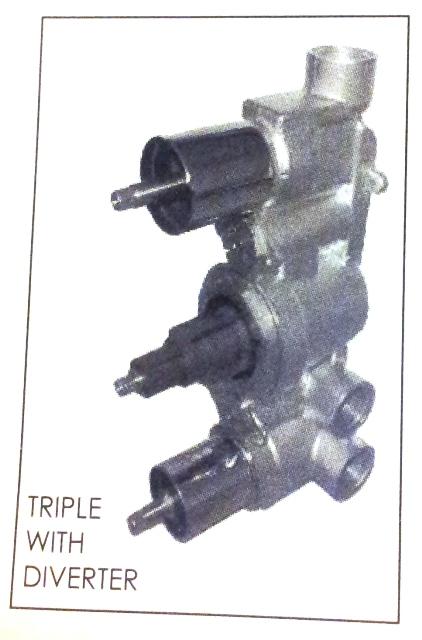

Hi helpful folk,
I apologise in advance for a long post. I'm at the end of my tether and really need your excellent expertise!
I've fitted a Victoria Plumb Matrix Triple Thermostatic Shower Valve with Diverter
(one of these http://www.victoriaplumb.com/Shower...es/Matrix-Triple-Valve-with-Diverter_908.html )
The hot and cold inlet connections are clearly marked on the body of the valve, but the outlets are not and having plumbed it as I'd thought was logical only the shower works. When I turn the diverter handle (the lower handle - top is on off, middle is hot/cold) nothing happens. The shower still runs in both diverter positions but no joy on filling the bath.
The valve came with two, contradictory sets of instructions, and online I downloaded a third set of instructions. All were pretty much useless as instead of showing which pipes went where it included helpful phrases like 'make the plumbing connections to the outlets'. It also had multiple illustrations of triple valves, none the same, none labelled, no help at all (nor in fact were Victoria Plumb customer services when I called, no surprise there!).
I've attached the only tiny illustration which matches my valve, but it only shows one side of it sadly, so imaginations at the ready while I describe what I've done ....
- the vertically exiting top outlet I've attached to the shower head,
- and the lowest one you can see I've connected to the bath filler,
- the middle one is marked as hot inlet,
- on the side you can't see there is a cold inlet at the top
- and another outlet at the bottom (ie parallel to the one I've connected to the bath filler. I assumed that the outlet at the bottom was for a body jet which I don't have, so I've just capped off an outlet pipe there.
I'm hoping that I've merely plumbed in outlets the wrong way round and that there's a simple solution. However I'm a simple kinda gal and can't work it out!
thanks all in advance,
Helen
The bottom outlet turns through 90 degrees from fully on to fully off, victoria plumbs instructions dont tell you that the bottom outlet also turns another 90 degrees opening and closing the other outlet, hope this makes sense ;)
Not only are you the speediest reply I've ever had, but you're bloody right too!!!!!
A massive rib-crushing e-hug of thanks to you Picasso! (well done on all those masterpieces too, excellent work).
Thankyou so, so much!
