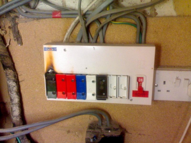

we moved into a house last year september obv there was a problem with the show our house is on the rcb but has the older fuse box the wire type but insted of wire it has the over size fuses at the min fitted with a 30amp one we got nearly a year out of it but it blew the other day the fuse was brittle and obv had alot of heat in it with what i have seen on google it could be a 9.5kw shower it has a copper twin and earth mutly strand wire but not sure on the mm feeding it.
i could change the fuse for a mcb.
im fairly sure there is nothing wrong with the shower had a look under the covers and had a good look and no bad conections or any elements blown or any water leaks
9.5kW is approximately 40A.
A 30A fuse will work for a while, but it will get hot and fail as you have discovered. A similar rated MCB won't help either, and to change the size of fuse/MCB may involve replacing the cable.
It is also likely that the fuseboard won't be suitable for fuses over 30A.

You must not just go increasing the size of fuses without knowing what you are doing.
What is the csa of the cable connected to the shower
what is the length of the run
where does the cable run (through the loft, in thermal insulation, etc etc)
Also, the old type fuseboards do not support fuses larger than 30amps otherwise this can happen

the fuse bored is the same as one in your pic only thing is it uses the enlarged plug type fuses but cant remember by what there called.

just spoke to sparky down the street and he came up looked at the cu and has said idealy it needs changing the cable to the shower is approx 6mm so not up to the job or just barely.
im going to change the two cu for a bigger cu with the rcd and then the mcb's but going to leave the shower of for the time being.
it needs the bigger cable re routing and poss the shower changing too.
