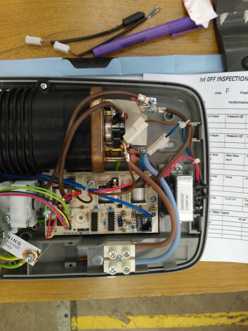

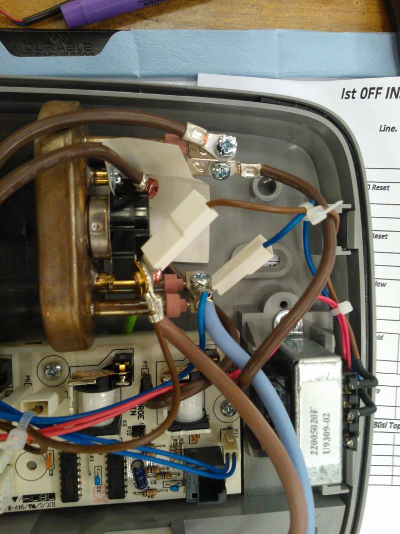

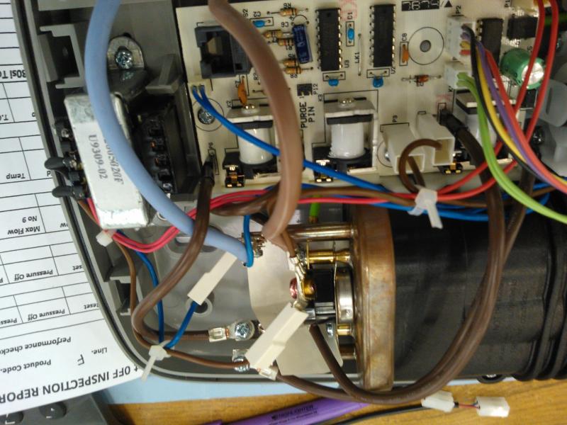

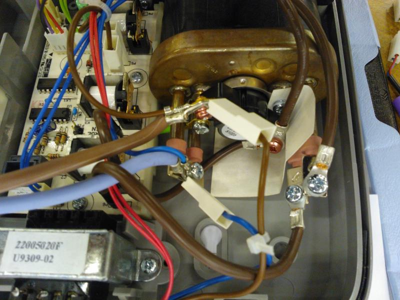

We have a Triton 300si where the heating can started leaking. My husband removed the can, BUT didn't make a note of the wiring connections to it.
I found one picture someone had posted some time back on this site, unfortunately it didn't clearly show all the connections.
Is there anyone out there that can post me a number of clear pictures showing the wiring to the heating can so I can have my shower working again.
Thanks in anticipation.
Thanks for the offer, and aplolgies for not replying sooner, I had problems trying to find what I had posted.
Anyway, we were sent some excellent photos of how the heating can is wired which I will try and upload.
