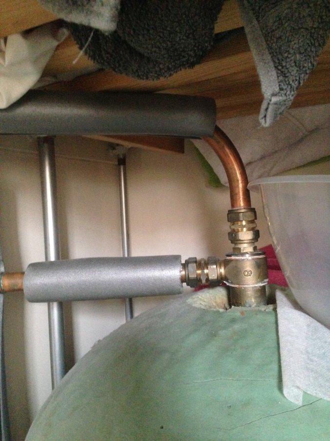

Hi all, I installed this shower in july and has been great up until a few weeks ago.
Its always whirld abit on startup as I assume its waiting for the hot water to arrive.
The problem has got worse up until the point where it can take 10 minutes to get the shower working.
It whirls like anything on startup and im having to move the dial from hot to cold to draw it in.
After I manage to get it working the shower can vary from being perfect to up and down flow rates.
Triton have come out and said he hasnt got a clue and thinks its air, hes marked the job as "inconclusive" o_O
I dont think its air being drawn in as I've put my hand over the vent pipe and nothing is beng sucked in.
Any suggestions please?

useally points to the shower being starved of water flow.
This shower don't have a thermostat. it controls water temp by the flow control valve ie temp dial.
How is the hot flow pipe connected to the cylinder, useally one of the most common mistakes i see on these showers.
I've tried to upload a picture from my iPhone. If it works it'll show the flange on the top of the tank.
The pipe on the top goes to the shower, the horizontal one on the left goes to the taps and everything else. Is this correct?

I've changed the feed to my shower today. Used an essex flange as I think the reason was trapped air coming from the hot water and not venting properly. It was feeding down the shower feed instead.
Will report back if the problem is fixed.
Tomo72: Your having the same problem, the air from the hot water rises straight past your vent/hot tap feed, and going to your shower feed.
The connections should be the other way round. Top=vent/Taps, Bottom=Shower feed.
Yes, definitely sounds like the Surrey's connections are the wrong way around. Pump will be sucking air like a good 'un.
As shown in the pic your vent needs to be off the top outlet not the side outlet.
I think changing just the vent to the top outlet will be quite difficult. Could we just swap the two outlets that are there over?
