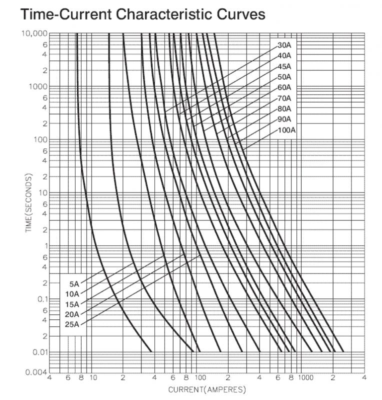

I'm considering one for our staff bathroom, if it's a good thing and am wondering how you manage the potential for blowing the main fuse.
We have another 9kw appliance (an autoclave) which is run intermittently but the same situation could exist in a house with another electric shower in another bathroom.

I don't understand why the fuse wouldn't blow straight away if we exceeded it's rating. Can you explain why the fuse would survive a few minutes.
