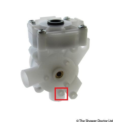

Hi everyone,
I've used this forum many a time to solve my problems but this is the first time I've had to actually post a message asking for me, go easy.
My mum, bless her, has a triton t300si remote shower, which use to have a ridiculous amount of pressure. Recently it got the dreaded low pressure light flashing, apparently the main cause of this is the solenoid. So I replaced this and it now works again.
BUT...
Now there is a leak, I'm not talking a few drops here but a constant stream of water when the shower is running, nothing when the power is on but not running.

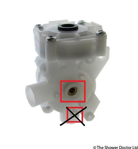

The inside of the shower case doesnt show any signs of previous leakage and the leak is coming from the Stabilising Valve assembly unit. On the side at the bottom of the SVA is a small hole that looks like it should have a screw in it, thats where the leak is, see pic below.
Can anyone tell me why its suddenly started leaking through this hole, and if there is anyway to fix it.
Thanks a million
alex
[/img]
Update,

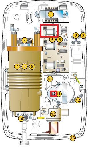

I've been investigating a bit more this morning, I turned the pressure down and found that the water isnt actually coming from the stabilising assembly. So I took the stepper motor off and turned the electric on. The stepper motor turns(as it should) but the water actually comes from where the stepper motor inserts into the stabilising assembly. So my conculsion is I do need to buy a new stbilising assembly.
BUT...
there is always a but,
A few seconds after I turned the shower on, the top transformer sparked and then again a few seconds after that. The shower continued to work/leak until I turned it off(a few more seconds).
Are the transformers linked to a cut out or something, am I gonna have to buy a new pcb?
I've marked on the pic where the leak is and where the spark came from.
any advice is welcome
alex
Thats a relay not a tranformer.
don't worry about the spark off the relay but fit a new stabiliser valve.
it's not an uncommon fault on these.

easy to fit just isolate water supply remove inlet pipe.
remove 11 then 13 then 10 will come out

I purchased a new stabiliser valve assembly and fitted it tonight.Here's my guide to replacing it.
Turn off water, turn off electric.
See previous post for picture of shower unit with numbers
Unplug No11 from circuit board
Unplug the remote cable (top right of circuit board)
Remove screws at top and bottom of No11 and put to the side, note dont loose the 2 white caps that go between No11 and No10.
Remove screws from circuit board (top and left side on mine), leave the circuit board where it is. It should move a bit.
Remove the screw on No10 (on right hand side)
Remove the screws either side of No13
Unplug earth pin at No14.
For No10 to come out it needs to move right and up.
Gentle wiggle No13 downwards and pull No10 slightly up and right. For me No13 came off 1st,I then pulled a bit more right and it came off the heating element (7,8,9).
Before you put the new No10 in, align the pin from No11 so it sits correctly together.
Lastly, on top of the old No10 is a plastic flap, remove it and put on the new No10.
Thats half way.
No follow every thing in reverse. It looks more daunting than it actually is.
