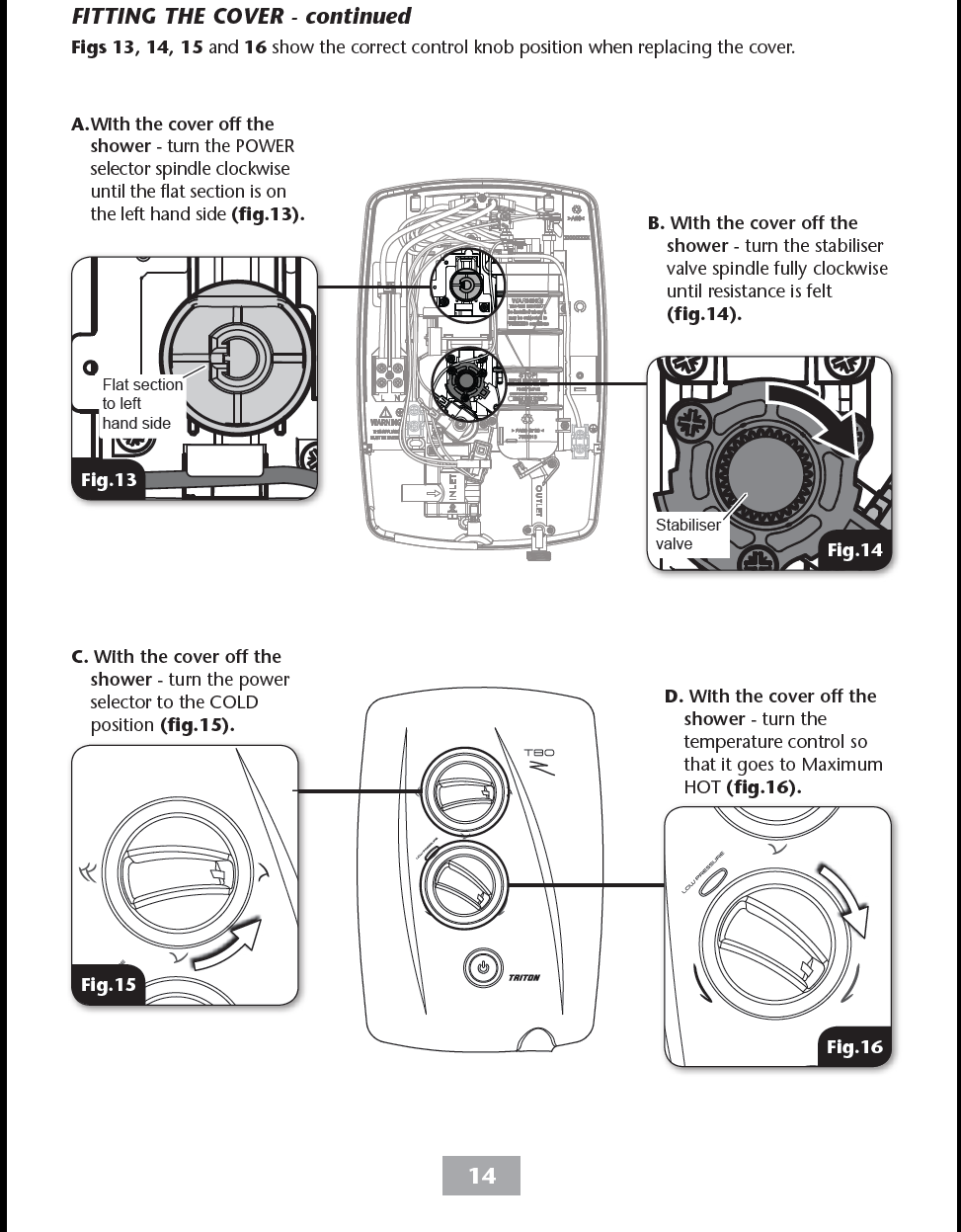

If its allways behaved this way check or get checked that the cover is installed properly.
Thanks for the replies. This has only started happening recently, in the last few weeks. Pressure is fine, I've checked the inlet filter and it is clear, no sign of debris at all. The cover is fitted correctly with the dials in the correct place, once it does get going it works correctly, temperature is correct and flow is fine. I've also removed the hose to rule out any issues with that.

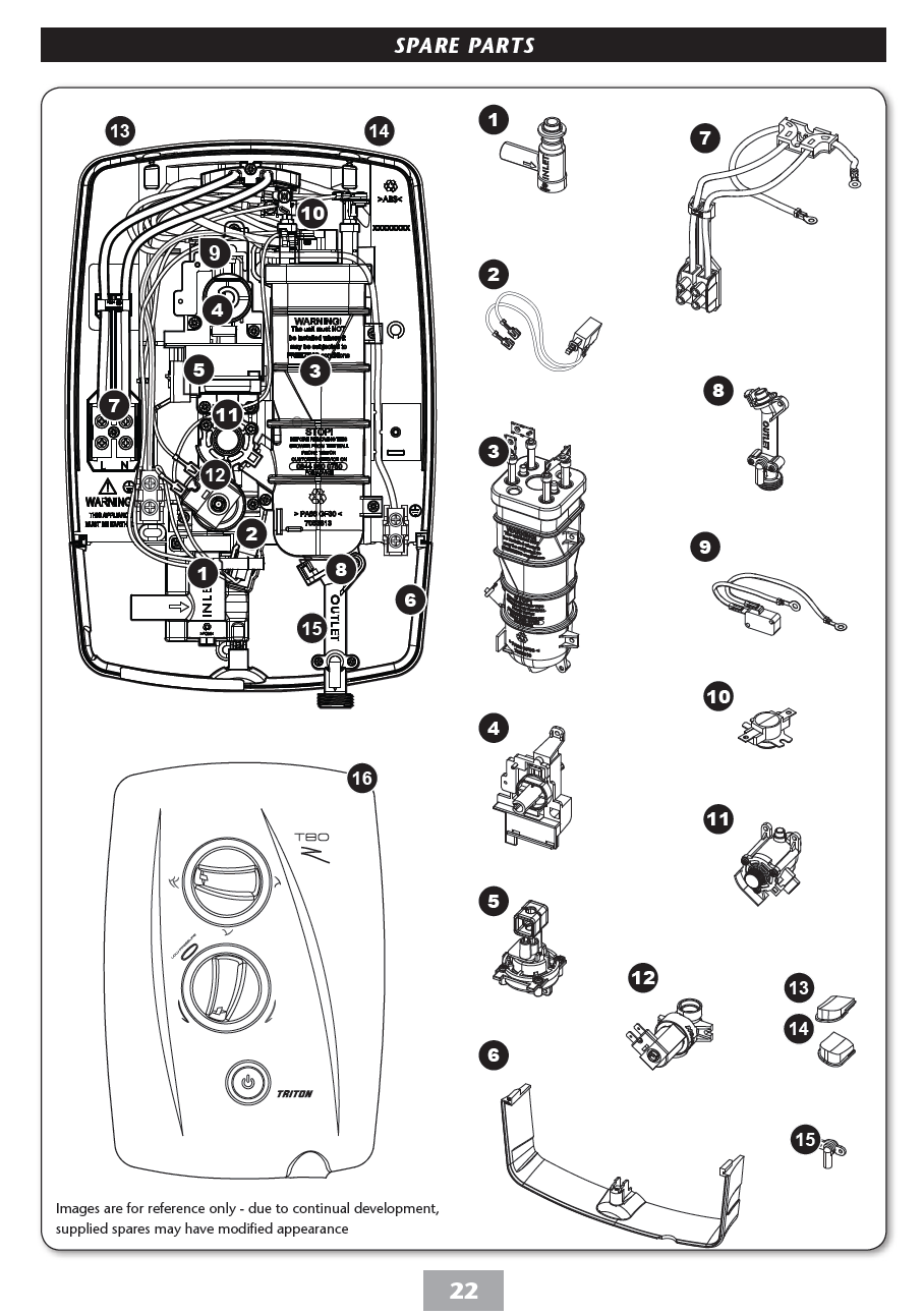

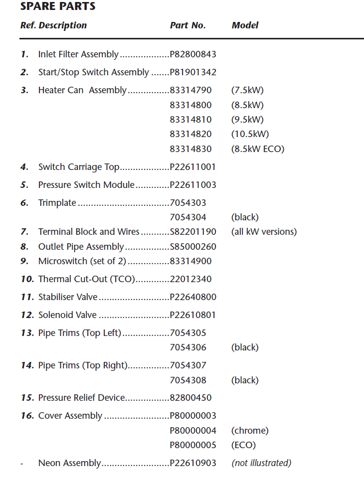

Could be the solenoid, on my old Mira Sport a diaphragm operated "pressure" switch pused on two levers, one for each micro switch, one of which, when you turned the power selector switch to I or eco or something like that did not engage its micro switch, it also had a low pressure LED if the other (main) micro switch didn't get pushed up. My fast fit has a "semaphore" type red flag that appears in the cover if pressure/flow problems, I presume the micro switches are operated similarly but the spares shows a separate pressure switch, item 5, not sure what this does, maybe pushes on the micro switches or just operates the semaphore?.

Happy to report that after a bit of a false start with a knock off Amazon part that didn’t fit, a proper solenoid valve was ordered, fitted and works like a charm.
