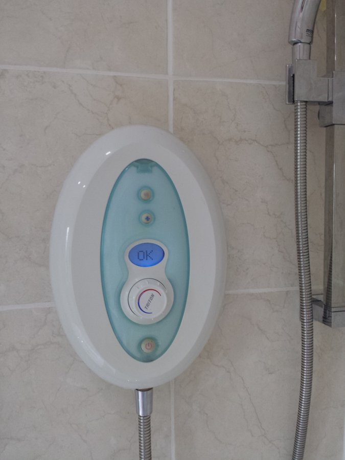

Hello
I got Triton Topaz T100si
Few month ago replaced coil when outed all parts together and started
teperature control didn't work max you could set is 38c'
after switching off/on everything got back as it was and worked superb
few days ago pressure controller started leaking i replaced
and same thing happened with temperature max 38c'
pressed top button to eco then back to full
started working temp from 30c' up to 52c'
turned off/on same max 38c' even if you tun on max
any one knows what part could cos this problem
as i don't whant to change all parts one by one
One more thing to add its just started doing now
After finish with shower and pressing off button shower still heating water inside screen says OK when you turn off
and even shower is off water starting to come from shower head and after while turns off saying LP low pressure
Thanks in advance for your answers
