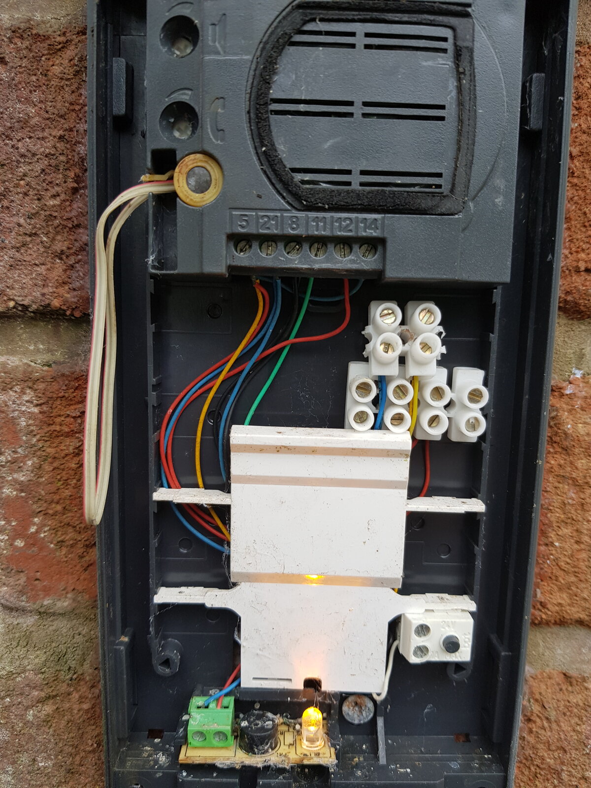

Post picture of entry panel outside ...when you press the button outside BPT panels give a ring tone when you press the call button
I've just worked out what you meant - when you press the buzzer at the entry panel, can you hear it AT THE ENTRY PANEL itself? Pure genius! That just hadn't occurred to me at all.

Not only is there no voice audio coming from the entry panel, but you can't hear the buzzer when the button is pressed. So it's very likely that the problem is at the entry panel side, not the receiver unit.
Do you still think I should measure the speaker impedance, or is the problem sufficiently narrowed down to the HA/200?
The picture you requested: HA/200 inside a Targha entry panel.
Yeah, I checked the speaker resistance and it's reading "over the range", so I suppose it's blown.

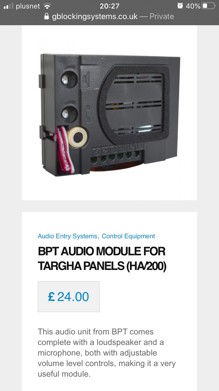

I've seen a new HA/200 on the net for £40 (see picture), which I'm willing to buy, but I'm wondering whether this is the time to upgrade to a video intercom.... BUT, I would only do this if I could reuse the existing wiring (this goes under the drive, and there would be no way to pull new wiring through, and I'm not going to dig up the drive).
The info on the BPT website doesn't make it clear - do any of their video intercom systems work with four wires? (Or, for that matter, video intercom systems from other companies)?

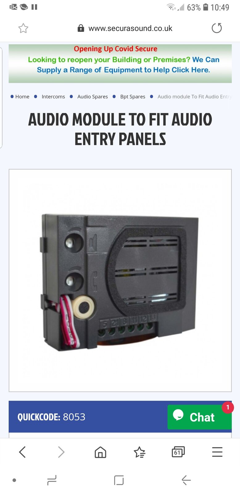

No matter - I'll stick with the audio only. Is £40 about right for a new HA/200?
