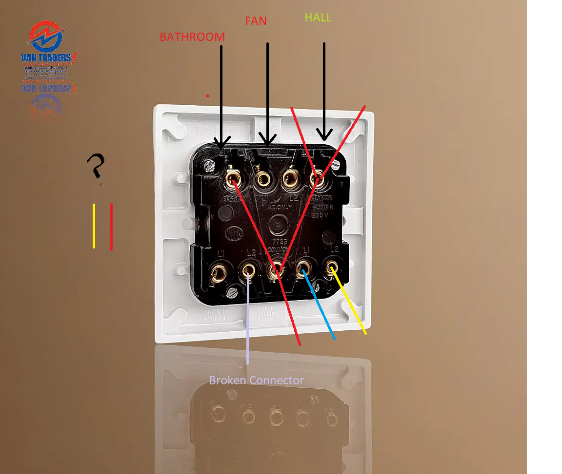

Hi, I have a 3 gang light switch outside my bathroom, 2 of the switches don't seem to working, 1 which I broke when investigating the other.
I was trying to see the current wiring setup of the bathroom fan, that's hasn't worked since I moved into the property.

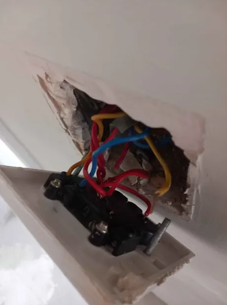

Upon removing the socket to look at the wiring, when I re-attached it again, the bathroom light stopped working. I noticed there were two connections that were loose but wasn't sure where they should be placed.
I have a yellow cable and a red cable that are loose within the socket, I don't suppose anyone knows where they should match up?
The red cable looks really short, would I be okay with using a Wago and a short link (red) cable to get it where it needs to be?
I also noticed there was a metal wire not attached to anything within A L2, but not sure if that has any relevance. Both the bathroom and fan are not working, the hall light works fine. The yellow and blue are in C L1 and C L2 respectively
Note that in the 2nd photo, it looks upside down to what I have drawn on a stock image I have found, but I can confirm that in my diagram, it is TOP at the top, its just that the common is reversed in my model
It should be noted that the Hall can also be controlled using another light switch, all switches appear to turn the light on/off fine

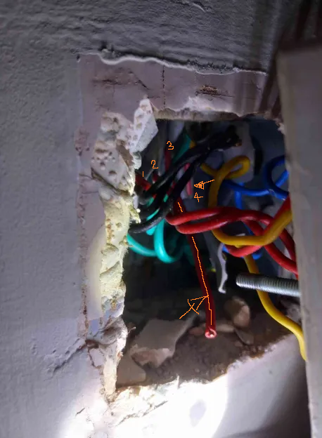

You are going to have to tell us which wires are together in separate cables! I suppose that you have two cables with 2 cores plus earth (red and blue) and one cable with 3 cores plus earth. Red yellow and blue.
Please identify and we may have a chance to resolve the puzzle!
The other red is much more tricky, I really am struggling to find what cable it is attached two.
1 appears to be in a cable alongside a green and black
2 appears to be in a cable alongside another green and black
3 I can't even see that being alongside anything else, I think it could be solitary (this was the one I was referring to in my original post)
4 I've noticed that the 4th red, another unconnected cable, is just within its grey sleeving, which appears to be another 3 core and earth not doing anything at all
Regarding 4 ,which you think is a 3 core and earth, how is the yellow,the blue,and the earth conductor from that cable terminated ,or connected to ?
For that one, thats the cable where the blue is connected to C1, yellow connected to C2. The red not connected to anything and is barely visible from its grey sleeving.
For the yellow that's hanging loose. It's blue cable is in a connector with 3 black cables. The red in b com
If I have correctly understood ,you have one red and one yellow that appear to have come adrift from the switches,(the copper wire appears to have snapped off the red one), is the piece that's snapped off still clamped within one of the switches terminals , possibly the bathroom switch ?
So I put the loose red into A L1 and the bathroom light now works, so I guess that was switched live. It was previously in A L2 I think where the copper broke off, but I think its because in my investigation I've rotated the light switch 180 so top was correctly facing, but the bathroom and hall switches have reversed also, and I can see why they might have done that in retrospect. Happy as it is now tho.

I'm thinking the yellow might also be a switched live, that could go into B L1 or B L2 for the fan as a "fan isolation switch", but I'm also of the impression that there must be a connection from the bathroom light to the extractor fan so that it comes on when the light does (so in my head I think there's 2 missing cables, rather than just the 1, but absolutely, only 1 is free and available in there).
