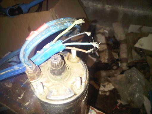

Unfortunately, the Lowara motors are only supplied with a short lead, so the connection to the power supply is in the well. At this time, I believe the connection is water tight.

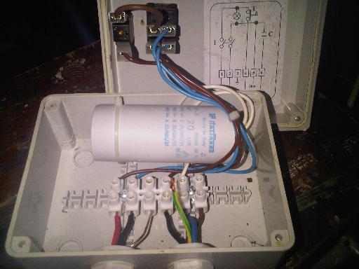

Images as follows:
1. 2. 3. 4.
The thermal trip switch is to the left of the main switch in the first picture. The red switch does light up when power is going through.
Thanks!
The pump should be changed with that top capacitor box.
You don't have a three phase pump, it is single phase, but it's capacitor (as with all bore hole pumps) is mounted in the control box and not in the pump - this is more for maintenance purposes than anything else. The capacitors fail and require replacement ocasionally. The capacitor and trip will be sized to the pump they correspond to.
The pumps are matched to the top box and should not be interchanged (due to their ratings).
Also ensure pump is rotating in the correct direction. If not you will have to change over either the run winding leads or the start winding leads but NOT both sets. If you have a multi-meter the start winding will have the higher resistance.

Could actually have been both - when extracting the old pump I found the remains of a rat skeleton at the intake for the pump (will teach me to make sure the well hole is covered in future!). Am assuming a bone has been sucked into the pump itself and jammed it as the pump was quite hard to turn manually. However, if the pump did jam, guessing the motor would have thrown the thermal trip. I do know that when I re-wired this motor on the surface, it tripped the power and not the thermal switch - so guessed it's fried itself - somehow.

presumably the motor is sealed with it being in a borehole pump (not had experience of these, so an assumption here) otherwise a strip and clean would probably solve it.

For what they cost,I would replace that capacitor and see where you go from there.Can you borrow a 'tongtester'?,current readings would be far more useful as a diagnostic.

Why is the ground wire in the panel disconnected?.
