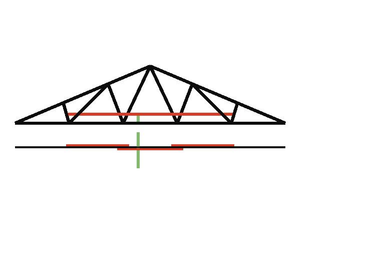

I know this has come up a few times, but from the threads I've read, I've not seen my particular idea mentioned.

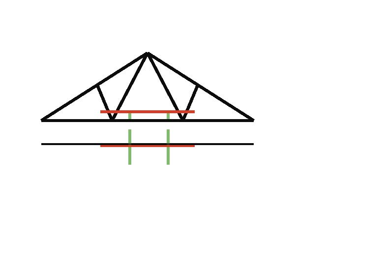

There's two different properties under consideration. First is a house I own, the other is a bungalow that a colleague at work has just bought. I've been helping the guy at work with some stuff - poor chap, his father wasn't into DIY so he's "lost without map or compass" and the mercy of the good local tradesmen (or in some cases, not so good - one quoted £500 to replace the fuseboard with CU as a pre-requisite before they'd fit a new bathroom :eek:).
So in this bungalow, it's been fitted out with an extra 8" of fibreglass (on top of a few inches of original fibreglass) - I assume under one of those free schemes for pensioners. It's made getting about in the loft a right pain, and that gets me back to the subject. There's f****-all storage in the place other than the loft, so logically it should be part boarded. He'll be limited in what he can put up there by the size of the small hatch !
My house needs more insulation (it's just got 4" fibreglass at the moment), and it is similarly lacking in storage space.
I was thinking about gluing & screwing some extra joists to the truss "uprights" parallel to the existing ceiling joists - with the tops high enough to leave room for the insulation (10 to 12" from the ceiling ?). Doing it this way I was trying to avoid putting any load on the original joists and flexing/cracking the ceilings.
In both cases, I think the trusses are at about 2' centres.
In my house there's just a "W" - ie from the apex the hangers come down and back up once on each side, and the central span is about 8' at ceiling level (about 24' overall span). I reckon I could get longer joists (say 10 to 12') in so I could span this in one go and attach the new joists to all the hangers as shown in red. There are built in wardrobes underneath, so half has a stud wall one side, half has a stud wall the other side - so I could add cross joists (planks on edge) to take support from these as shown in green.
In my mates bungalow it is a "WW", with the existing joists covering about 30' in 5x6' spans. I was thinking in terms of boarding it to make the central span usable for a "chimpanzee walk", with the span either side forming storage spaces. Without taking a few rows of tiles off the roof, there's no way to get 18' timbers in, so it would have to be 3x6' lengths - or more likley 3x7' or so and overlap them as shown in red on this diagram.
Over part of the area, there is a block wall underneath that could provide support - towards one end of the central span. So there is scope for adding a cross joist (or more like a plank on edge) as shown in green.
So :
Does this make sense ?
What size timber for the extra joists ?
What should I use for the flooring ?
Anything I've missed ?

The way roof timbers are designed and fitted, they rely on the weight of the roof to stress the joists, pulling them outwards, holding them like a violin string, as such they are able to carry quite high loads.
