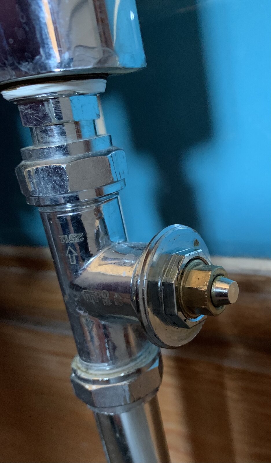

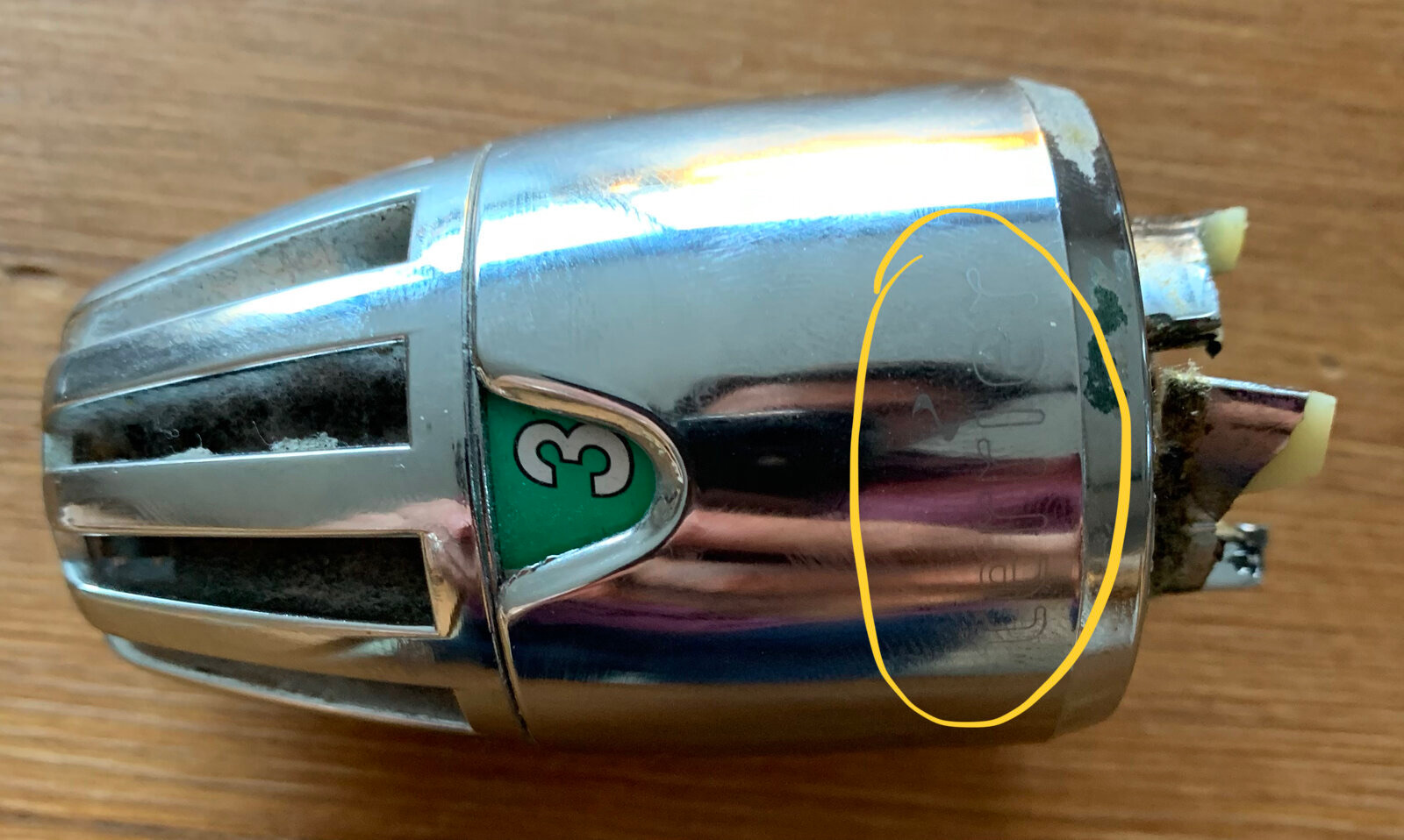

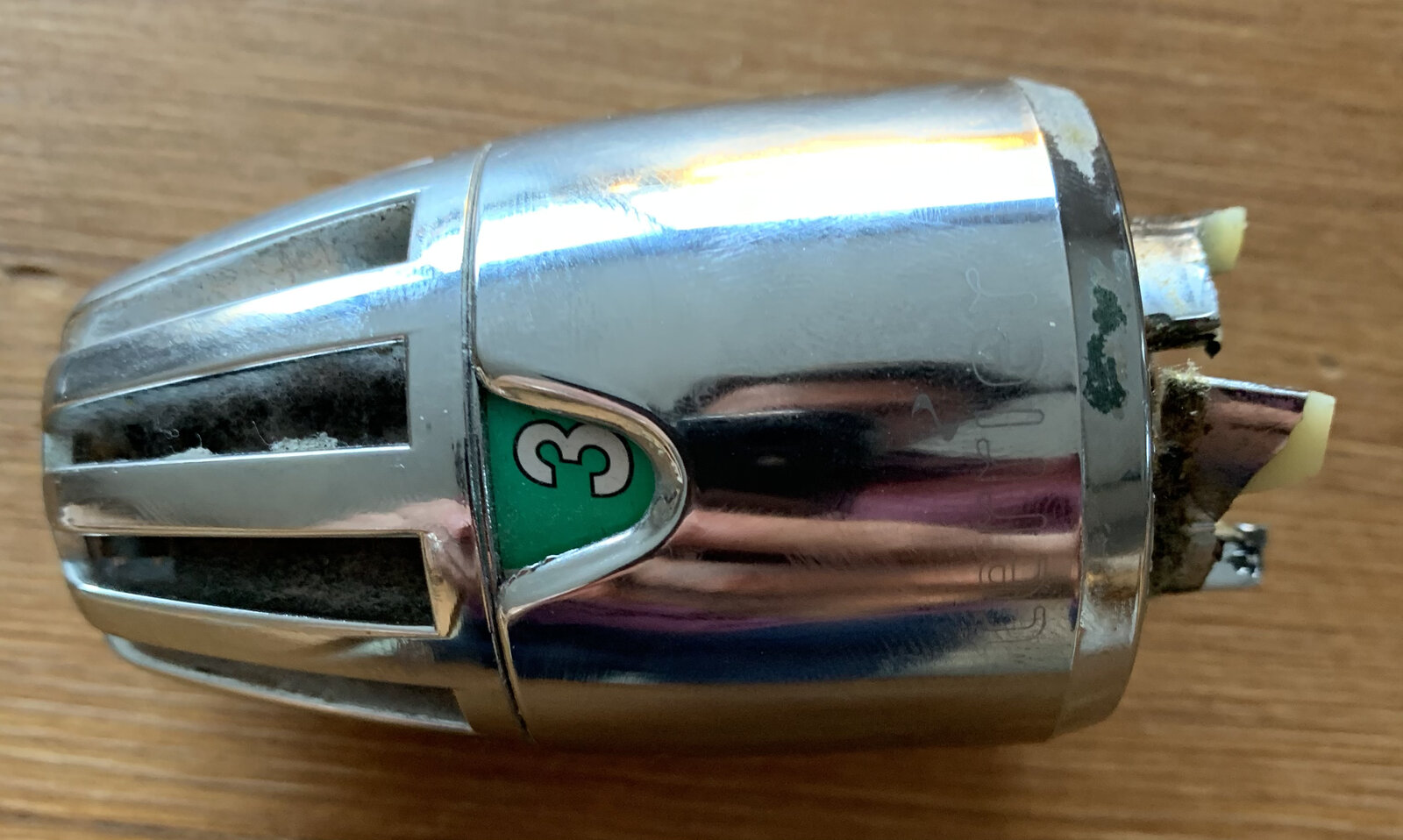

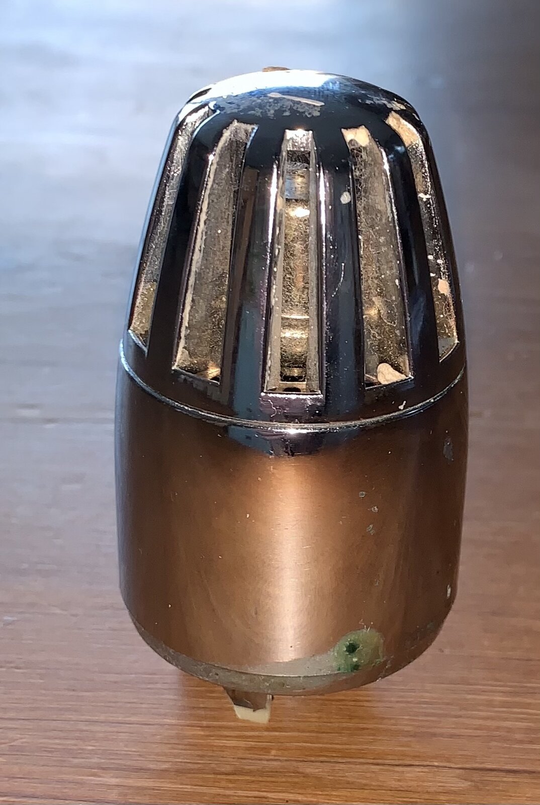

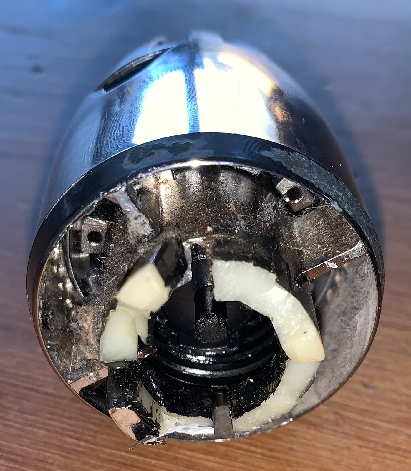

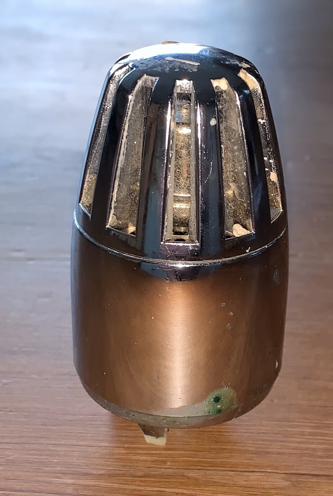

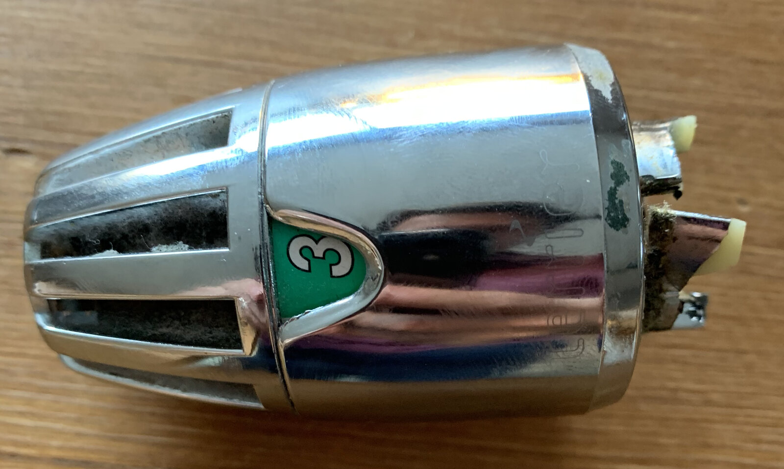

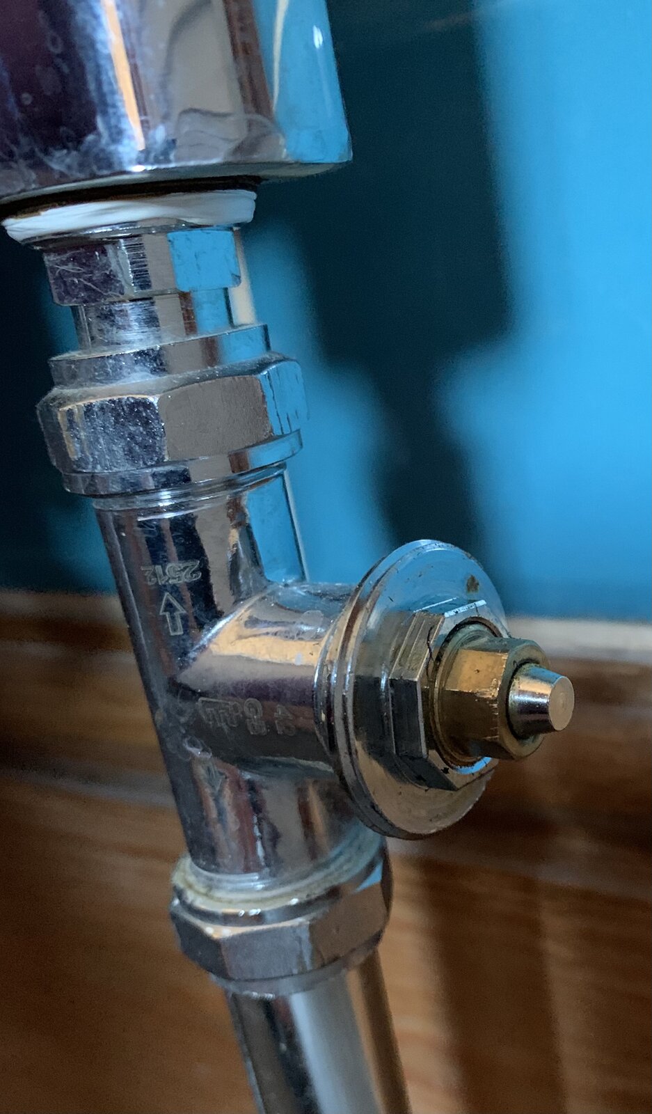

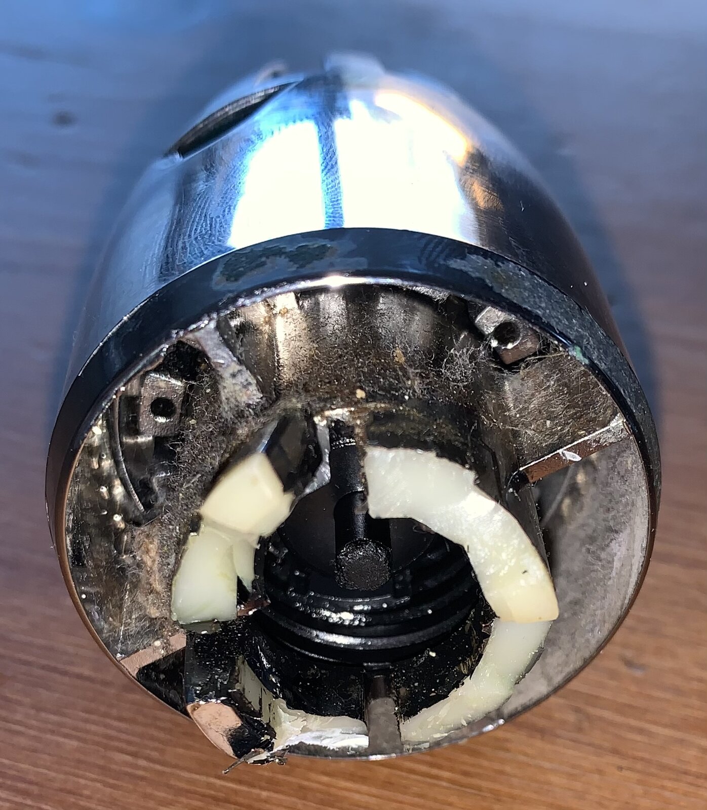

Hi all, Just bought a new house and the TRV head on one of the towel rails snapped off. There are no markings or brands on the towel rail or the TRV head, all I know that it’s 30mm, but the (forgive my lack of knowledge) inner hexagon that the TRV head uses to stop spinning is small on the TRV compared to TRV heads that I’ve looked at... I’ve attached some pictures, any ideas on what TRV head I need to purchase?
Thanks in advance.

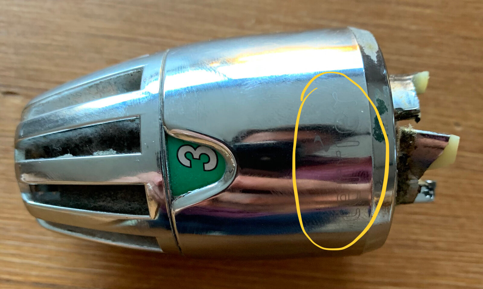

It’s a pegler terrier trv, valves are still available, but you usually have to purchase a valve for the head.
now you have good eyesight, I didn’t see the blindingly obvious logo Mark... thanks for pointing me in the right direction. Looks like screw fix has a replacement head on its own.
