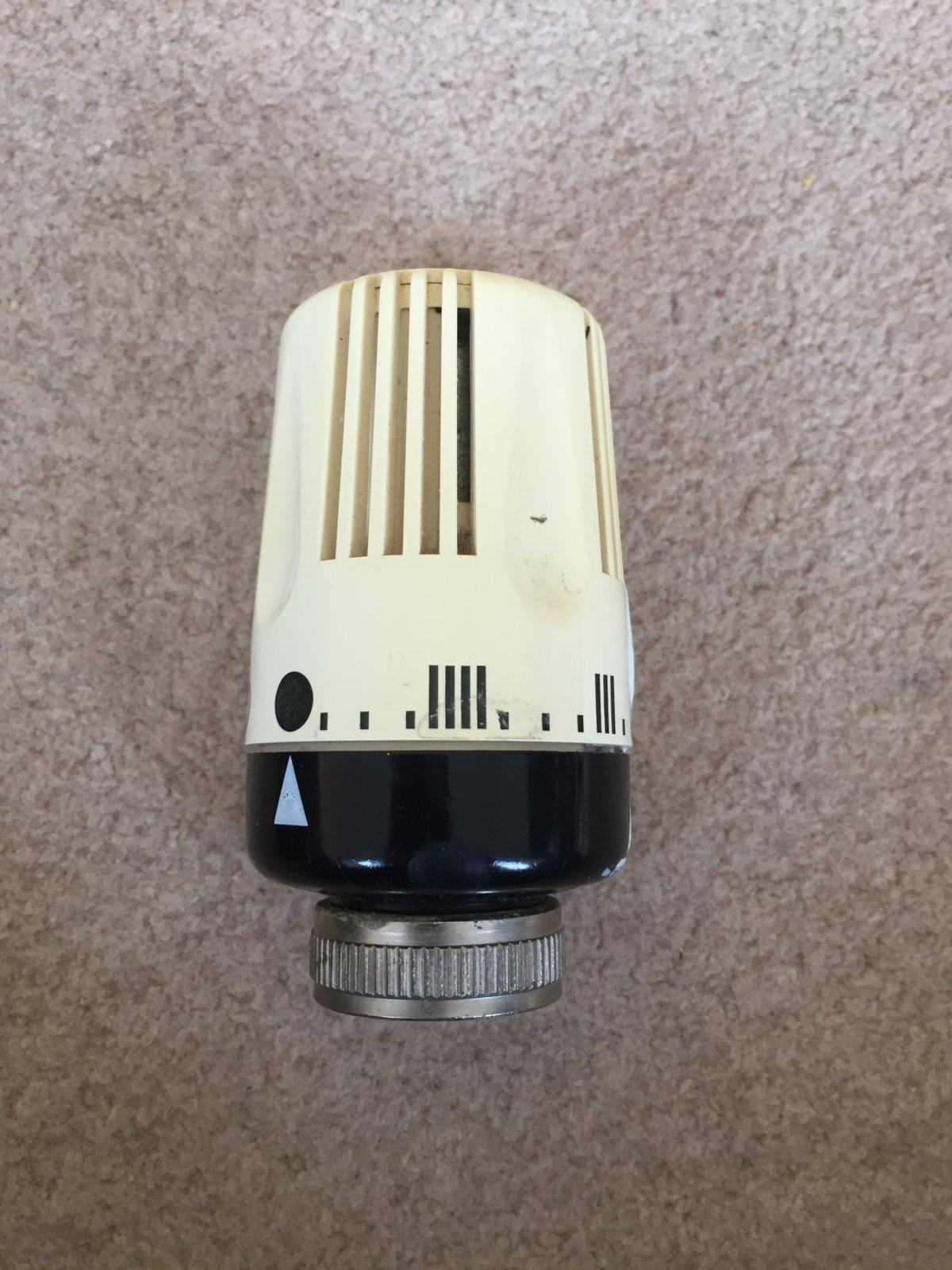

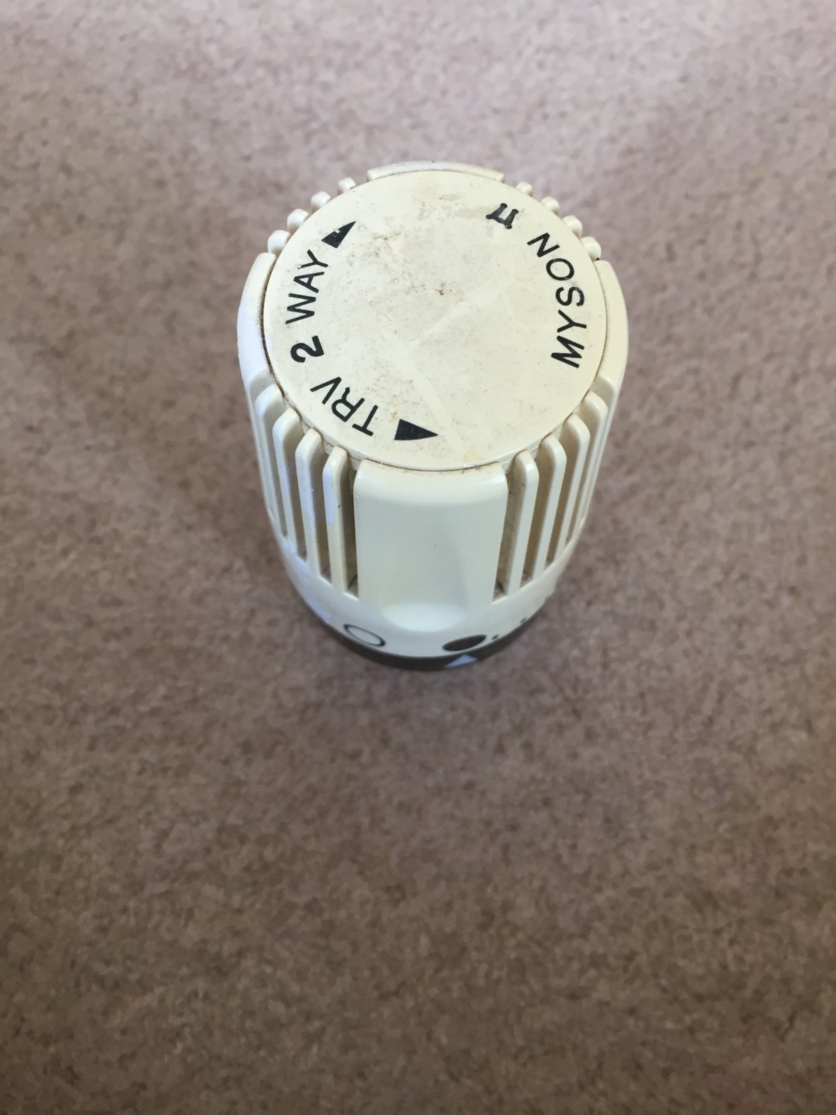

Hi
I currently have Myson TRV heads fitted on my radiators and a few of them have stopped working.
Can anyone pls advice if you can replace them with another brand or does it have to be a Myson brand only?
I have been offered Drayton ET30 heads (haven’t bought them yet), will they fit?
Thank you.
You're going to need to be a bit more specific than "Myson heads". Myson have made a lot of different heads over the years. A couple of photos would help
Photos attached
