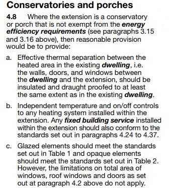

A quick search turned up the latest info including 2018 amendments, and it still says in 4.8b that the conservatory should have independent temperature and on/off controls to the rest of the dwelling.
Independent on-off controls. No mention of timer. A Myson has on-off switches and a thermostat. A radiator can be fitted as long as it is fed via a zone valve.
In most homes the on/off control is provided by a programmer / timeswitch. If you achieve on/off control another way that would comply, provided it was 'independent' from the main house.

I have the impression the BCO never understood it - not uncommon. There is no mention of independent timer control in the pic you posted, I have reposted it below. Only mentioning independent on-off and temp controls. On-off can be a manual switch. Reading it, a Myson, which has integrated temp and on-off control would do. Unless there are some other paragraphs that override that.
2-jpg.153414
It is obvious they do not want the heating to be on in the conservatory all the time the main heating system is on. A Myson gives that control in that heat is not sent to the conservatory by throwing a switch. Switch it off and no heat - simple. It also stops the conservatory overheating with its thermostat.
