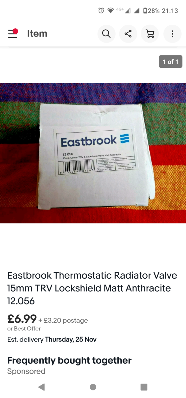

It's anthracite (isn't everything these days). I went to eBay for a standard set when this popped up:
Retails for £45 upwards so it's now going to be TRV'd whether it needs it or not.
The bathroom is small, well insulated, one external wall and no windows so I was a little worried that it would be overheated even with just the towel rad. I would like to think it would be covered with towels but my kids think you just chuck them in the corner of your bedroom to dry them!
