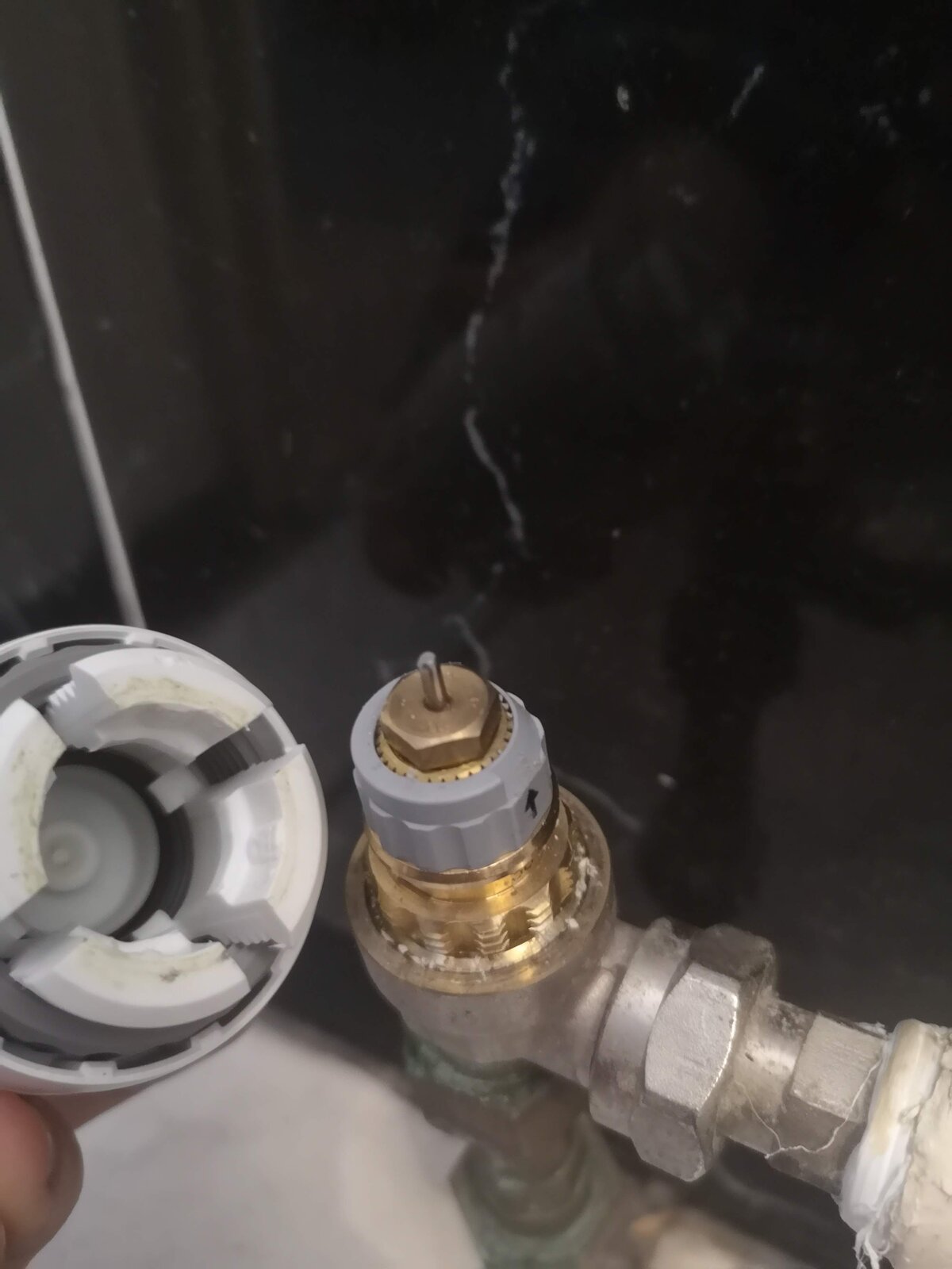

Oh and lastly.. we've got these weird TRV heads that seem to have an adapter fitted to them. They have a collar that you spin to loosen-up a clamp then you just pull them off. Rather than them being screwed straight to the body.. one of those is one that the pin barely moves in. It also seems to be turnable as well. The pin seems to be coming through a hex that can be used to turn the flow on / off. Could it be that these used to be on/off hand valves, that are poorly adapted to TRV heads?

Oh, and we have the horizontal one in the downstairs room (last photo). This is the radiator that's putting up a fight in terms of getting warm. It looks like a balancing issue. I broke the head on this and bought a new Drayton one to fit it last week, after we took the radiator outside to hose through it. It has a different thread size to almost all the others in the house. This one doesn't have any head-to-body connection (i.e. no pin-contact) above '4'.. even though the dial goes up to '6'. This horizontal one looks like the body/valve would have to be replaced with a Pegler B4451 if it needed changing. I can't see any other horizontal ones available.
The last one sounds like danfoss ras-c2.
Yes you're correct. They're certainly Danfoss anyway.

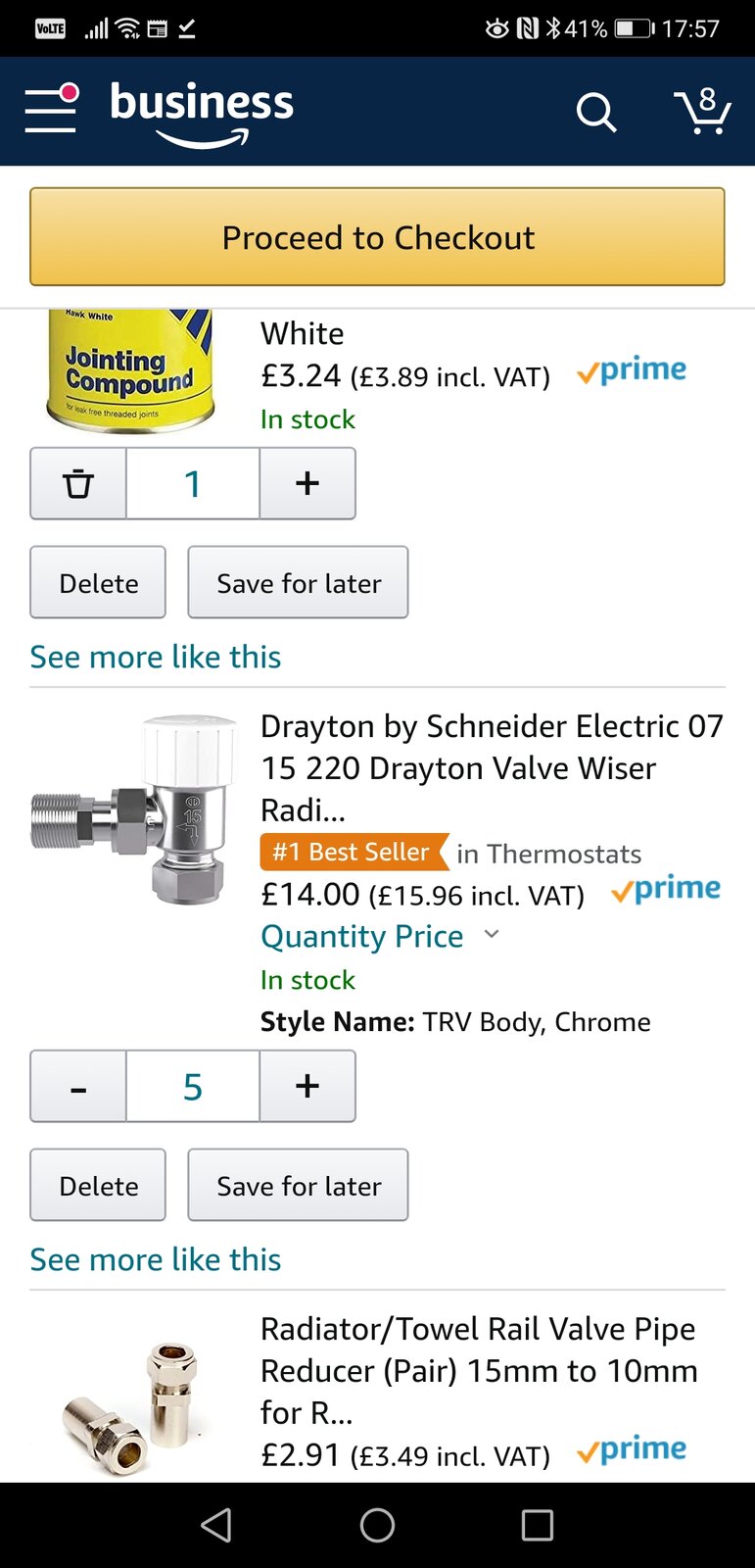

Oh by the way, I found that Drayton are selling the body-only, to go with the Wiser heads. The plastic cap on them made me mistake them for locksheild valves. So they are suitable for almost all of my radiators except for the horizontal-head one, and possibly the smaller-pipe-fed ones (there are a couple of those).
It isnt a horizontal one, it has been installed Horizontally, can easily be installed vertically
The TRV head is in-line with the radiator output. They're usually 90 degrees to eachother aren't they?
Normally easily changed, have you got a photo of this one?
So I guess that the flow lines (denoted with the arrows) can be flipped by unscrewing the fitting, so that the rad inlet can be moved?

no you simply turn the grey plastic collar 1/4 turn, no tools needed , hardly a chore , you are looking for a problem that doesnt exist
Think there may just be a simple language barrier here, but thanks all the same.
OK will do it in English, you see that little arrow pointing upwards ? that means that the valve SHOULD be on the flow, if you turn it then the arrow will point downwards meaning it should now be on the return, tell me if you want the explanation in another language
