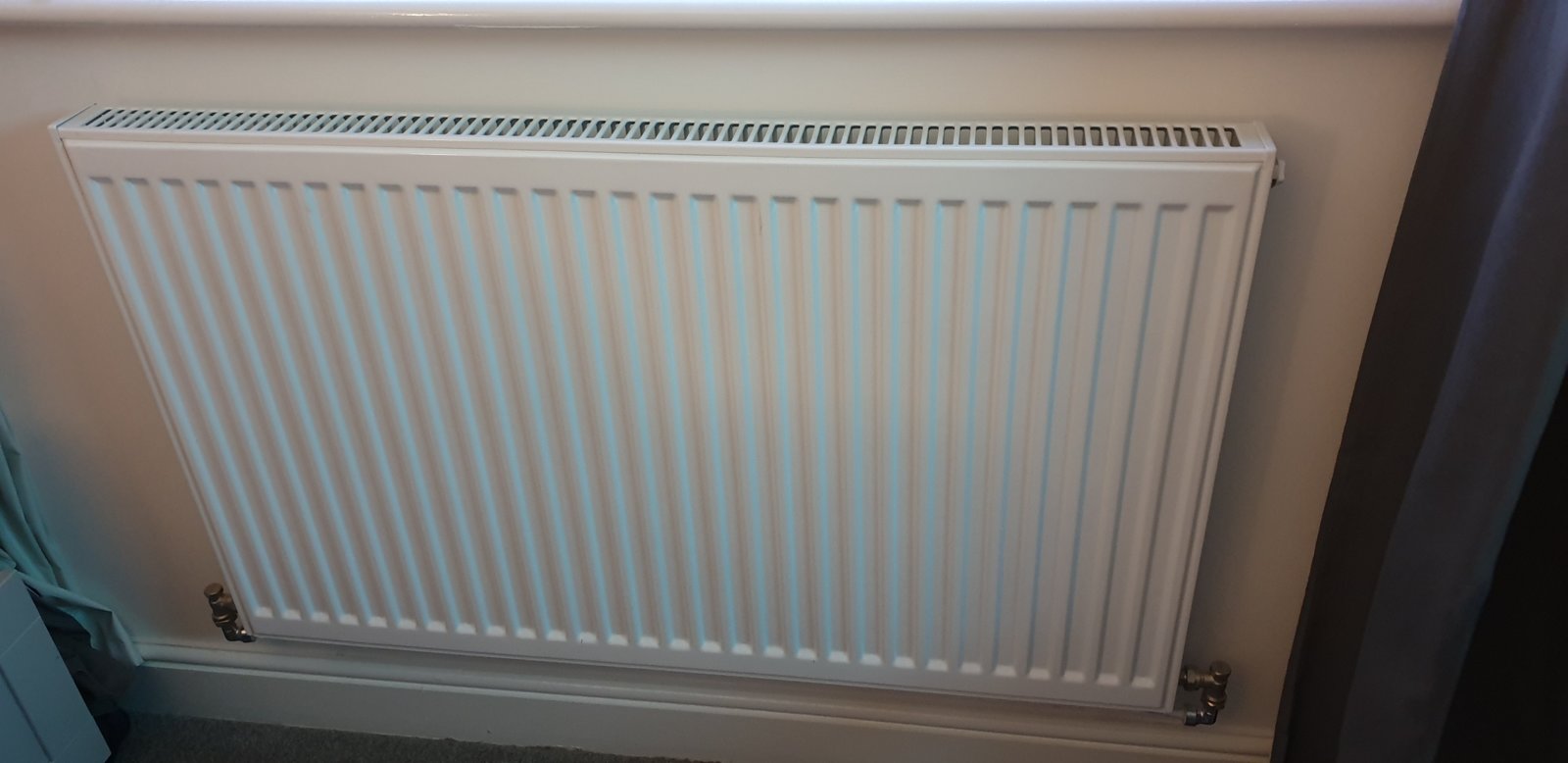

Hi,
I have installed a wireless thermostat upstairs, but this means the main rad in the bedroom doesn't affect the thermostat and the room gets roasting!
Because the old stat was in this room the rad had no TRV on it.. how easy is it for me to fit a TRV to the rad now? I see lots of posts for replacing a TRV but this doesn't have any valves either side?

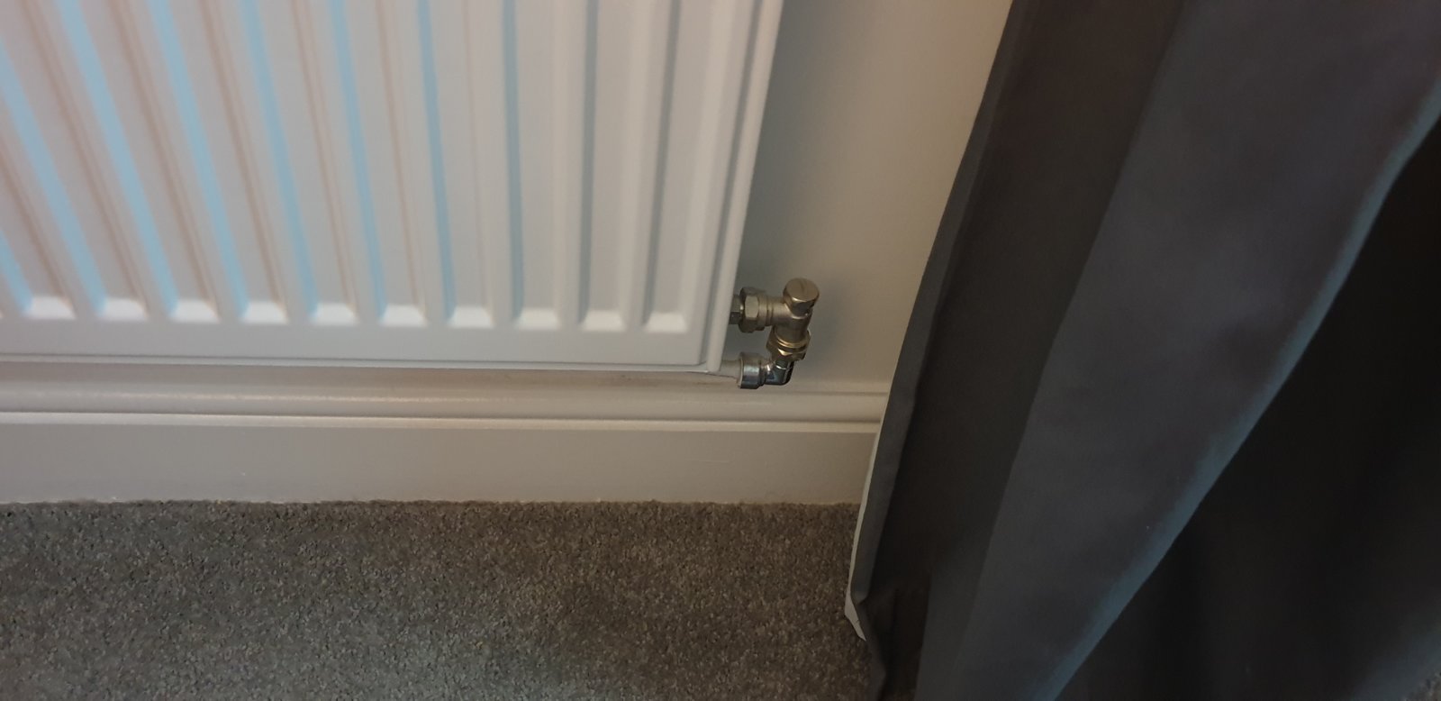

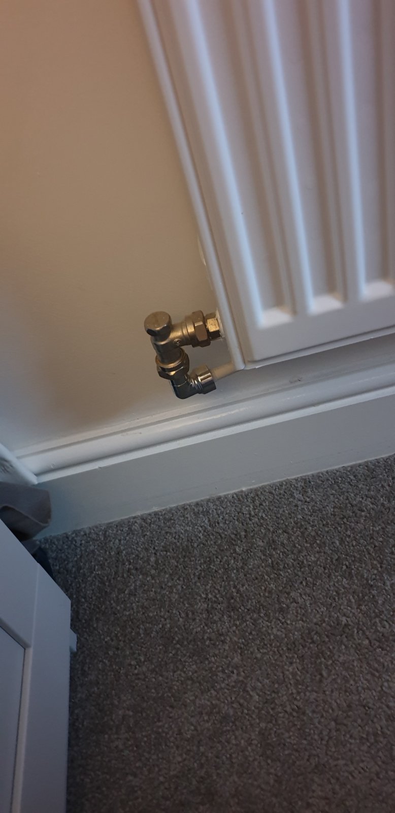

That is two danfoss Lockshield valves, just get a danfoss 15 mm TRV and it will be a straight swap, the cap on the top screws off (no water will come out) and inside there you will see an Allen head you turn that down that is how you close the valve
Thank you Ian!
yep that one will do it, but if that doesnt match the rest of the house then just get the same as the others , just be aware that some boilers need an external by-pass and its common to leave a radiator as yours is as the by-pass, its usually the bathroom one but if you have TRVs on all the other rads you might want to take the lockshield valve that you remove and just swap it with the bathroom valve
Yeah they are all Danfoss.. the bathrooms have towel rads.. the boiler is a potterson promax 33 combi Erp
yes but do the towel rads have TRVs on them or is one the same as the bedroom rad ? your boiler doesnt need an external by pass as it has an internal one inbuilt but never does any harm to have one
Thanks Ian.. yeah both have TRVs on.. so do I need to drain the rads or anything to swap a TRV? I'll take one off the hall rad as they can stay on
I wouldnt just close the end that you are not swapping, remove the pressure at the boiler and have towels down some water will come out as you are doing it but not a lot, you can drain everything if you want, but if you do remember to add inhibitor when re-filling, all depends on how confident you are, its an every day job to us and we dont panick when a little bit of water comes out , but as I say if you are more comfortable with it drained down then just do that, but it looks like you have what we call drop feeds, and the system hasnt been fitted properly as you should have drain down lockshields fitted on the ground floor rads, so you wont be able to drain them any way so just take the pressure off and use towels

Can I just take the cap of the valve and screw this on : https://www.screwfix.com/p/danfoss-...-x/5448v#product_additional_details_container
nope that is a kit of two valves the lockshield which you have and the other is the TRV with a decorators cap on it which is removed and the sensor attached
