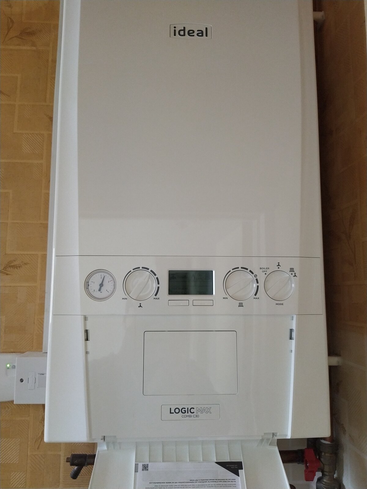

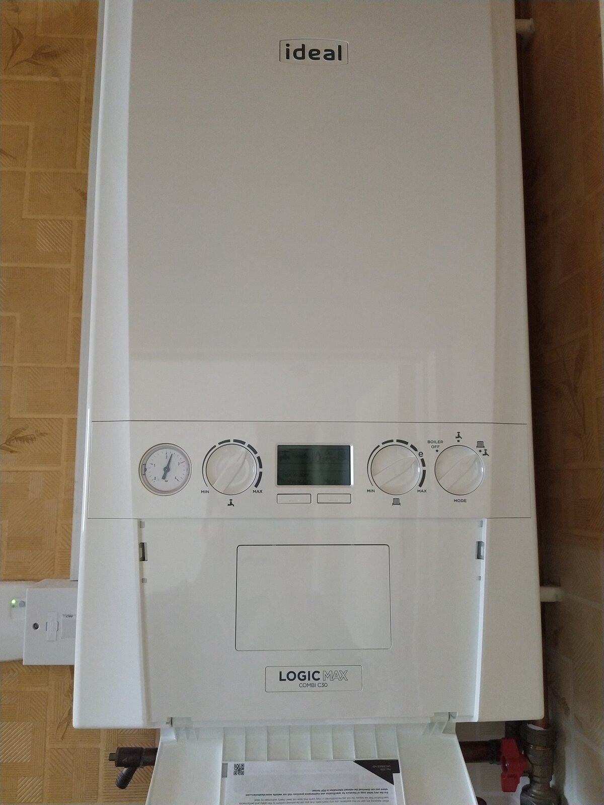

The boiler is an Ideal Logic Max Combi C30 which seems a nice little boiler.

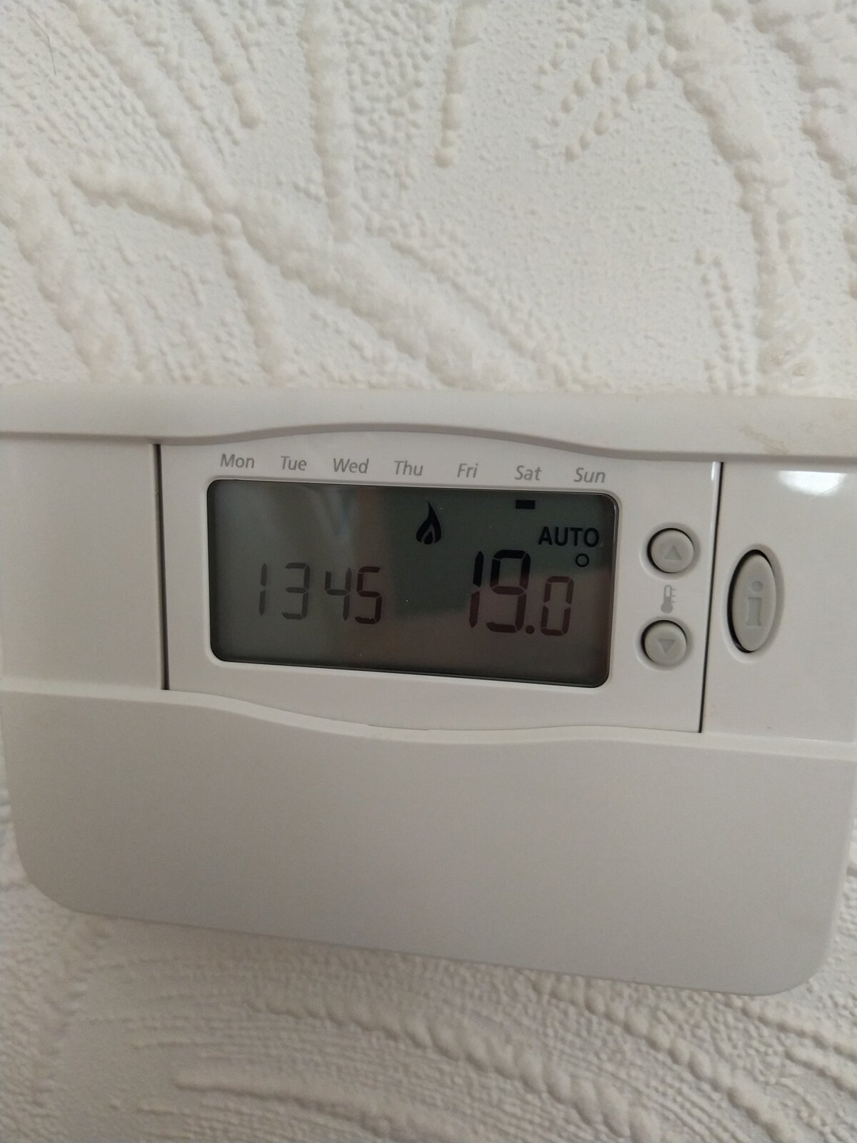

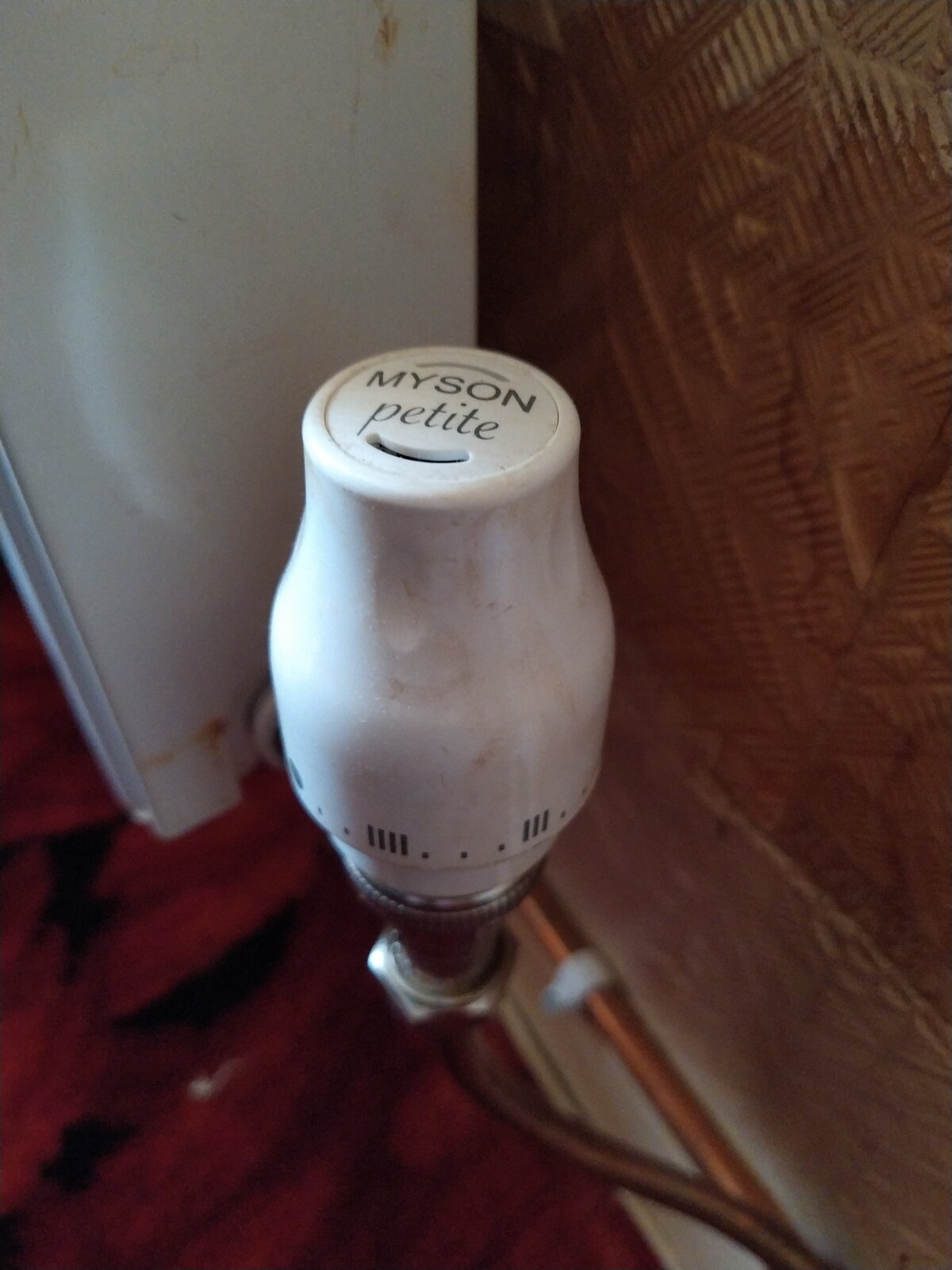

Unfortunately, she has complained with the recent cold weather that she feels cold when sat in her living room and it appears to be because the TRV is shutting the radiator off before the room is comfortably warm enough. The same is happening in her dining room.

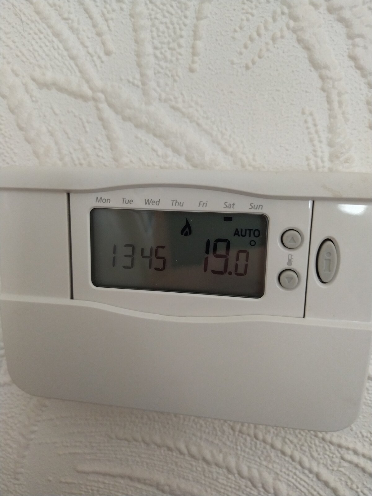

The thermostat is a wireless type which is wall mounted in her large hallway.

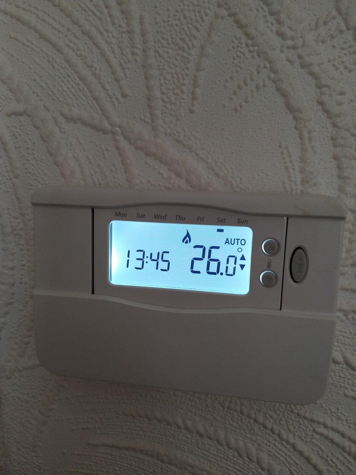

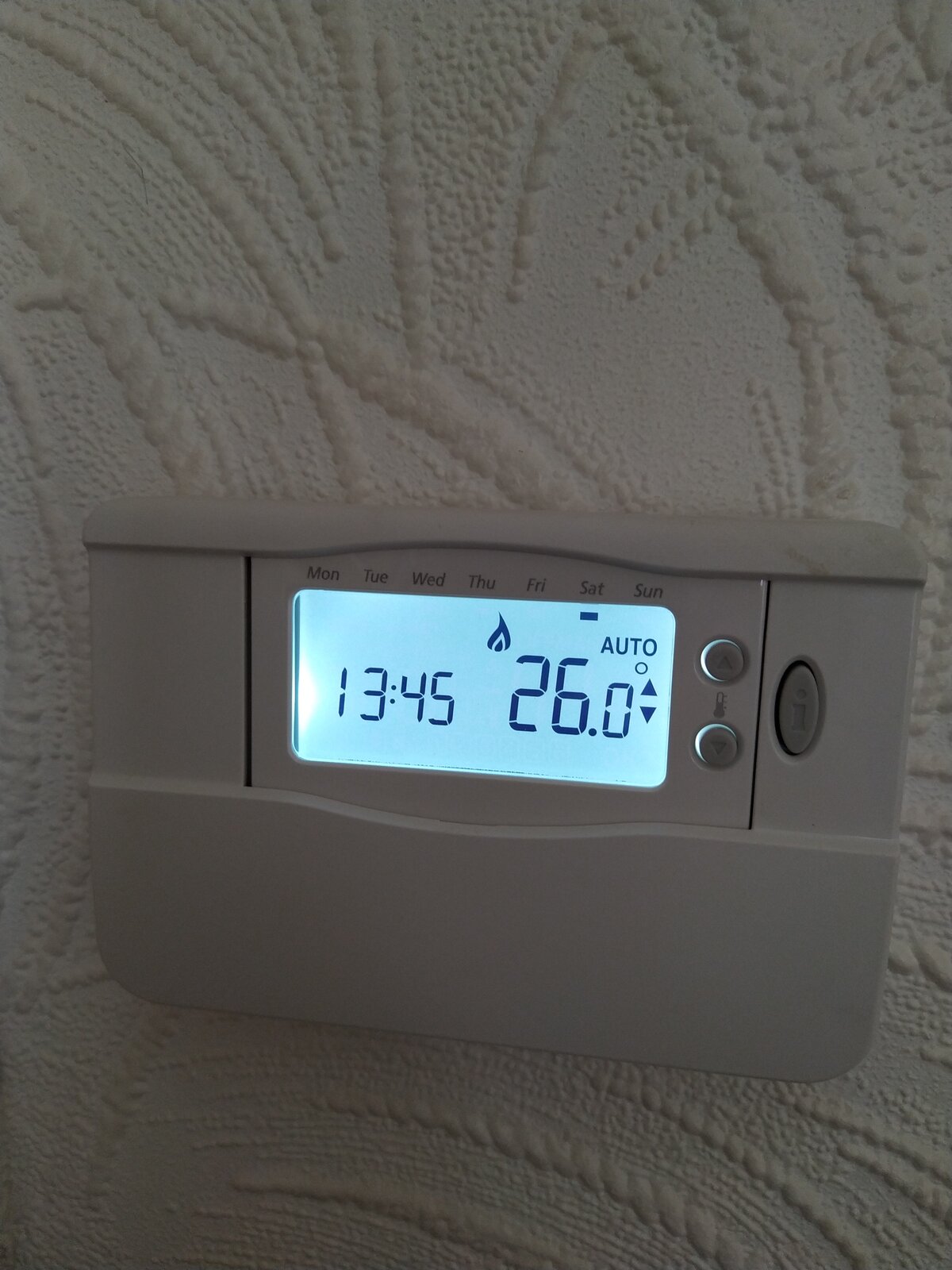

As an example from the other day, the thermostat clearly showed that the temperature in the hallway was 19 degrees while the target temperature was 26 degrees. The heating was running.
However, the radiators in the living room and dining room were mildly warm as if they had been off for about 20 minutes. That leads me to think the TRVs are knocking them off.

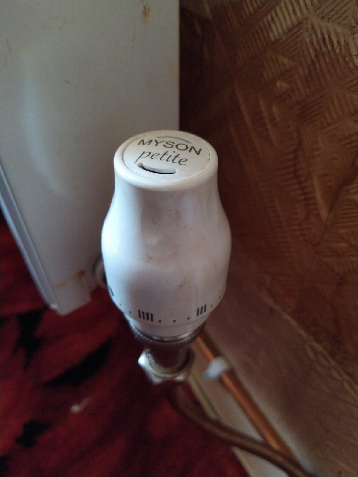

The TRVs are Myson Petite and they are set as high as they will go.
I was wondering if there was anything we could do to temporarily override them or something just until the weather gets warmer so that she is not cold in her home. Or is this something we need to get a professional to sort?

Photos attached for reference, ignore dirty marks on TRV, it is a new system honestly but she is a smoker.

Take the TRV actuator head off completely and see if rad remains at full heat
You could take the heads off, there will be no control but will heat up with no restrictions.
Thanks for responses both.
Does the head just pull off? That's not going to damage it at all and it can be replaced at a later time?
Unscrews with the big chrome nut just below the white plastic head . Won't do any harm and can be refitted any time.
