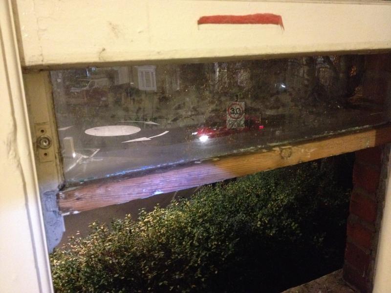

Hi i've just taken on my first property and naturally needs some work doing…
I started off fitting sash locks etc to the windows… and whilst I wish I was making head way, its seems like every job I start develops into more jobs… exponentially!!
The windows have been left for many years, and I'm faced with several jobs that need fixing on each window..
Re-puttying
repainting
replace window sill's
protect timber.
I can't tackle all these jobs right now because of all the other jobs that need tending too… in which case I would like to do something now to hopefully buy myself some time so I can start tackling the windows during the dryer months/ summer.
Can anyone tell me how I can go about this.
Where the wood is bare I've applied a five star timber treatment to hopefully protect the wood from rot etc
Once treated is it worth painting with a primer to offer additional protection which I can then sand down in the summer and then repaint…
Would welcome any suggestions on how I may go about preserving the windows…
Thank you
I'm afraid painting damp wood or in fact even dry wood outdoors in this weather is doomed to failure, by all means put a coat of waterbased primer on but be prepared to sand it all off and let the wood dry out properly in the spring.

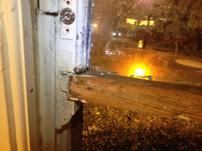

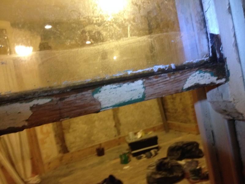

Why not post a couple of pics so you can get some opinions on just how much work is involved in refurbing your windows?
Do a window at a time, remove from frame and board up then you can take your time and do a proper job.
Thanks for the photos.
Yup I would go with foxhole on this one, the only way with shash windows in that state is remove and renovate.
