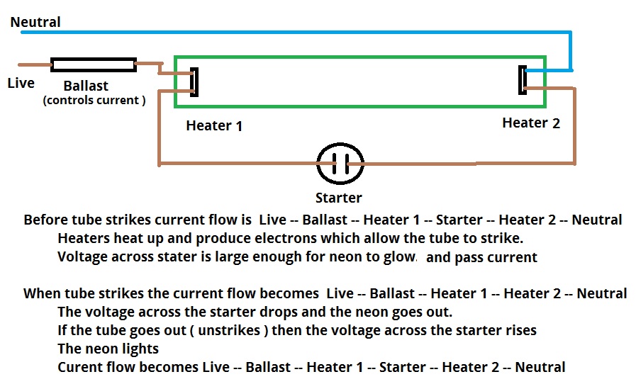

Today I went back with two brand new starters. Again, neither light works. I thought that I'd just give the starter a wee tap (lighting equivalent of "kick it to make it work"). And - dead freaky - the starter GLOWED briefly and then the light came on.
So. Two questions. 1. Is the glowing thing a new thing that starters do? THAT light now does it briefly ever time it's switched on. Or does it mean the whole thing is defective? 2. Anything else worth trying with the original non-working light?

Starters that glow have neon "lamps" inside them, starters that do not glow have electronic circuitry to switch power to the heaters until the tube strikes.
When the tube has struck it becomes very low resistance and the voltage between the heaters at the ends is very small.

Wonderful. Thank you - the glow kinda "looked" normal but I just couldn't find anything out about it at all!

The glowing looks just like the pic halfway down this wiki page, so I think I'm all good on that front!
