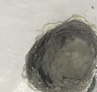

Trying to hang a small lightweight mirror and the drill won’t go deep enough in the wall for me to put a plug in
it’s a solid wall and I’m using a 6mm masonry bit that the hanging kit requests , it’s a small lightweight mirror that needs 2 simple plugs
my drill needs to make a hole 35mm deep but seems to stop at about half

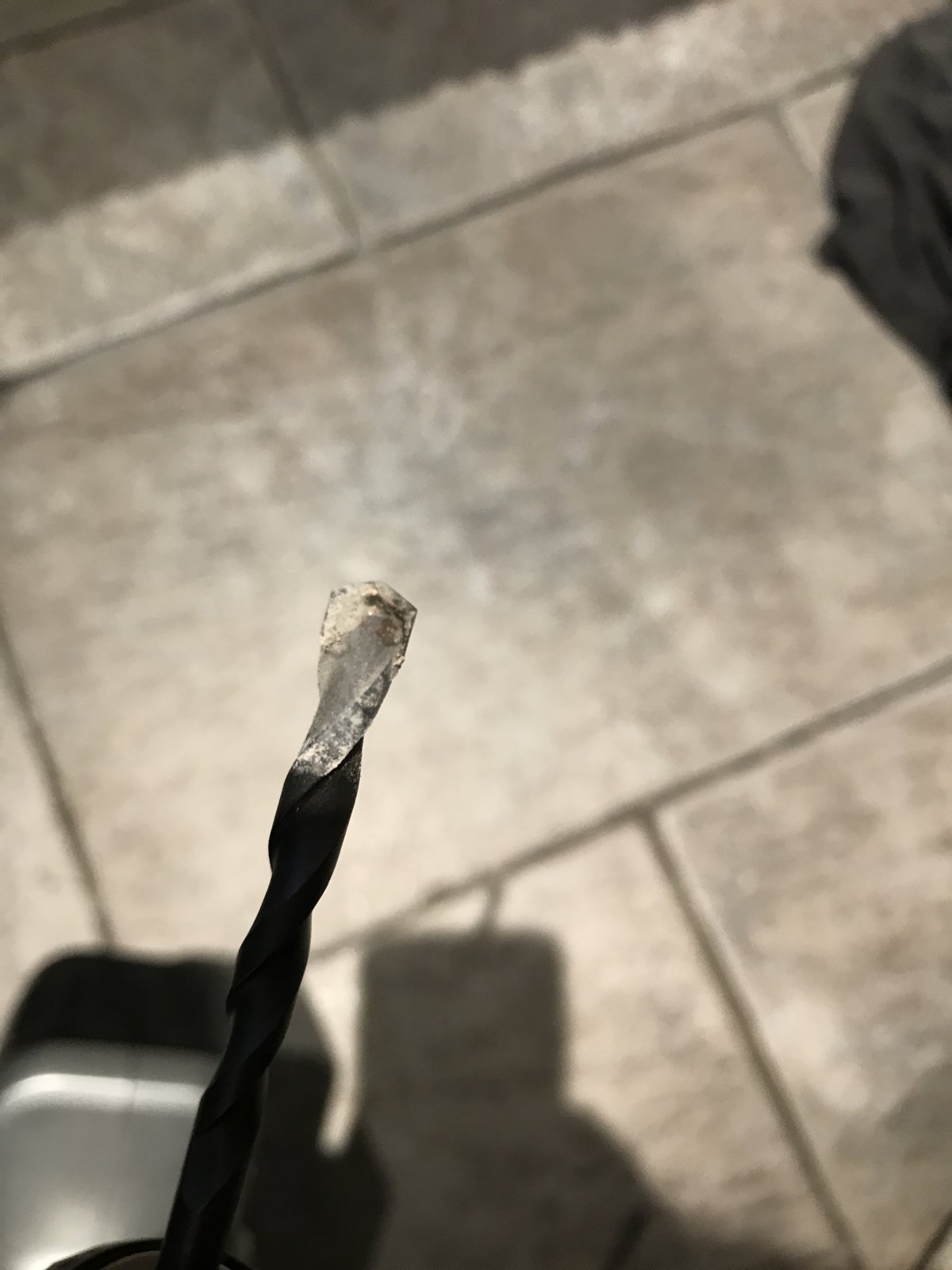

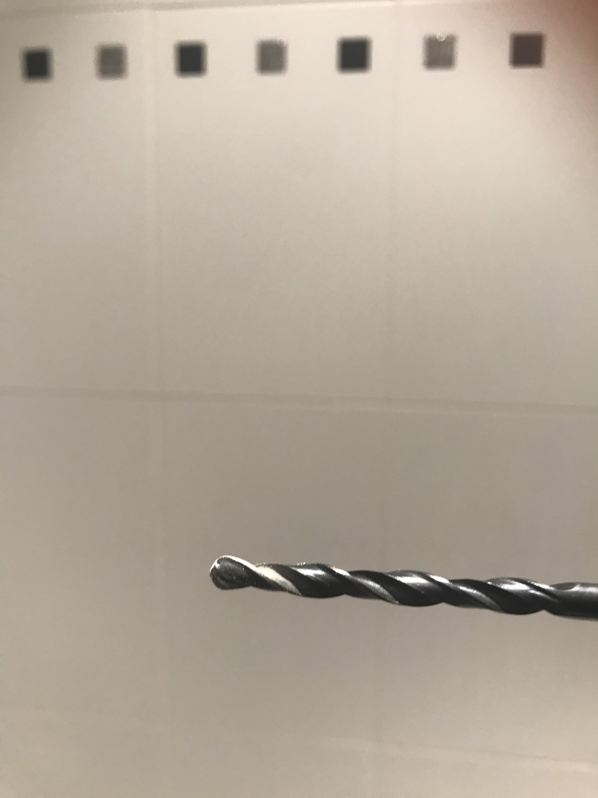

That depth , even though it looks the same as the rest of the wall it feels solid and is stopping the bit

Your problem is that your drill bit is not a masonry bit. It looks to be a wood bit. It will now be blunt. Try a proper masonry bit on hammer setting and you'll fine!
You’ve drilled through the soft plaster and hit the brick.
Get a masonry bit; if your drill doesn’t have a hammer setting it might still work with some persistence, but it might be easier to drill a smaller hole first (with a smaller masonry bit) and then enlarge to the final 6mm.
