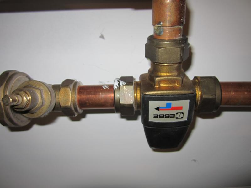

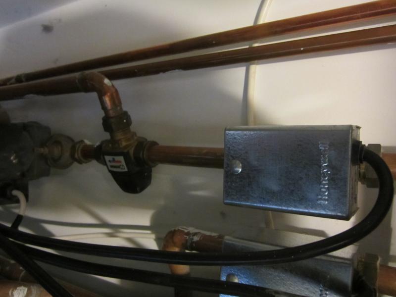

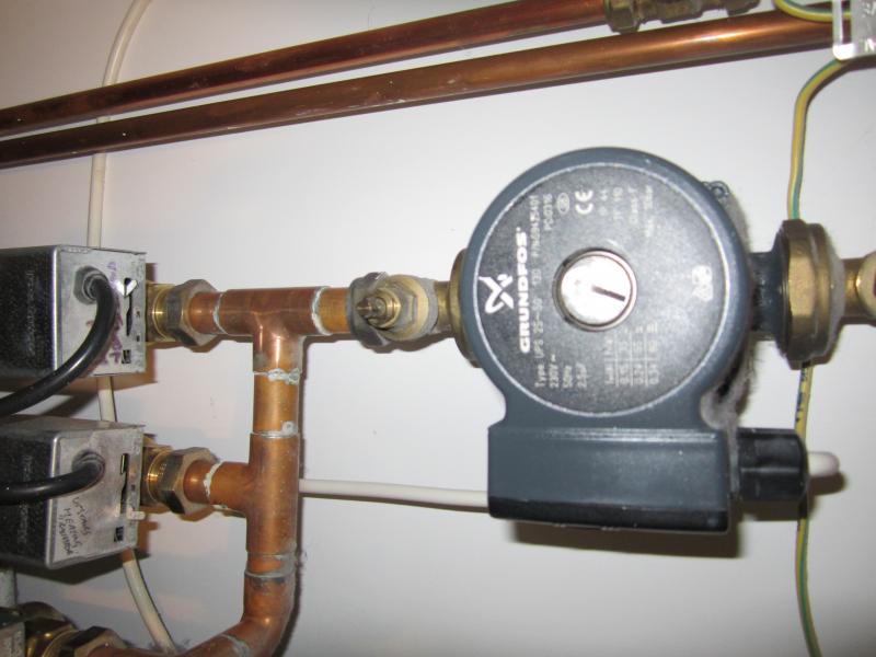

Guys,
I am trying to get an understanding of the components in my UFH system.
Could you correct me on my understanding of the items below?
Thanks.
Doobs.
(Thermostatic Mixing Valve?)
(UFH Pump)
(Manifolds - 22mm or 28mm?!?)
(Motorised Valve)
(No idea - ?!?)
The No Idea pic is an auto bypass valve. The rest are ok, but can't tell size of manifold, although it does look lie 22mm copper is feeding them.
Thank you for clarifying....
This auto bypass valve - does it do what it says on the tin? Allows hot water to automatically go to the other systems?
The pump may not be the ufh pump; it does not seem to be adjacent to the mixing valve.
