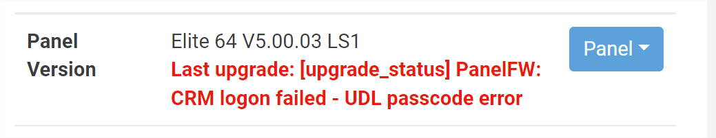

I have a Premier Elite 64 running on V5.00.03 LS1 Firmware and I'm trying to update it to the latest v5.06.00 LS1.
I have access to an Engineers/Installer's Texecom Cloud account, and via that when I goto Site Overview and choose Panel -> Upgrade Firmware, choose the new firmware and go to flash it, it downloads the firmware but then reports the below error message.
Why is it saying this, and what can I do about it? The flashing process doesnt ask for a UDL code.
I therefore assumed that the updater has some default UDL code hardcoded into it, so I changed the UDL code back to 1234 (the default? or is this wrong?) but the process still fails as above.
Anyone got any idea whats going on and how to solve it?
The solution to my problem was I had to physically log in to the keypad using a Master account, this then allowed the Cloud upgrade to continue.
Also, it needs to be a "proper" master account - not sure exactly how to define this but my Master account had been modified to change its permissions slightly - stopping it working, so ensure it has the "right" Master permissions - whatever they may be
The Master user is defined as user 01 that hasn't been changed so that it still sees its self as master and not custom or something else. Technically that isn't the udlpasscode but the error appears to have shown up because user needed to authorise and it couldn't as it didn't meet the set criteria of master user, makes sense why i hadn't seen the issue before.
In the cloud portal you can bypass user authentication if selected.
You are a Star
Changed my 01 User from Custom to Master and as soon as I put the code into my alarm it asked me whether I wished to upgrade . All done running Firmware 6 & Smart Com V4
