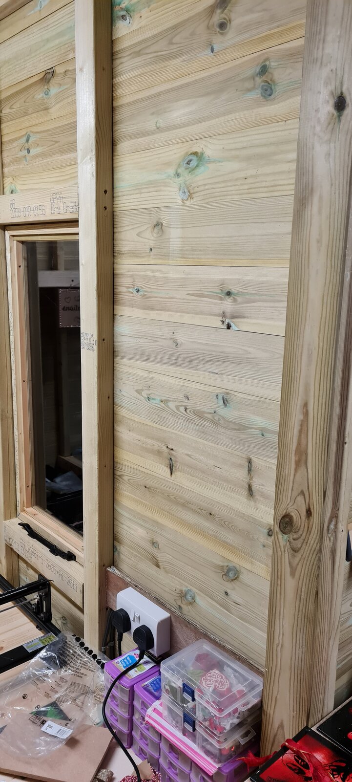

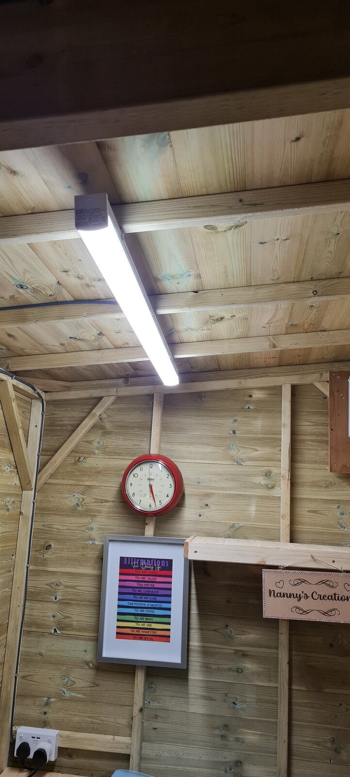

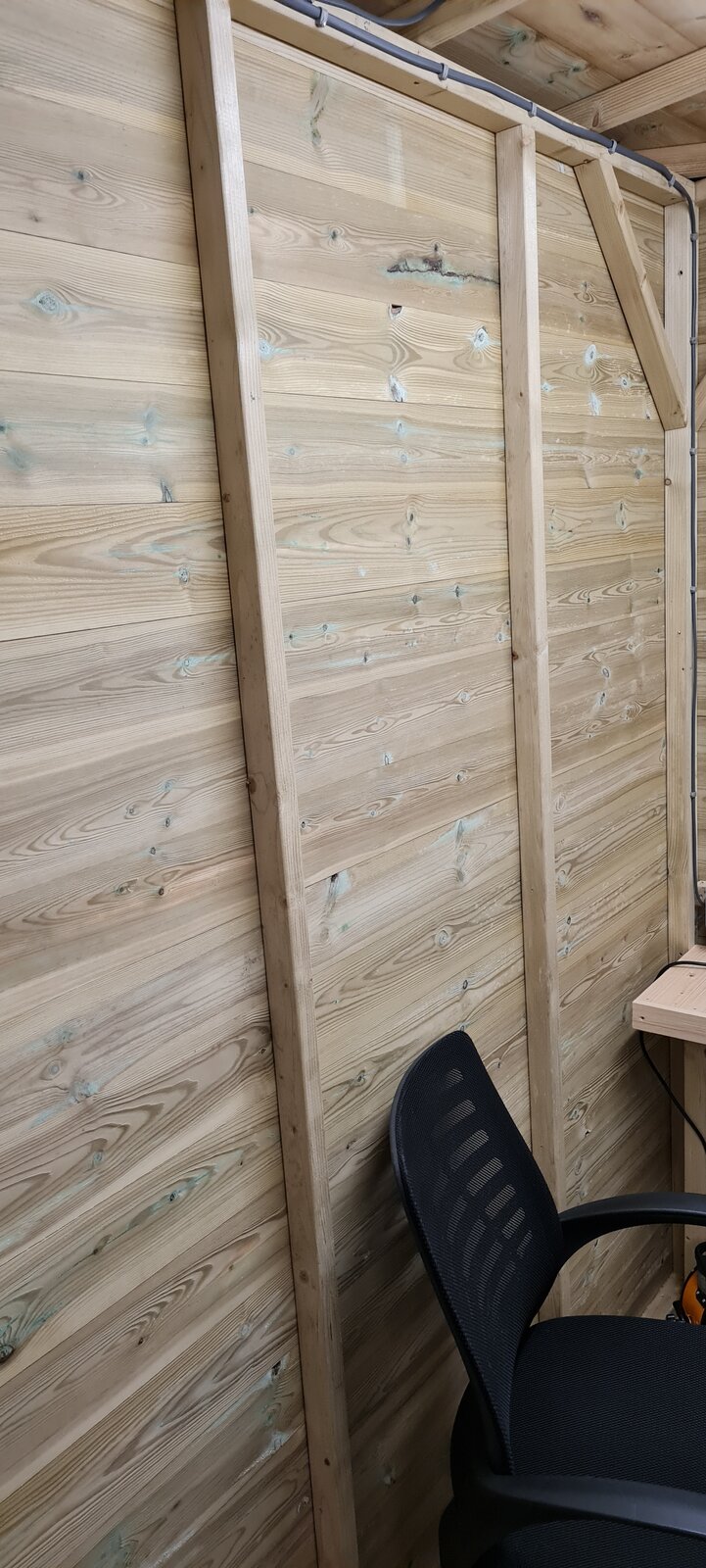

I strongly advise insulating the ceiling and walls, adding a floor, and draughtproofing the door and windows before throwing money away on electricity.
Some photographs, and measurements of the timber studs depth and gap between them, and we can advise how to do it.

The studs are 45mm deep and the gaps vary but the widest is 560mm
I don't think you can get mineral wool as thin as that, so I suggest fixing insulation foam boards to the studs to make an inner wall.
Even 25mm thick will improve insulation dramatically. Thicker is better.
Foam is quite fragile, so overboard it with ply or something, which will not be damaged if you knock it.
I don't know how much you want to spend.
You could line the inside surface of the walls with breathable membrane, to prevent water, insects or draughts getting in, before boarding. The pocket of still air will contribute to insulation.
