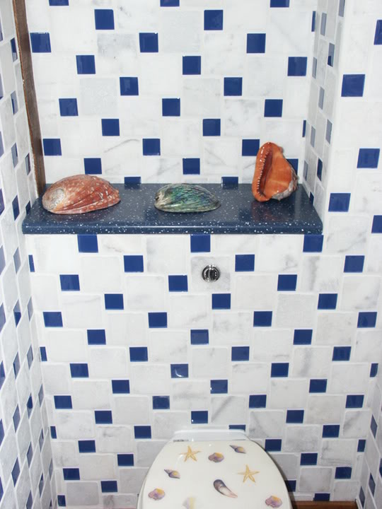

Here's a pic of some 4" marble with 2" glass I did a few months ago, 800 of each in a downstairs loo, drove me mad.
