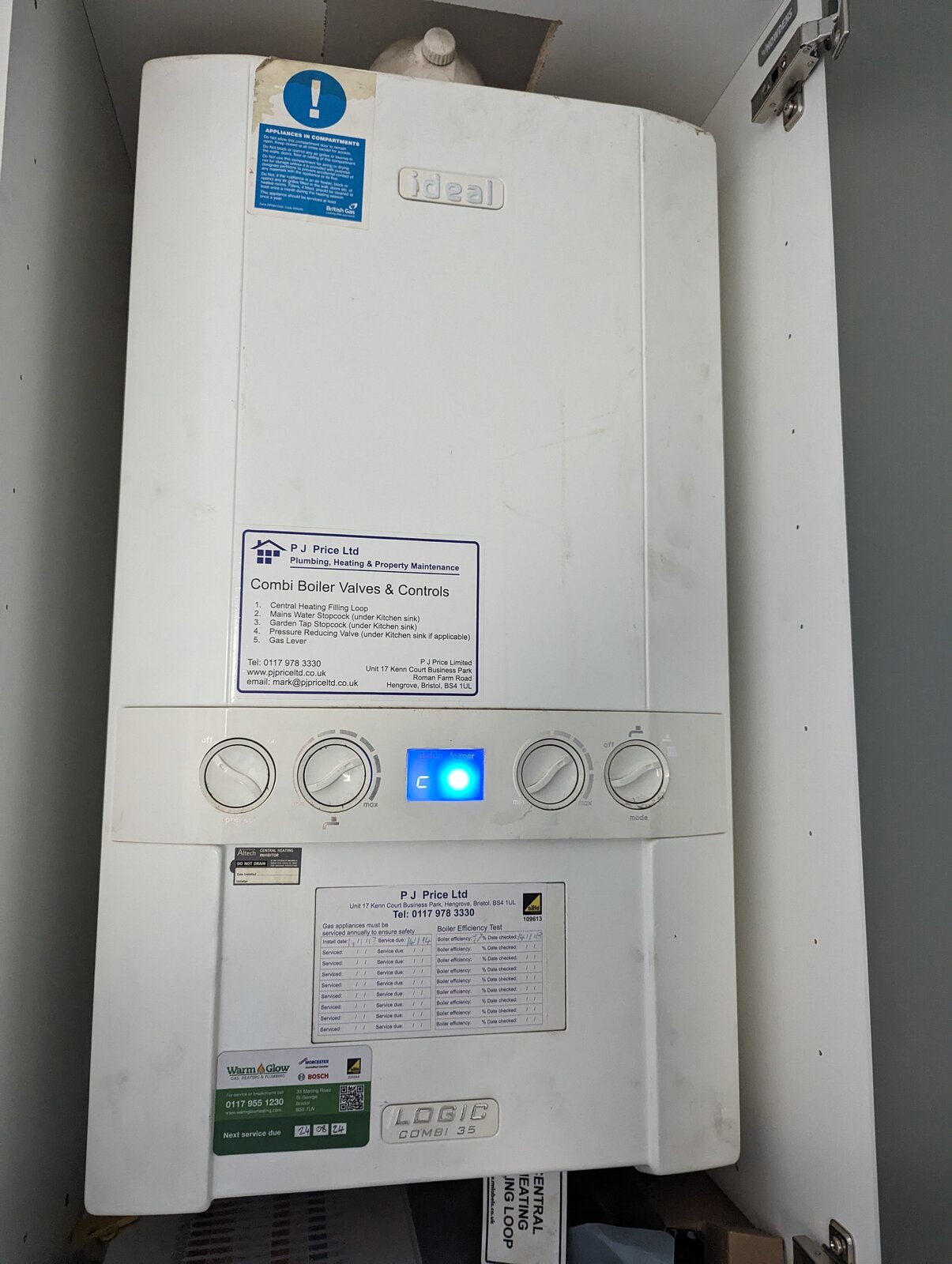

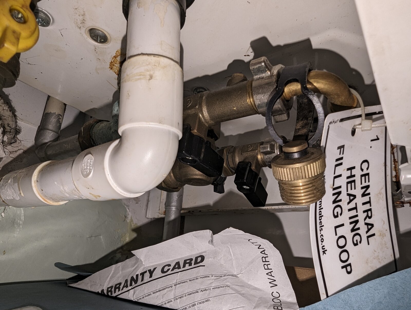

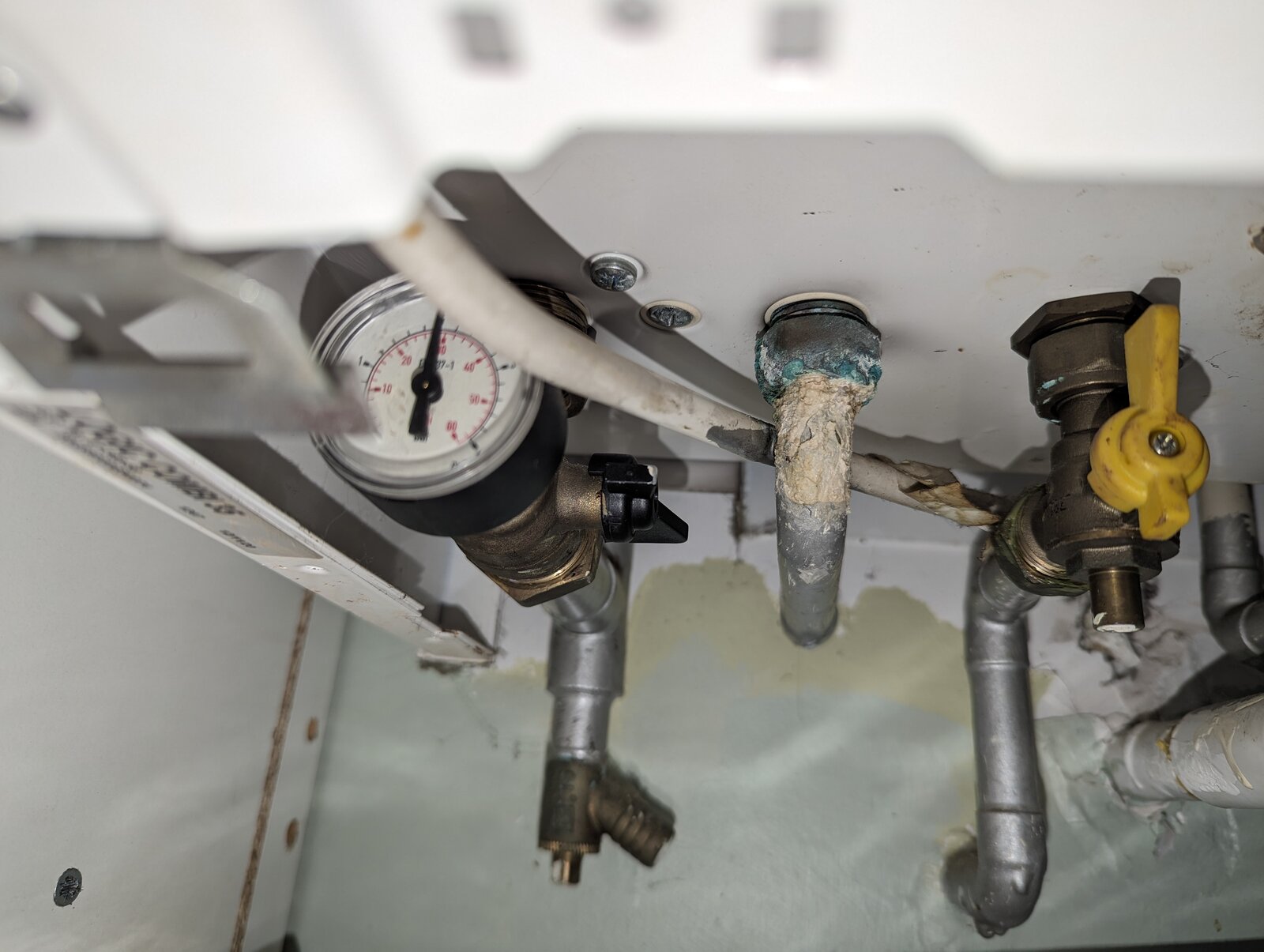

hey all,
we moved into our home in August last year and we got our boiler serviced right away (10 years old) with no faults noted. however when the days started to get cooler we started noticing that our boiler would lose pressure.
we called some folk round and they've not noticed anything jarringly wrong with it, so we've been re-pressurising it ourselves. however yesterday morning i realised id turned the wrong valve/tap and now it seems to have made it not hold any pressure for longer than 10 minutes.
i accidentally turned the tap right next to the pressure gauge and i can't figure out what this is for! i've tried googling, image searching, etc, and no hints as to what it's for, not even in the manual. any help would be appreciated - can we fix this problem ourselves or is this unfixable?
thanks!
The black lever next to the pressure gauge will be the flow isolating valve, it should point vertically, not horizontally.
now it seems to have made it not hold any pressure for longer than 10 minutes. i accidentally turned the tap right next to the pressure gauge
If the gauge is far left and the lever turned was the first one next to it, then that's one of the system valves, that only stop the CH system flowing. Unless that valve it's dripping badly then it wouldn't have any effect on the boiler/system losing pressure. Presume you opened that back up again?
Look outside, below where the flue is, is there a bent copper pipe there and is that dripping water?
pictures, added some pressure this morning. but expecting it to drop.
There's no visible dripping on the boiler. We don't have a copper pipe but we have a vent? yesterday was dripping water but today there is steam.
As per @Madrab - that’s a Heating isolation valve, stops the flow or return. When the heating is on, do you notice if the pressure goes high?
There appears to be damage to the electric cable ,just behind the yellow lever ,or is the picture misleading ?
You have a leak somewhere that needs to be found. Continually adding water into the system to top up pressure is no good for your system.
That is just a ripped label/dust on label residue I believe! And we have had people come round twice now to try and help us with this and they say there's nothing wrong!
