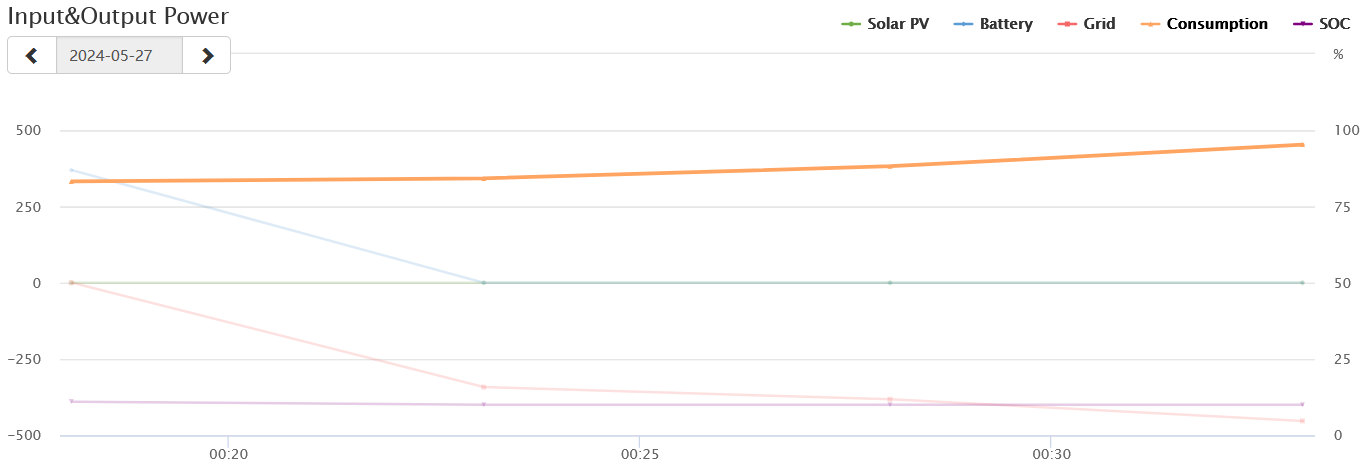

Here is my days consumption, for an idea...
The base minimum consumption, seems to be around 45watts, small peaks, fridges and freezer running.
another thought iff it has fast freeze turn that on overnight and off the rest off the time and that will bank some cold at cheap rate
That does help a little, but more interesting is import from grid
Up to 5 am on cheap rate so that OK, except for a shower and a small spike when making coffee the grid graph is above the 0 so not costing, and today the battery has plenty so likely I will get to 1 am, however I had forgot about auto defrost so only the chest freezer could be put on a timer, job one is measure what the chest freezer uses and see if worth doing.

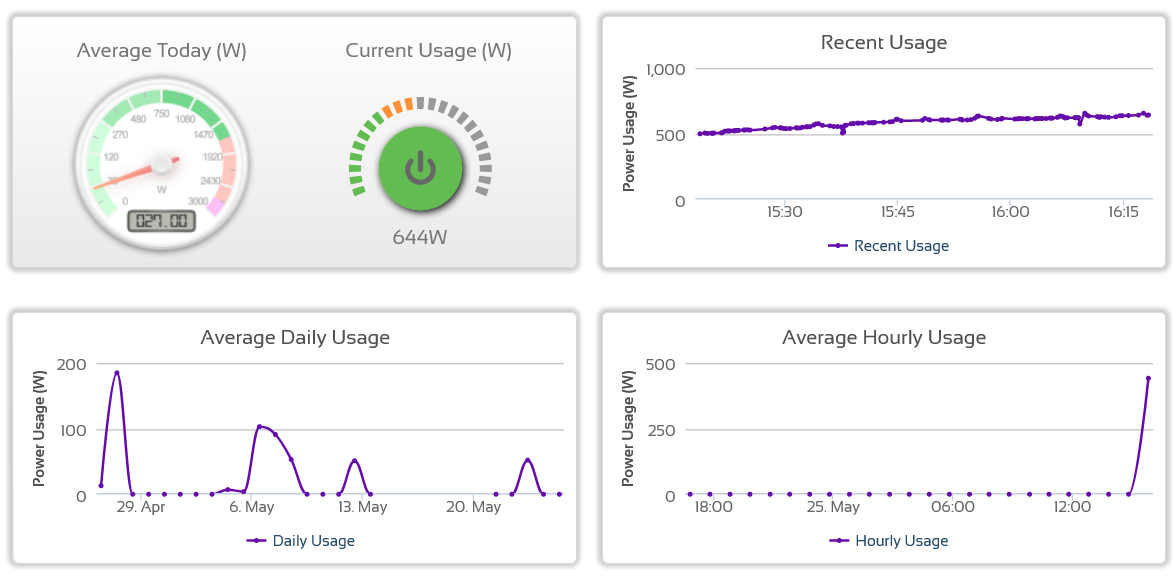

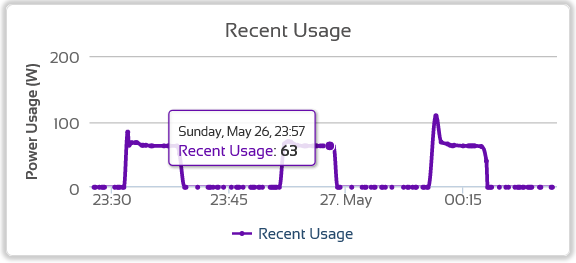

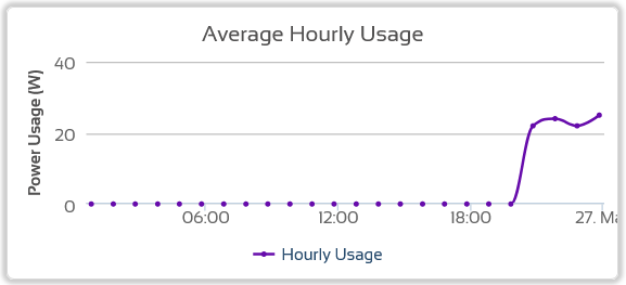

Recent usage 1716766066872.png and average hourly usage 1716766197548.png are showing an average of around 23 watt average, and 63 watt each time the chest freezer turns on.
I looked at the upright, and realised they have auto defrost and how long they can be turned off for would depend where it was in the freeze/defrost cycle, so simply not worth the risk.
At 23 watt average the saving would be minimal, consumption is around 300 watt 1716766659252.png and even with 4 freezers running, that is only around the 100 watt, likely the TV is around 200 watt, and the living room lights 48 watt, so lights and TV would seem to account for a large chunk.
